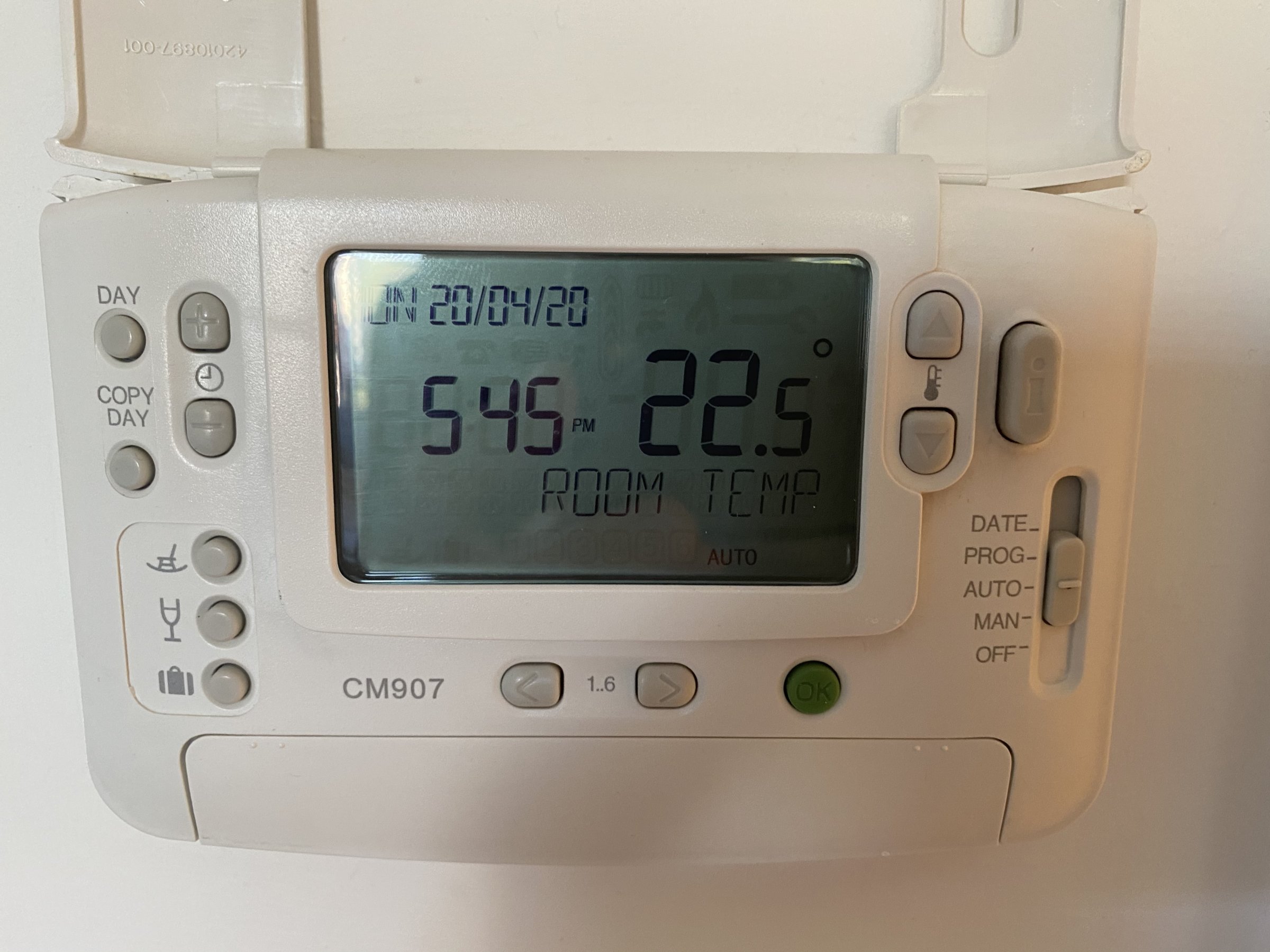

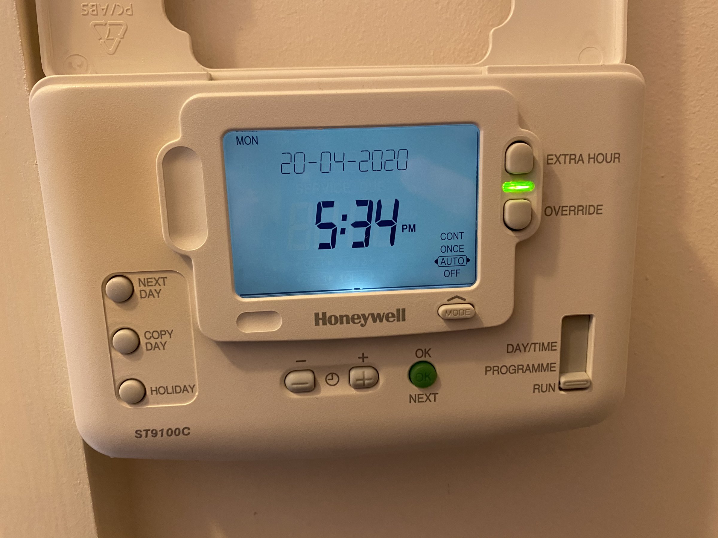

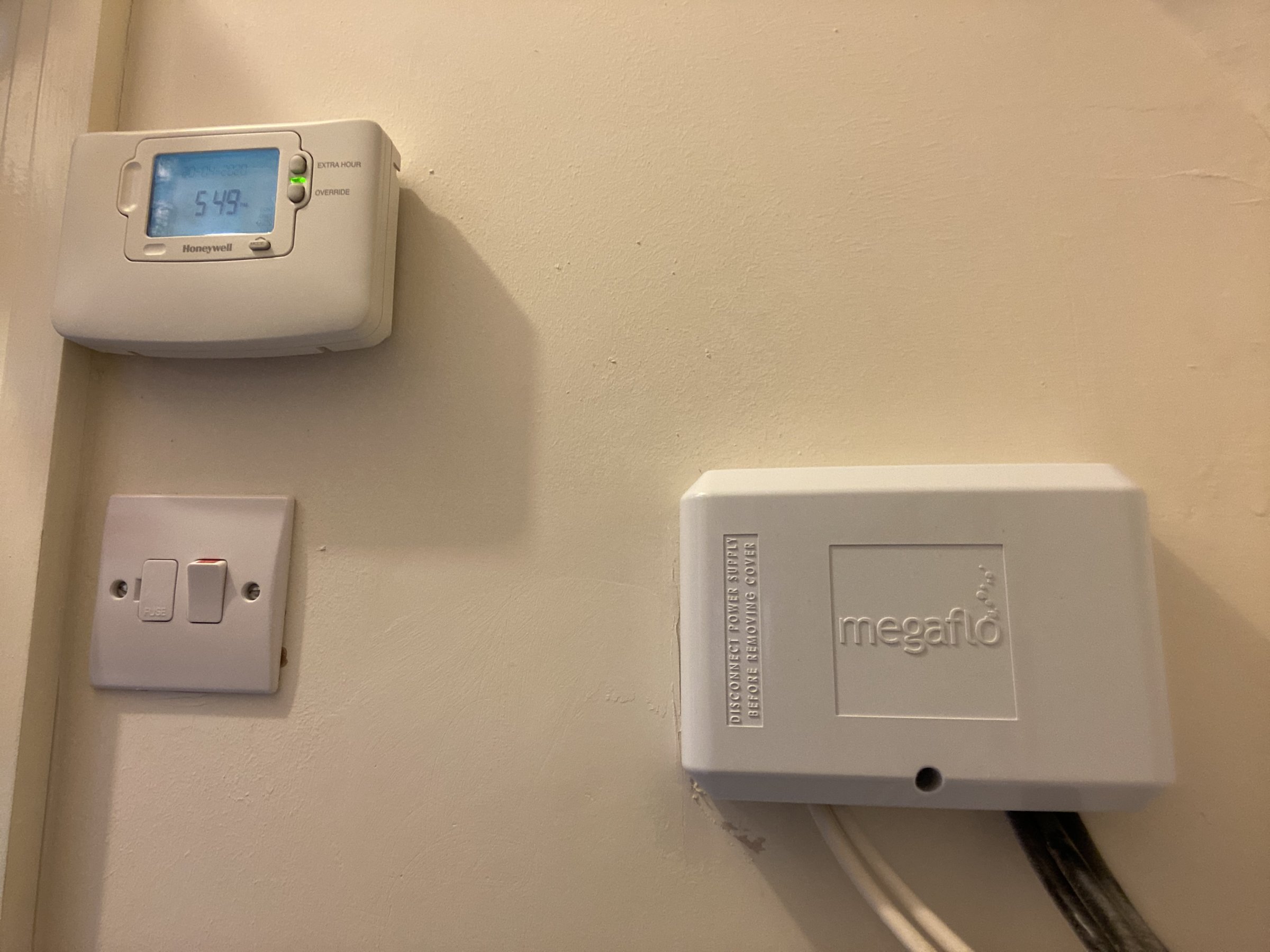

I'm looking to replace my current setup with a Nest solution. At present I have a Potterton Proax 15SL boiler in the kitchen and a hot water tank in the airing cupboard. In the airing cupboard I have a Honeywell ST9100C timer for controlling hot water and overall central heating. I have two Honeywell CM907 timer/thermostats, one on each floor controlling that floor's radiators via powered valves in the airing cupboard. It's a fairly recent install - the house is only 6 years old.

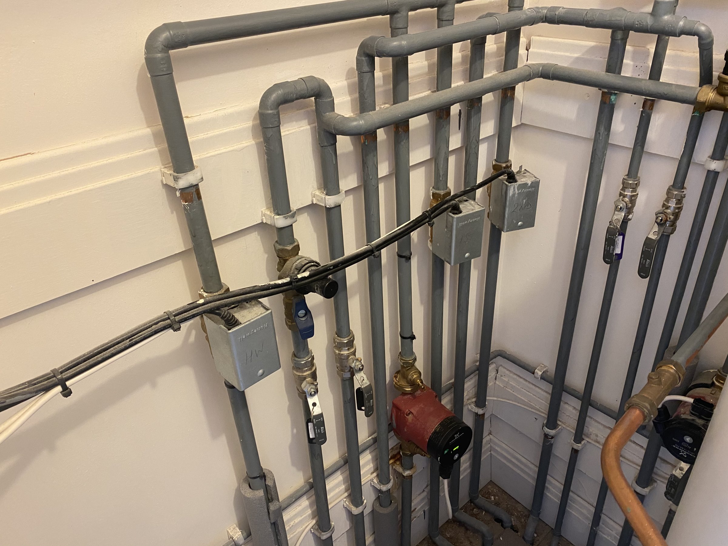

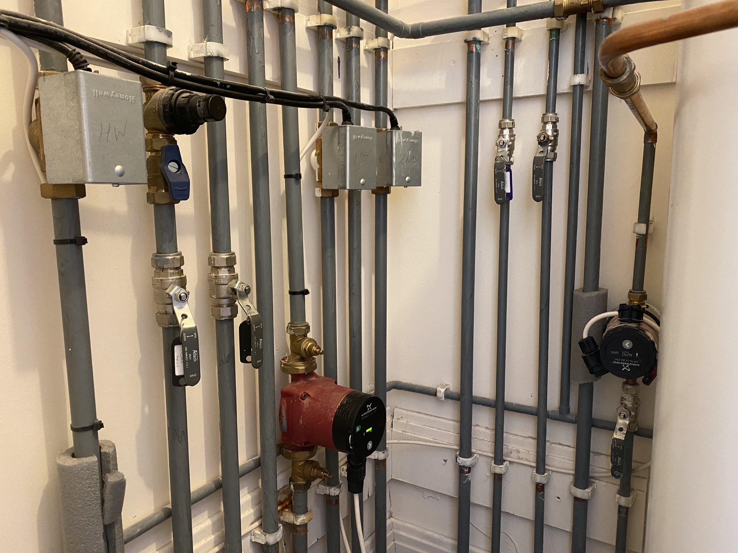

So my question is: I'd like to replace the thermostats with Nest Gen 3's. I presume the existing twin cables going to each thermostat will have to be repurposed as power cables for the Nest thermostats. However, my knowledge runs out at where and how to connect the Heatlink. Again I presume I need two Heatlinks. One per floor, both in the airing cupboard. Do these connect to the powered valves in the airing cupboard (one for each floor marked 1st and 2nd in the photo) but I also have a third valve marked HW. Guess this means hot water but no idea what this valve is controlling. Will one of the Heatlinks control the hot water? Finally there are two pumps. One is for the CH I guess but the second smaller one - no idea. In fact, the previous owner appears to have unplugged it as it's fairly noisy but I haven't noticed anything not working properly as a result. Do these pumps need somehow linking into the Nest system?
I guess it's the two Nest and two Heatlink setup that's confusing me. One will control hot water and one floor's heating and the second just the other floor's heating with no connection to the hot water, right? Or wrong?

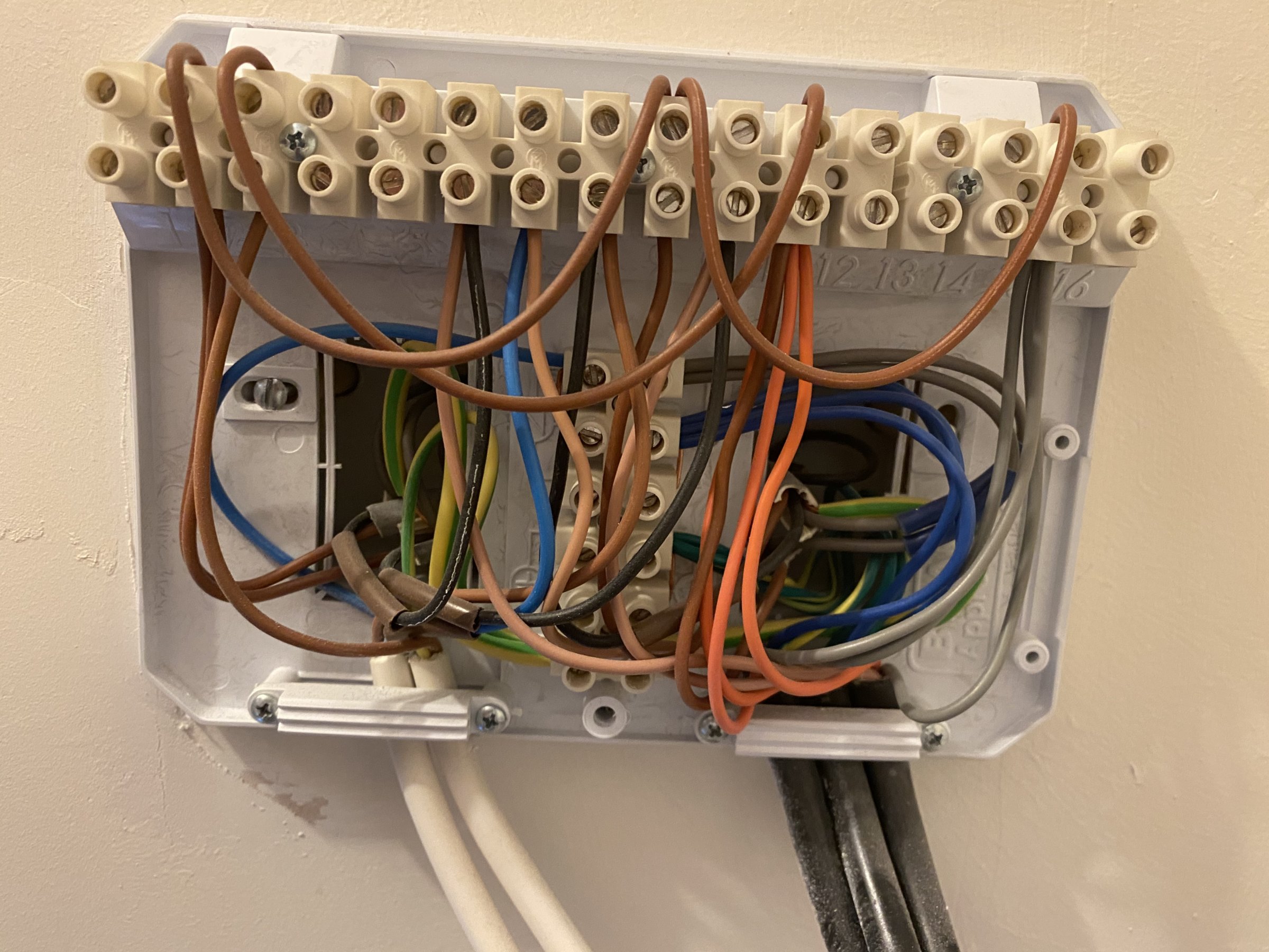

Valves and pumps are connected to a huge junction box in the airing cupboard as shown in the photos.
