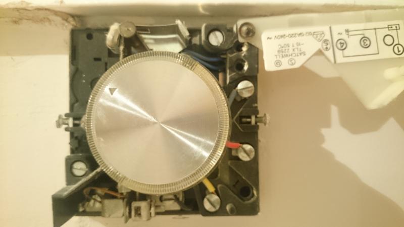

Hi,
I've purchased a Netatmo wireless thermostat to replace satchwell tlx 2259.

My thermostat has three wires and I cant easily identify the oones I need, can anyone help.

Terminal 3 of the TLX 2259 is live; terminal 1 is switched live. These are the control wires
The wire connected to terminal 4 is a Neutral, which is not needed. Make it safe by connecting to a small terminal block hidden behind the new stat.
Thanks, so to confirm from the picture of the existing thermostat I need the yellow and grey wire, it's not very clear which terminal is which.
The image has been rotaed for some reason, the wires are along the bottom. :)
No! you need the yellow and orange wires. The grey (blue?) wire is the neutral which needs to be made safe.
