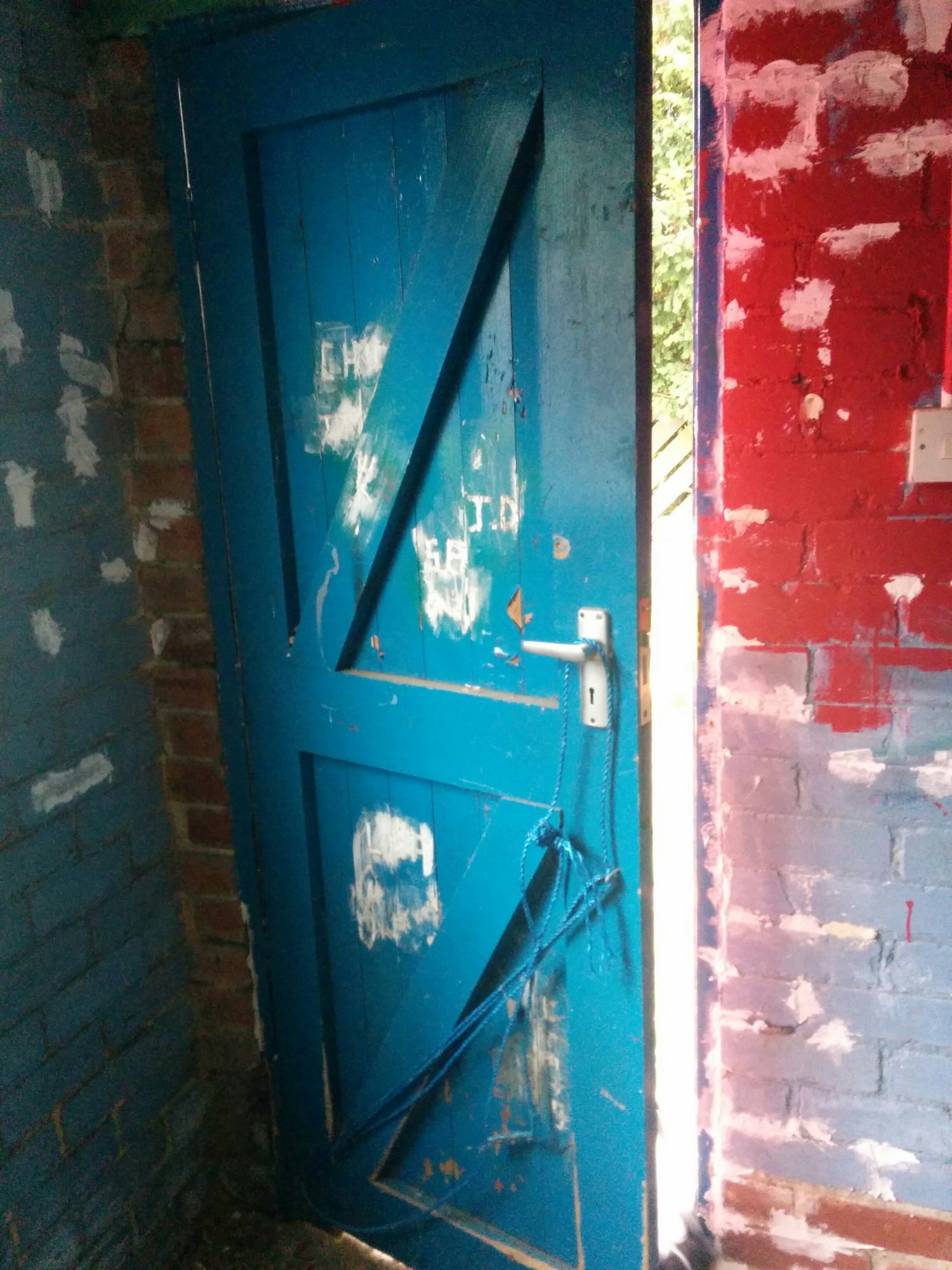

Hi I'm Pacey a DIY fan and just statrting my biggest project yet.
I will keep this a little short as I just wrote a huge essay on my project and circumstance then clicked add media to add some pictures to find my entire text had been deleted on upload....
So yeah, I recently had a child and moved in with my partner and her 6 year old from a previous. It's noisy as hell trying to work from home (Game producer) with the 2 kids and the missus.

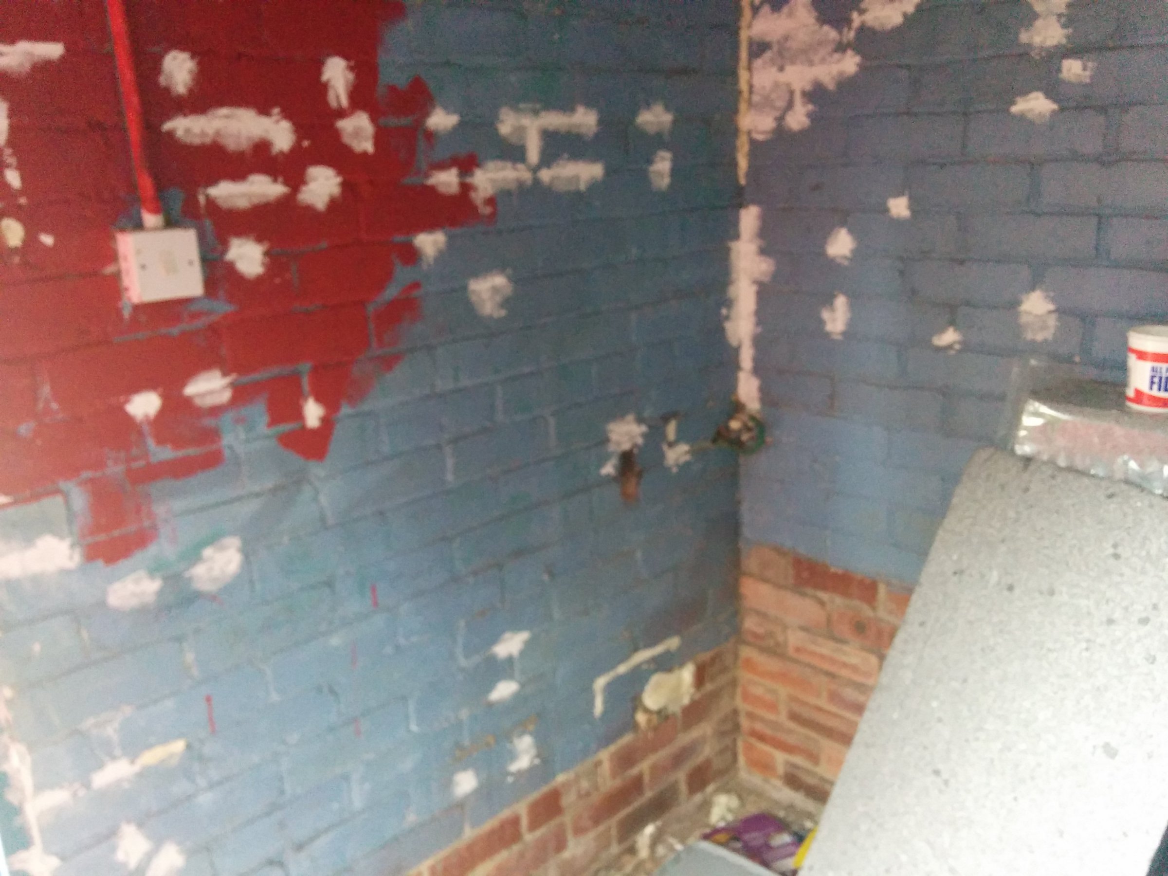

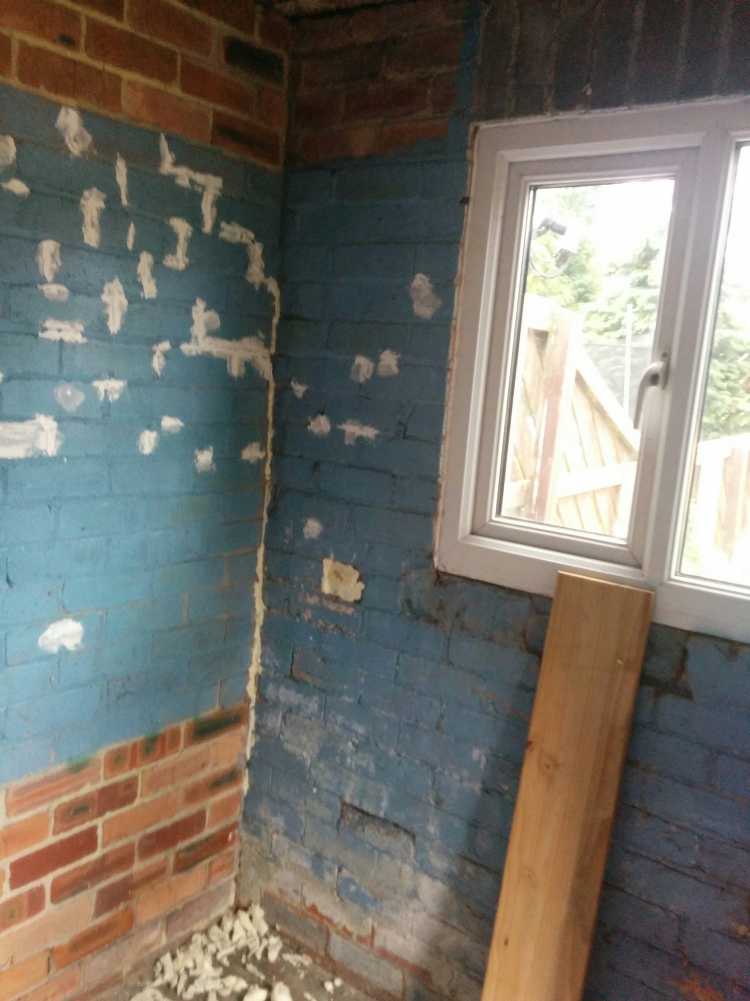

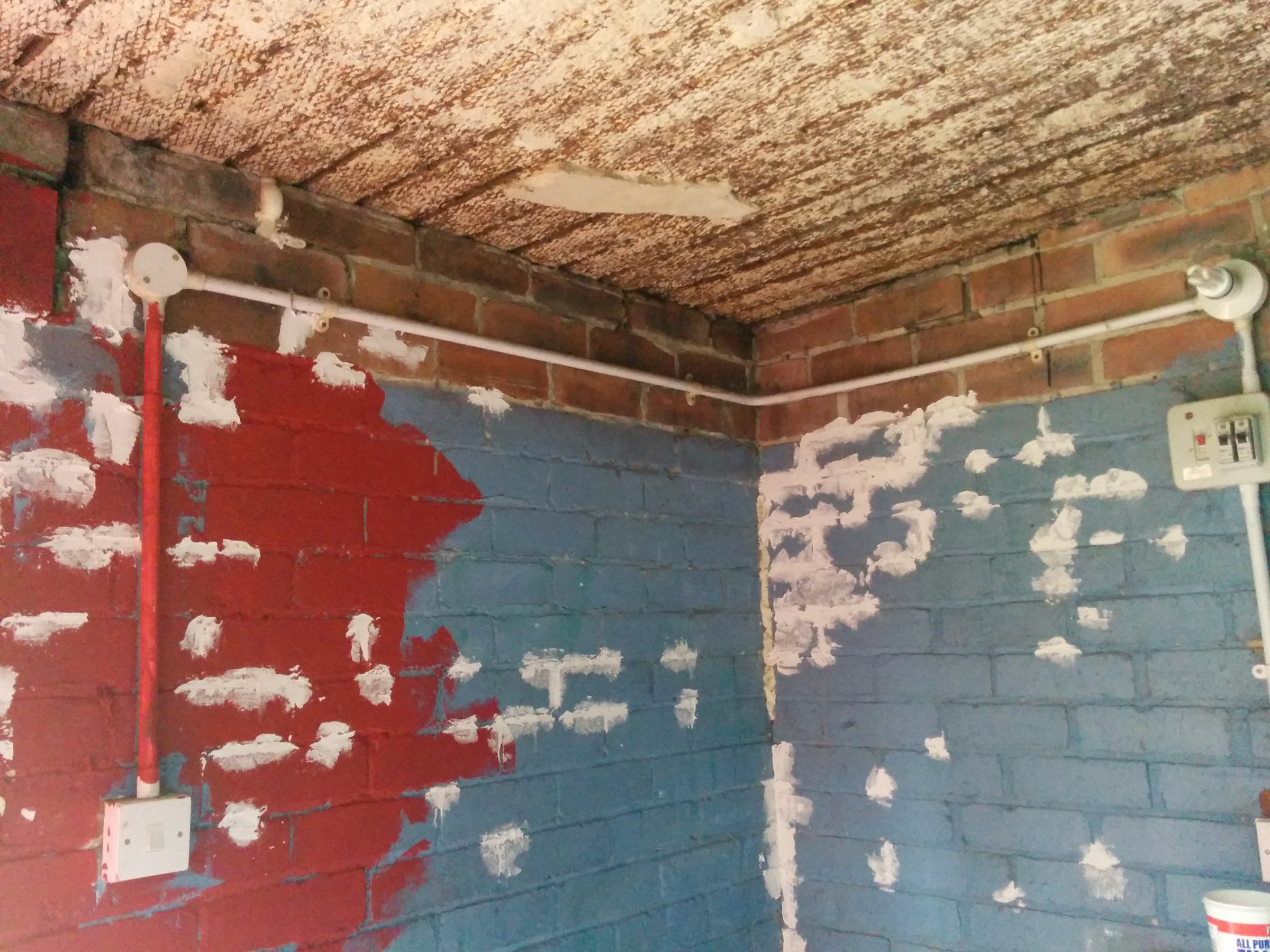

So the project. Brick built outhouse already has electric and lighting but needs a hell of a lot of work.
My to do list:
  • Fully re-do pointing and some brick repair.
  • Roof repairs as felt is missing from one side.
  • Inside wall repair, tons of holes, cracks, half bricks missing and such.
  • Insulation of walls.
  • Plasterboard and possibly wet plaster if taping doesn't look up to scratch.
  • Window frame needs building in to allow the extra depth of insulation and plaster.
  • Door needs insulation and strengthening.
  • Guttering needs some work. Leaning to one side and lots of holes/cracks.
  • The ceiling is one of the biggest issues. It's been plastered but started coming down what looks like years ago. it's through what looks like metal mesh roof supports and it's pretty much impossibly to fully remove and start again. So maybe wet plaster if it will hold. If not just plasterboard on an uneven surface and hope for the best.
  • Flooring needs sorting. it's just concrete now.
  • Then fully decorate and furnish.
I have no formal training. Most of this will simply be done from winging it and youtube videos. Also hopefully some advice on here!
Here's some pics from today.
I'll just start you off.......

For the roof I was just planning on patching up the felt that's already on there. As there's only a few areas that require attention. I also have Thompsons roof seal to then go over the full roof as an extra precaution.
Yeah, it's single skin brickwork. To stop the water I was planning on just fully coating the inside and outside in Thompsons water seal for brickwork.
After repairing the brickwork, roof and guttering and coating them in the water seal the plan was to build in a 25mm (depth) frame against the brickwork and insert the insulation between (25mm Jablite Insulation Board - Already have). Then a vapor barrier over the top and finally plasterboard screwed into the frame and taped up.
Damp proofing the flooring and raising it didn't even cross my mind to be honest. The base of the outhouse is already raised from ground level a good 5 inches in solid concrete. Would you still advise this?
I should also mention the room is only 8ft x 7ft so trying to save as much room as possible. Funds are also lacking with recently moving so it's going to take longer than I would like, as I can only get bits as and when we have spare cash. (Not to mention we are not finished sorting the main house)
But I will post progress reports/images as it happens :)
I am still certainly a novice so if you do see any issues or fault in any of my plan. Please point it out!
