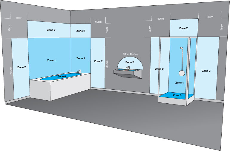

Sorry, your quite right zones 0, 1 & 2

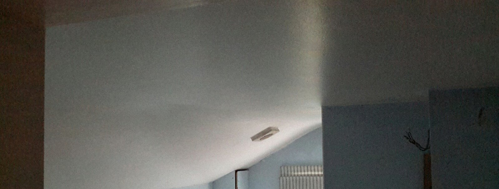

The light is zone 0 rated see attached.
It's even outside of zone 2
Existing cable poorly plastered over and short with multiple joins that are twisted and tapped.
Won't reach without extensive works.

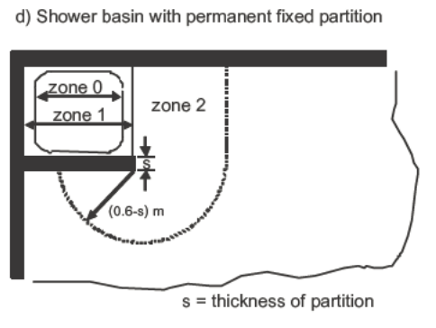

Nor the sides of the shower if they are more than 600mm. and -
there's no zone 2 above zone 1.

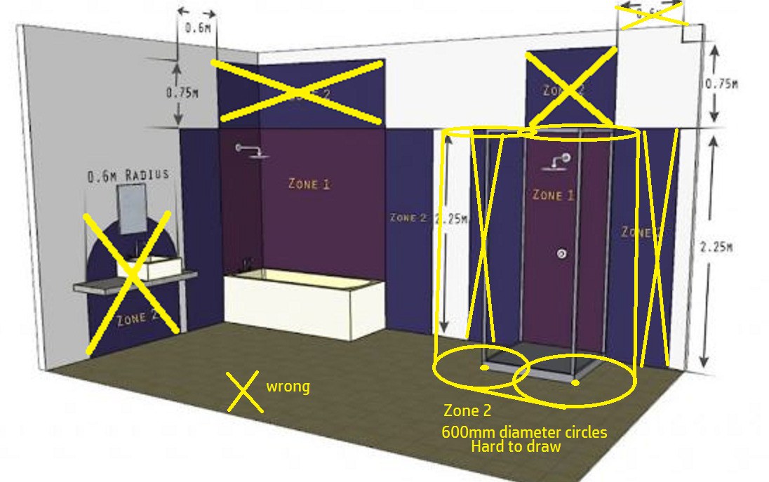

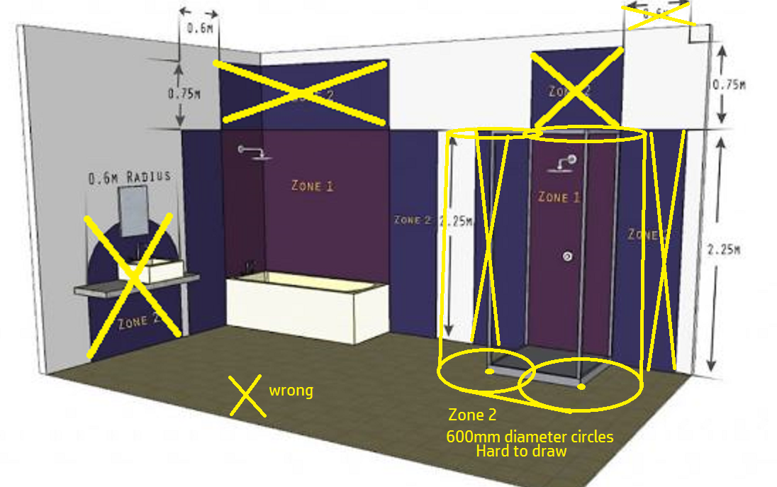

That zone diagram is wrong. There are no zones around a wash basin.
Really appreciate argument against this, I've been hammered by NHBC on this and since spent more on other projects of lights with ip 65/44/20+ certification.
If I can argue this away I'd appreciate that.

Ok. Zone 0 is only IN the bath or IN the shower tray.
It's above a basin
Basins don't count.

I was just correcting the diagram in addition to Winston who I thought was doing the same.
Basins don't count.
Well, yes, that has nothing to do with the zones.
If a light stated by the manufacturer to be suitable then it can go anywhere.
Thanks, thas the diagram I am working to. That's what nhbc refer to. So I am doing the right thing in needing to provide certain lights for the bathroom designs we provide.
