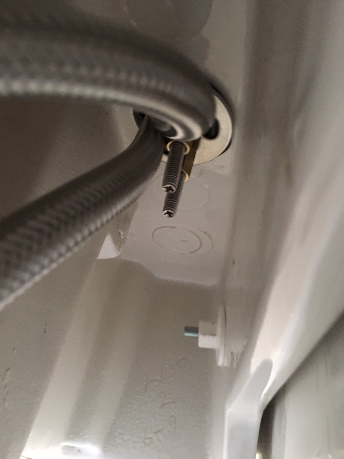

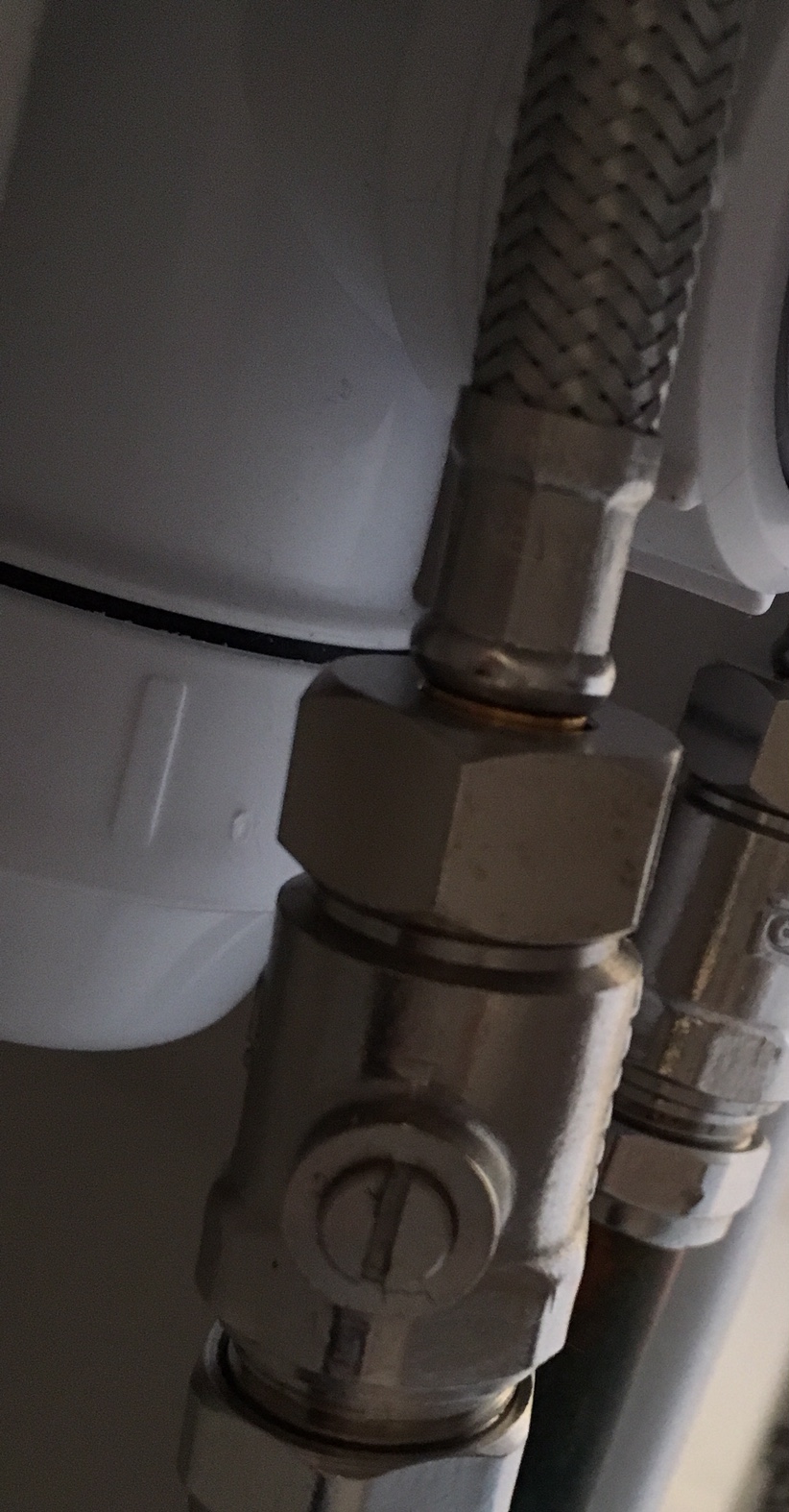

Thanks Terry. I'm a complete novice on this sort of stuff, but I've attached two photos of what I can see from under the sink.

Second pic shows isolator valve. See in the middle there is a screw head slot. When slot us in line with pipe its fully open. When at 90 degree across its fully closed. Put a Flat bladed screwdriver in the slot and turn it so its in between vertical and horizontal (do that to both hot and cold valves) ,see if any difference. Be aware that the flow at the tap spout will be reduced compared to what it was.

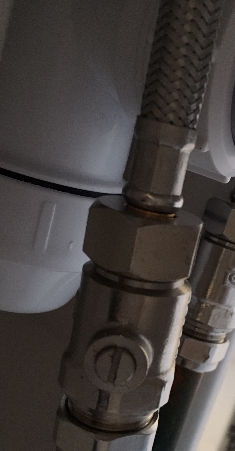

Thanks so much Terry! Should I turn it 90 degrees clockwise or anti-clockwise? Also, just to be 100% sure, is it the pic I've attached here that you're referring to? (I'm almost certain it is, but I don't want to turn the wrong screw!) Thanks again!

Does not usually matter clockwise or anticlockwise. Yes its that pic. Isolation valve ,big silver nut at each end , slot in the middle.

Just to add what Terry said and your comment "90 degrees clockwise or anti-clockwise?".
Turning the screw 90degrees will stop ALL the water, so no need to do that much unless you need to isolate the tap (which is useful to know if you ever need to do this in future).
So you need to turn it say 15degrees so you still get flow but at a reduced rate and hopefully reduced noise.
