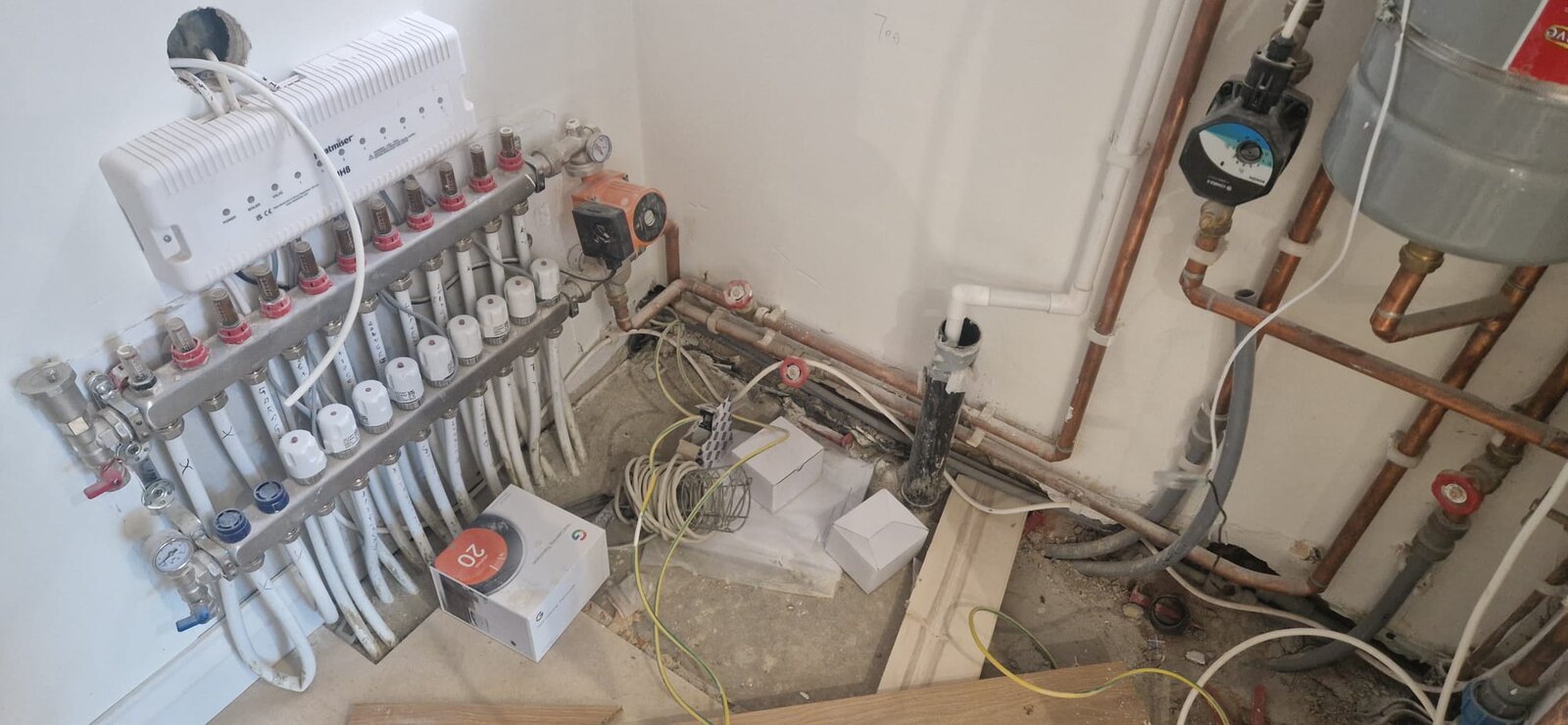

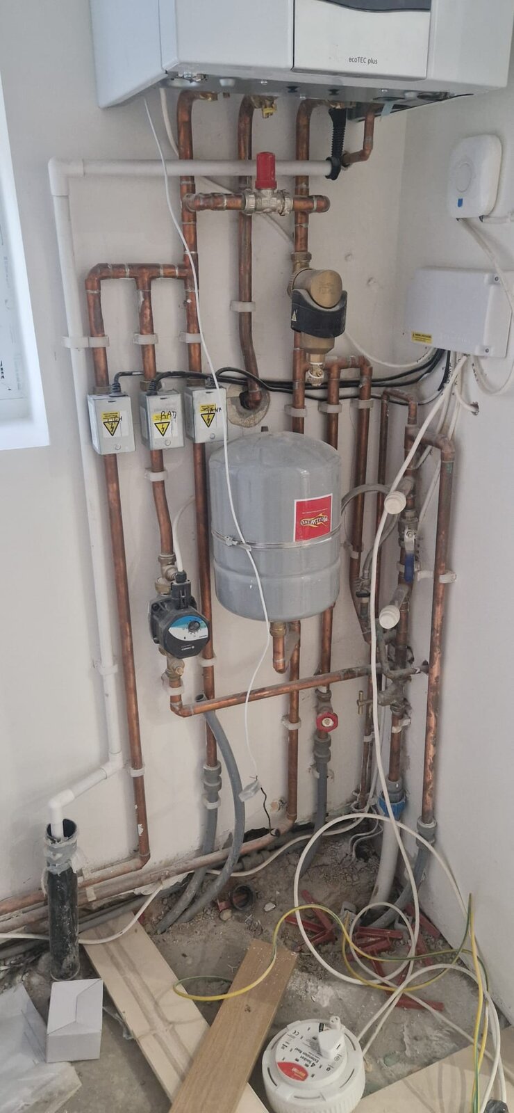

Hi,
I recently got a new boiler installed and wanted to get a second opinion on whether this installation is correct.
Of course the installer was FGAS certified and therefore should be fine, but after going down a rabbit hole and realizing he hasn't added things such as weather/load compensation and left the condensing boiler running permanently at 70C I am not so sure anymore.
One concern I had was that since there are 3 pumps in this system, shouldn't there be some form of hydraulic separation? I can't see where this would be and from what I have read online this would be achieved with either a low loss header or close coupled tees.
Another was that there is a Altecnic ERED Bypass Valve under the boiler which seems to always be open - both sides are hot whenever the CH is running. Is this expected?
I hope I am overthinking it and that all my above concerns are just from my lack of understanding but any advice would be appreciated. The installer of course says everything is fine. (The wiring is not yet cleaned up so please ignore that)

Don't know why you've mentioned F-Gas, that's for air conditioning & heat pumps.
Yes, using Vaillant senso controls for weather or load compensation would be desirable, but are you prepared to pay the thick end of £1000 to add them to your setup? If it wasn't included in the original price, you can't expect it to be included in the installation either.
The two pumps in series are certainly incorrect. It's not unusual to see UFH manifolds connected the way yours have been although CCTs by the manifolds can help with circulation.
The bypass might just be suffering from conduction but it should be checked.

(Also I should have mentioned the boiler is an ecoTec plus 635 system boiler, which seems to be extreme overkill)
The one on the radiator circuit would be unnecessary for most homes - the internal one in the boiler would do the job just fine on its own

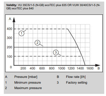

After I posted, I had a look at this chart from the manual. If my maths is correct and I am reading the graph correctly (big if!!!), there is essentially zero residual head at full power of 35kW.
Yes, I'd agree with that, although the chances of this place actually needing 35kW based on what we've seen so far are minimal

That pipe is a spare loop for the UFH. Should he have sealed it off differently? I guess just like the boiler he got a bigger manifold than was required o_O
Yeah, that makes no sense to me, but if you look at my attachment/calcs, it looks like you would have around a residual head of 1.99M (pump at 100% speed), at the boilers rated flowrate of 1305LPH, 21.75LPM, not a lot, but obviously the residual head increases with reducing flow demand as the pump head increses and the HEX pressure loss decreases = greater residual head, for example at a typical flowrate, like mine, of 1000LPH, 16.67LPM, the pump head is 5.71M, Hex loss, 1.56M, residual head a fairly healty 4.15M?.
These boilers are dispatched in (pump) constant pressure mode set to 200mbar, 2.0M, for some reason or other, a fairly modest flow demand of 800LPH, 13.33LPM, Hex loss, 1.0M, residual head (at a 2M constant pressure), 1.0M, not much use. The max constant pressure setting is 400mbar (4.0M) and the minimum, 100mbar, 1.0M, so this mysterious graph seems to have something to do with this.
The second Vaillant graph in my attachment (Residual head) makes perfect sense as my graph (based on a 6M pump, matches it pretty well I thnk.
These boiler pump modes can also be set to fixed speed and temp spread dT mode, I'm assisting someone with 630 boiler which only runs properly in the fixed speed mode.
