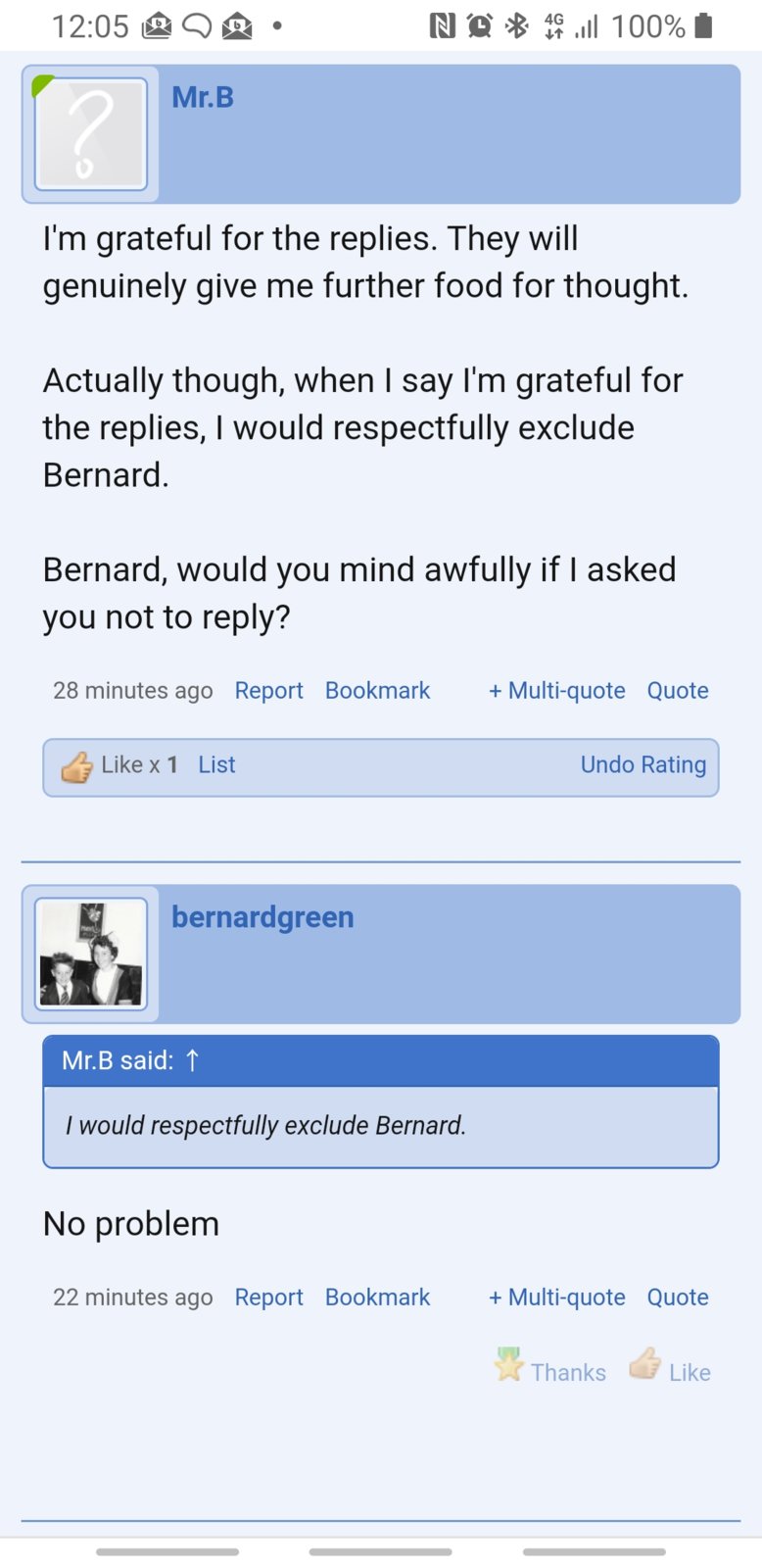

And like whack-a-mole, up he pops! I think I'll just include a screenshot at this point...
