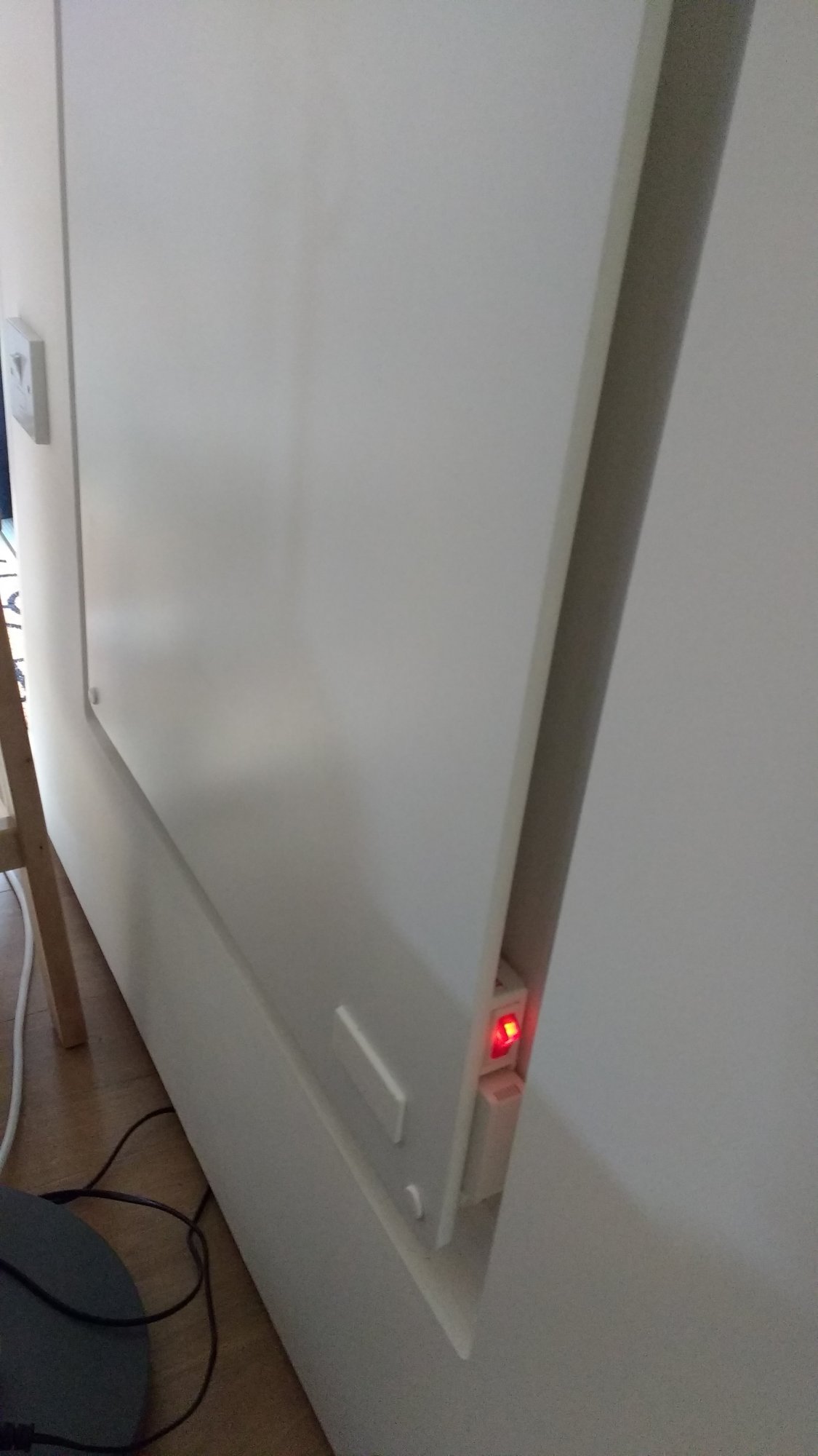

I've bought a new build that followed the 2010 regulations. In the domestic heating compliance guide 2010 it states that a timer and thermostat is needed for all electric heating panels. However, I believe this is just a "guide" so was trying to find out the official requirements. The house as it stands has 4 panel heaters, each with a thermostat, but with no way to turn on/off other than changing the thermostat temperature.....

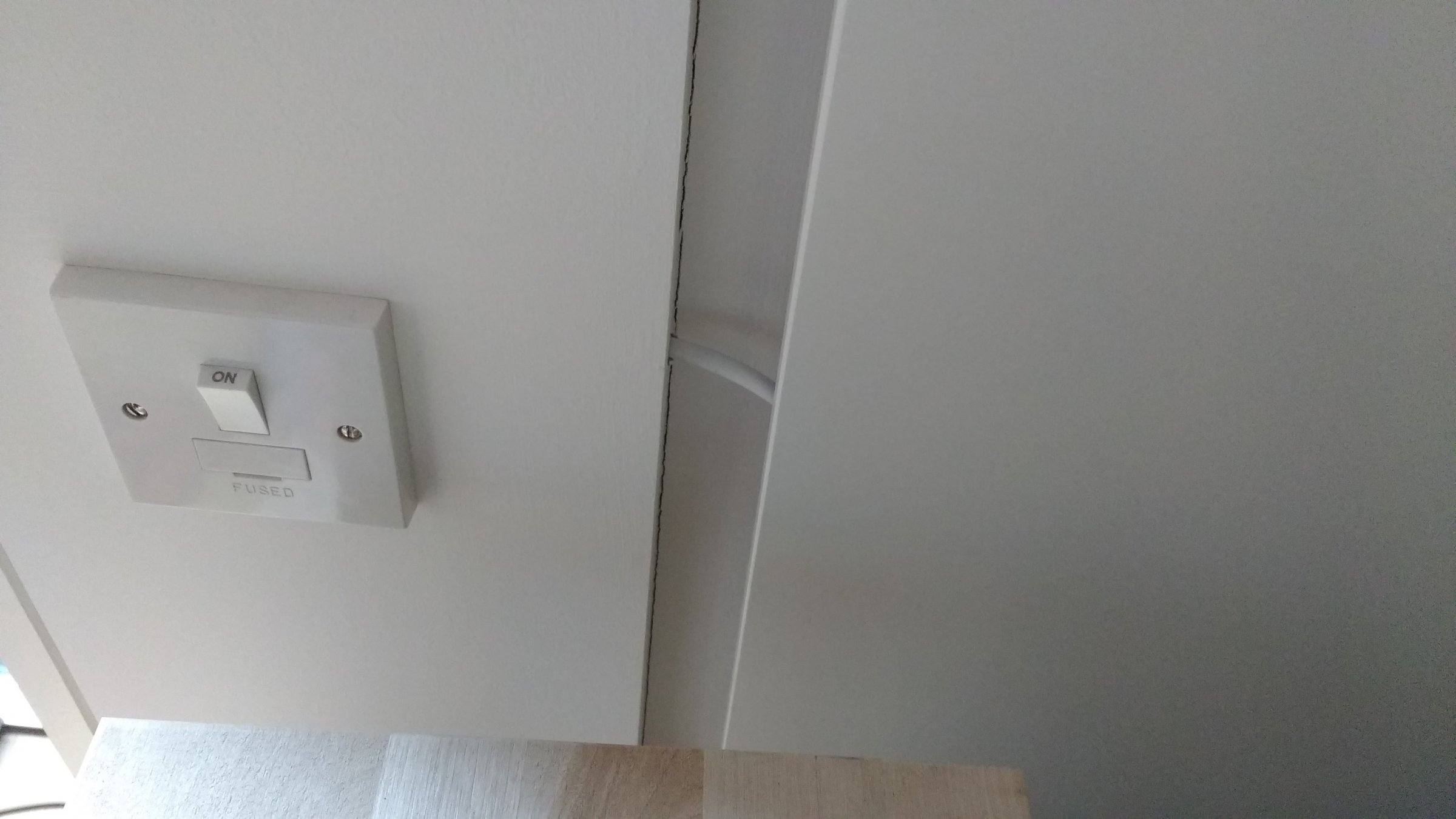

Please show how the flex goes into the wall.

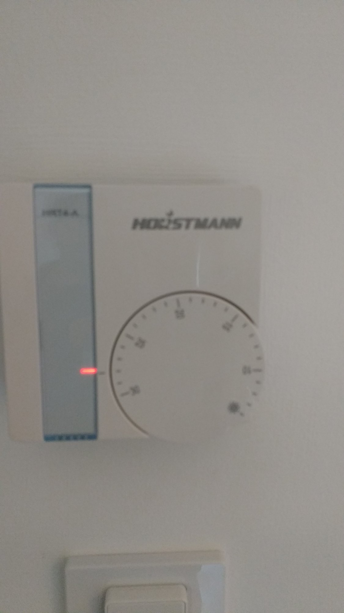

What does that switch in your first photo do then? Sometimes it's better to provide some context as well as specific questions.
Sorry about that. Basically the house has 4 panel heaters (two per floor, one at front, one at back). Each is connected to it's own thermostat. They are all independent. The wall switch is simply on/off for electrical supply to the unit. Each unit also has a little red switch (pictured) that turns on and off. This means I can set temperature or turn it on and off manually. However, there is no way to get them to turn on/off at specific times (so that at night you basically have to leave all the heating on, at a low temperature). Similarly through the day it is left on constantly at a set temperature rather than (what I would take as normal use) turning on before you get back from work.
The Domestic building compliance guide (pdf link) states that electrical panel heaters should have a programmable thermostat or separate time/thermostat. However, I've been led to believe that this is just a "guide" and actually regulations don't require this. I'm trying to get clarification on this point.
