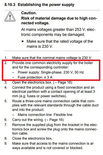

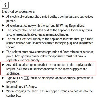

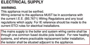

Manufacturers do seem to say must be same supply

Not well written as most homes only have one supply, sure they mean circuit, but it seems only worried about low voltage supply, any extra low voltage supply does not seem to count.

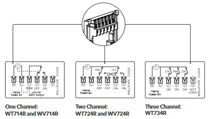

I can see the problem, this
is it, the same back plate is used for 1, 2, and 3 channel control, with one channel we have volt free, and with two and three channel it is not volt free, however with the volt free version we can have 24 volt and 230 volt in the same enclosure so the danger of selecting the wrong supply still exists. If anything worst than two 230 volt supplies.

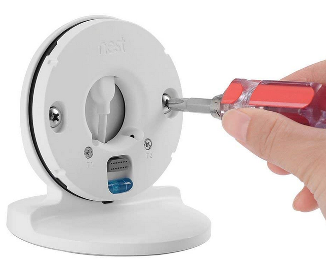

However if we look as Nest Gen 3 as an example, it is common for the heat link and the thermostat to have independent 230 volt supplies, OK the thermostat has some power supply to drop the supply to 5 volt and uses a USB system, but at the end of the day, both the heat link and the thermostat are supplied from the mains and there is a unit upload_2021-12-30_12-34-13.png sold specially designed so the thermostat and boiler can have independent supplies. They can also have the same supply, using 12 volt DC from the heat link, but I can't see how you can have two independent 230 volt supplies when using Nest Gen 3, and then say you can't have two independent 230 volt supplies?
So I have my hard hat on and am waiting for the flack, but I personally can't see the difference to having a step down transformer or power supply built into the thermostat or have it as a independent plug in unit, if one system can have two independent supplies so can others. Can't swap and change rules because one just feels like it.
Personally my Nest Gen 3 is powered from the heat link, and this has caused problems, when the plumber was due to fit motorised valves he asked for heating to be switched off day before so it was cold to work on, which I did, the result was the back-up battery in the Nest thermostat became discharged, so on turning the power back on, nothing worked until the thermostat had recharged its batteries, had I been using the Stand with a USB supply then I would not have needed to wait for battery to recharge.
I can't see how using two AA batteries is OK and using USB is OK, but direct to mains with the power supply built into the thermostat is not? I look forward to seeing the arguments.
