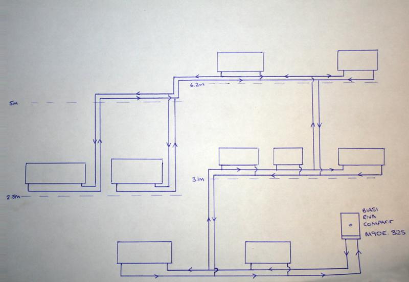

Hello!
I've just installed a new central heating system. Due to the wierd and complicated natuire of our building, the route for the pipework is pretty strange (see the diagram below).
I set it running yesterday and started balancing it. The first 7 radiators are heating fine but 8 and 9 aren't heating at all. In fact, the flow pipe just beyond the 7th radiator isn't even hot. The first seven radiators have had the LSVs altered to reduce the flow and the last two are fully open.
Can anyone tell me what's happening here and what I can do to help it?
Many, many thanks in advance!

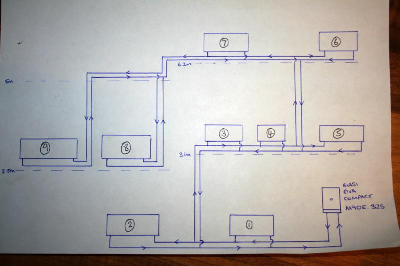

Could you number the radiators, so we know which ones you are talking about. Also give the order in which you balanced them.
Do you have TRVs on any rads?
How did you measure the flow and return temps on each rad?
What size is each rad?
What size are the pipes?
What do the numbers 2.5m, 3m etc mean - and why are they significant?

Here are the radiators numbered. I balanced them (not technically, just using my hands to feel warmth) from 1-7:

- The numbers are floor heights. I thought that maybe the pump wasn't powerful enough to get the water up such a lot of hight differences (with rads 8 & 9 requiring the extra height for the return flow). I thought it might be useful to someone more plumbing-minded than myself!
I thought they were heights; I guess you equated that with the pump "head". Unfortunately that is a frequently misunderstood term, particularly when it is measured in metres/feet.
The pump head has nothing to do with the height of the radiator above the ground. It is a way of measuring the pressure loss in the pipes due to friction. This is determined by length, number of bends, valves, flow rate, temperature drop etc. A head of 4 metres means a pressure loss of approx 40kPa.

From your diagram it could simply be a nasty airlock.
Have you tried turning off all rads except number 9?

Haven't tried turning all the rads off except 9. Will try that tomorrow. If it is an airlock how do I clear it? This has been my suspicion because of the abrupt halt of heat in the pipework.

By turning off all other rads the full force of the pump should push any air lock into the rad.
You could also try pressurising the system to max temporarily to help remove any possible air lock.

Take a look at the Stelrad Elite Catalogue and you should be able to identify rads which are close enough to yours. Then post the kW information given. I can then work out the approx pipe sizes required.
Do what dave has suggested turn every rad off except the furthest one that is not heating .This will force the air out. Then turn that one off and do the other one,
Taking pressure up as he has also suggested will assist in moving your air lock
