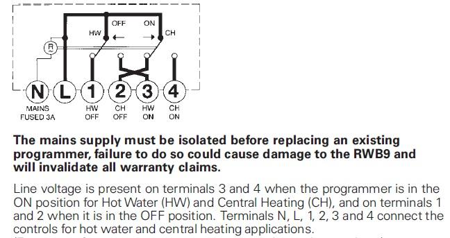

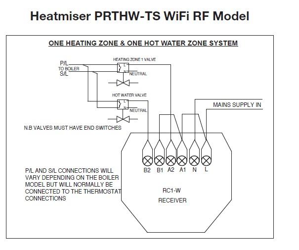

I am trying to replace a central heating timer and I am having some trouble working out out to wire it correctly.
My old system is wired with this diagram.
My new system has this diagram.
I have tried replacing what I thought was like for like but it hasn't worked.
B2 from pin 3
B1 from pin 1
A2 from pin 4
N and L transerred.
The wires I have coming to the timer are 3 multicores-
brown blue earth x 2
brown blue earth black black
the blacks were attached to 3 & 4.
L had a single brown
N had 2 blues
pin 1 had a blue
pin 2 empty
2 browns were also directly connected away from the block
I am guessing it is something to do with the fact that the new timer uses zero volt switching as opposed to switching power between 2 pins.
I have tried using a piece of wire to connect the L to A1 and B1 but can't work out what to do with the blues or even if I need to make other changes.
My system has no other thermostat.
It is a fully pumped system with a divertor by the tank to switch between CH/HW
