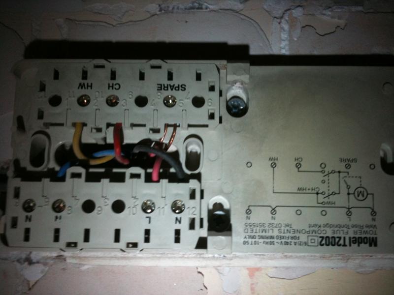

Hi,
Im sure this has been asked many time before, but I just want to be sure before i start..
I want to replace a very old grasslin T2002 on a what I belive is a fully pumped system with a 3 port valve.
My quesiton is around the connections in the current timer..
Currently there are terminals labled as follows and connected as follows:
N ........ L ..... . N ............N
(Black) (Red) (Blue) (empty)
Spare . CH HW
(Earths) (Red) (Yellow)
Im wantingto replace with a Horstmann C17 Timeswitch. 2 channel
I belive the new pins should be:
Pin: Wire:
Earth - Earth
N - Black
L - Red
4 - CH - (Red)
3 - HW - (Yellow)
3
My worry is what I do with the Blue wire currently connected?
Hope someone can help
regards
dis

Got that. The C27 will do the trick. The question is will the wiring to the existing timer do the trick? Possibly - it all depends what the mysterious blue wire does. (You need to find out.) For a V4073 to work properly you need a connection from the HW OFF terminal of the C27 (no such terminal on the T2002). This means you need five wires to the C27 (L, N, CH ON, HW ON, HW OFF). You also need three wires connected to the HW cylinder thermostat. Here is the full wiring diagram:

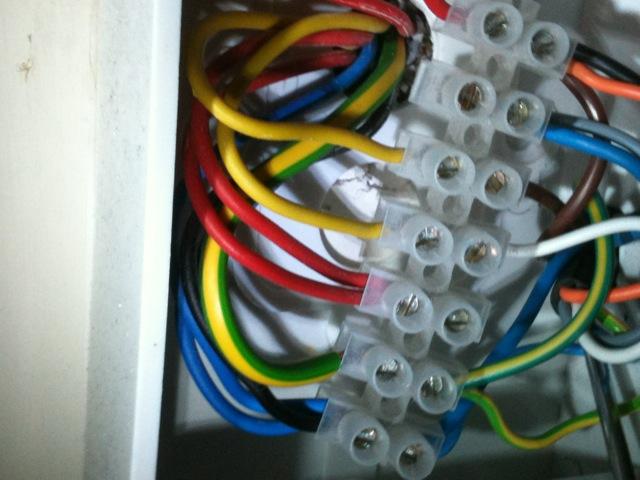

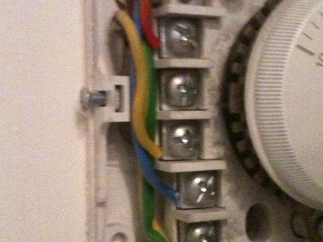

Sorry for the VERY late reply.. hope this still reaches you...
I have take a pic of both ends, in an attempt to trace the plue wire..
Boiler end:
Thermostat:
hope this helps..
agian sorry for the late reply.
