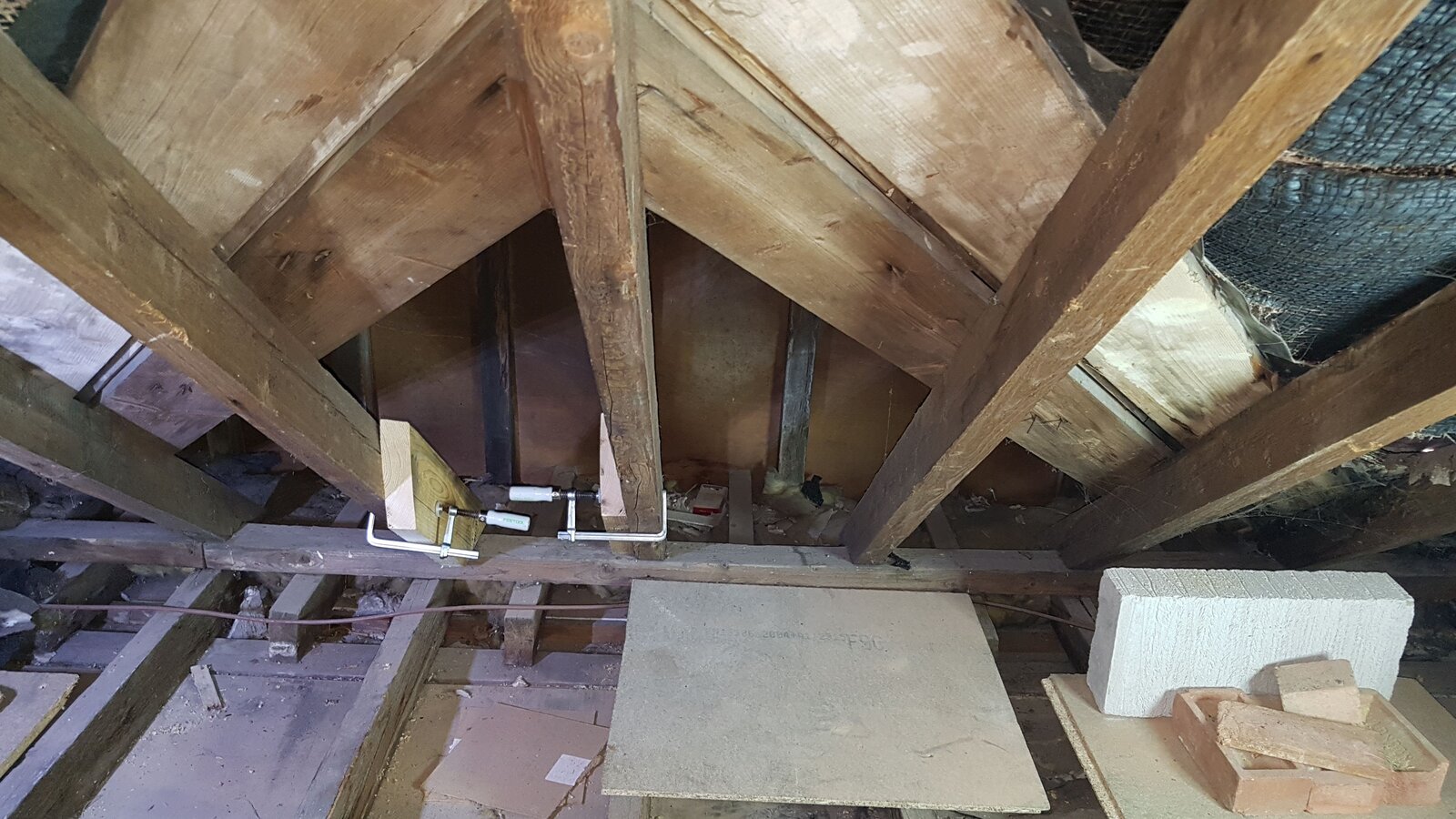

Hello Folks
I need to sister
along side existing ones and i am a little unsure on how to
configure it. The new rafters are 47 x 150 and the existing are 50 x 100m. If i cut a birdsmouth to suit the plate i would be taken more than a third out the rafter which obviously is a big no no. So do i move the plate forward to get over this? The pictures show some offcuts i used to figure out how much the plate would have to move forward which is exactly 80mm
Any suggestions, comments welcome
Dont attempt to move the plate.
Use same size rippings of 22mm ply screwed through the ply well into the rafters - you could even sister both sides of the worst splitting rafters.
No need to worry about birdsmouthing the rippings just cut them level with the plate.
