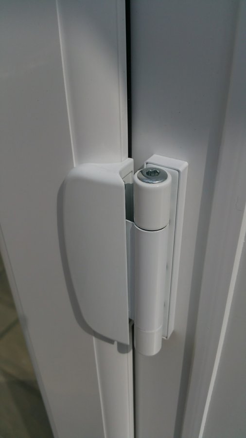

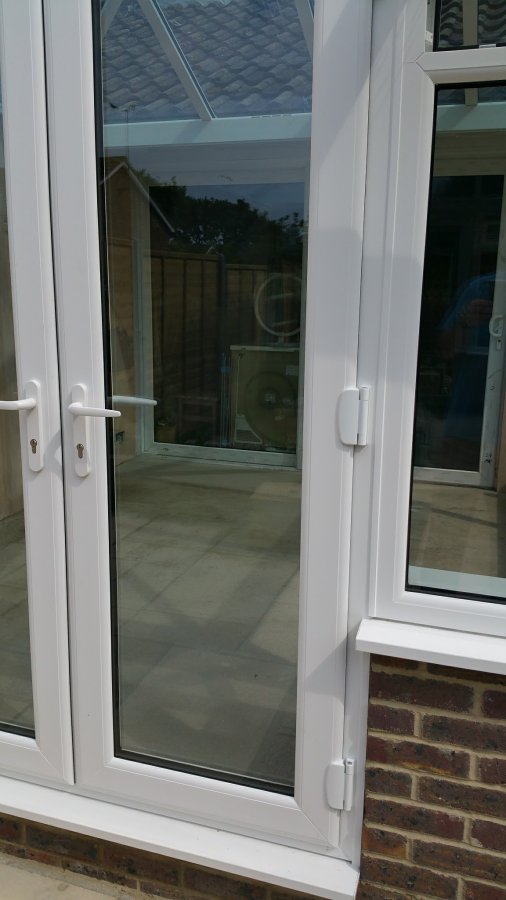

We've recently had our old conservatory replaced and the job is nearly completed. But I've just noticed something that worried me yesterday. Now this may be a stupid question but I found it very odd that the hinges were on the outside of the door with what looked like allen key bolts securing them and I thought all someone has to do to break in is to unscrew those bolts. I haven't tested this theory out but am I right?
I've attached some photos and thought I'd ask on here before trying to test this out, hope I'm wrong!

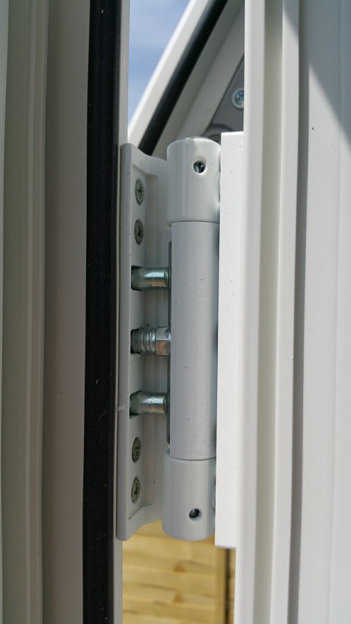

Perfectly fine, the Allen bolt is the hinge pin but it is secured with a tiny grub screw, if you open the doors and look behind the hinge you should see it but either way if the doors open out then the hinges need to be outside too, the door wouldn't open if they were inside
So the Allen key hinge bolt can't be turned if there is a grub screw? I would have thought the leverage exerted from the allen key would have been sufficent to negate the effect of a grub screw unless you are saying the grub screw actually screws into rather than onto or pinch the shaft of the hinge bolt(s).

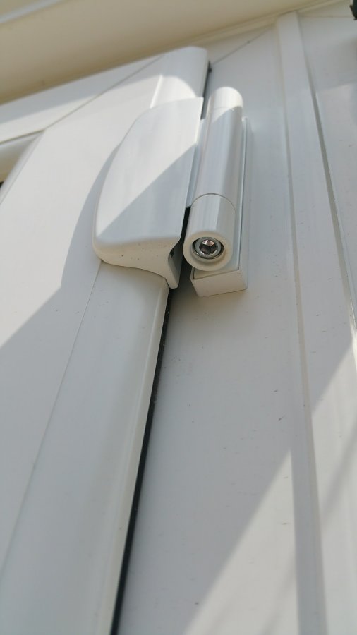

I have taken a photo of the hinge and looks like the grub screws have not been fitted, doesn't look very secure to me.

The grub screw doesn't pinch, it locates in a groove running around the pin, do those holes have threads in them? The hinge manufacturers who assemble the hinge should put them in, I bet the frame fabricators didn't even check, it's no big deal though to get some grub screws and put em in if it gives you peace of mind, couple of quid if that, but if someone wants to get in they'll just pop one of the French door dg units and walk in, you wouldn't even hear them
Okay thanks for the info. Yes they do have threads, they just forgotten to put the grub screws in.
