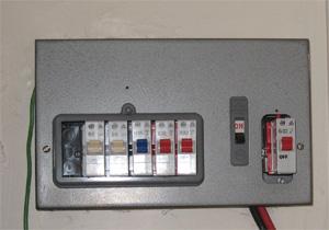

Hi, I'm replacing my kitchen, thinking about getting someone in to do the sockets and relace the consumer unit at the same time (want RCD protection to keep the little one safe.)
Got somebody coming round tomorrow to give me a quote. Would appreciate some tips on what to ask for to keep the cost down!
1. consumer unit looks like this. It's an old Wylex board that's been upgraded with MCBs. Anybody know why one fuseway is on the right (downstairs sockets), separated from the main bank on the left?
2. currently there is one ring main for all downstairs sockets including kitchen, and the oven is on a separate radial circuit. I need several new sockets in the kitchen, and the new oven will be in a different place. The new oven can be just plugged in, or wired into a cooker outlet.
questions are:
a. should I get the kitchen sockets separated onto their own ring main, or just get the new sockets added to the existing ring main? Major electrical appliances will be oven, washer/dryer, kettle, fridge freezer, dishwasher.
b. should I get the cooker outlet moved, or just scrap the radial cooker circuit?
3. I'm going to install the new kitchen cupboards myself. I'm thinking about gutting the existing kitchen, getting the electrician to install the scokets on the wall below the work surface, then drilling holes in the backs of my new cupboards so I can plug the appliances in. Is this sensible?
Thanks for any tips!
1. no idea why a seperate breaker....
2a.
a seperate ring for small appliances ( microwave, kettle, smoothie maker, toaster etc. )
a seperate 32A ring or radial for heavy appliances such as washer/ dryer and dishwasher
a seperate 20A radial for the fridge / freezer ( on the non rcd side of the 17th edition board, either installed so no RCD is needed or on it's own RCBO.. )
2b.
a seperate "cooker feed" for the oven.. this should be installed in 10mm cable even if it's only got a 20A breaker fitted for now to power the oven.. it gives the option of fitting an electric hob later if you want or if you ever sell..
3. opinion is divided.. .. personally I like it the way you say..

the separate MCB on the right will be intended for a higher-rating circuit such as an electric cooker or a old-model, low-power electric shower.
the old Wylex board was generally not designed to carry any circuit with a load above 30Amps, hence this single high-power position.
if you are having a comprehensive rewire done, it is certainly worth having your kitchen provided with:
(1) a 40A cooker outlet, even if, at the moment, you use a gas cooker, it will be useful if you change your mind or sell the house, and will not add so much to the cost if done at the same time
(2) a separate ring or radial to supply your kitchen outlets. You will probably end up with a lot of appliances. I went for a 13A socket under the counter at every position where I have, or one day might want, an appliance such as fridge, dishwasher etc. Each of these should be controlled by a switch above the worktop so that you can see how to turn off the appliance, for example for servicing or in an emergency. But don't have a switch on the wall above the cooker, you don't want to have to reach through smoke and flame if you get a chip-pan fire. Never hide switches inside cupboards. I also recommend a switched double socket at about 1-metre intervals along the worktop for mixer, coffee machine, toaster, kettle etc. You will be surprised how many outlets you can use in a kitchen. The switch for the cooker hood can be in the same row. By running your outlets along the wall 150mm above the worktop, it is very quick to install and economical in labour and cable. If you can afford a separate radial circuit for the freezer, not on the main RCD, it will reduce the risk of a fault cutting all your power and you frozen food thawing out while you are away. If you have a very large kitchen or lots of money, it is useful to have a separate radial circuit along each side of the kitchen, both to give you power in the event of a fault on one circuit, and to spread the load of appliances like dishwasher, washing machine and tumble drier - these use so much power that if you run three of them on heating cycles at the same time, you will probably trip the overload breaker for that circuit. If like me you are very eccentric you might like a cooker outlet on each side of the kitchen in case you decide to move the cooker position.

I also think that the seperate way was a feature of the old wylex board, to give 1 position of a higher capacity.
Whether you decide on gas or electric cooking, i would still advise a 40A circuit for the cooker, it wont cost much extra now, but if you leave out now, then need it later in life, it definately will cost considerably more.
