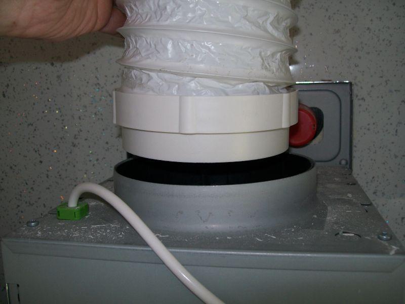

Firstly, there was a "large amount of duct tape" on the top of the appliance. I know from experience that this duct tape usually dries out and peels off - leaving nothing but the dried up glue behind.

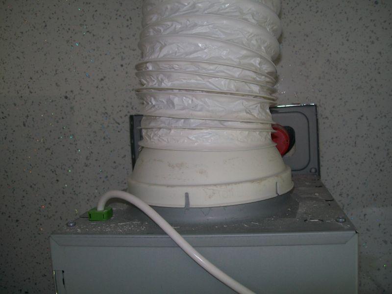

To see what was there, we pulled the tape off, and found this
There's a reducer (I assume it's the one shown in the appliance instructions), and the duct is a very loose fit on it. Neither were fixed with anything but the tape.
The duct kit has an adapter with it, but this doesn't fit either the reducer or the appliance spigot

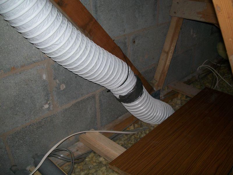

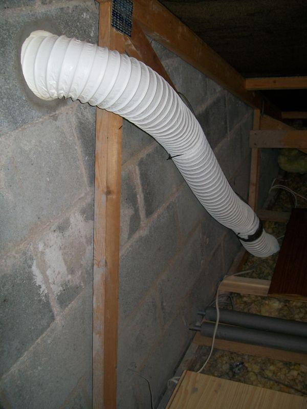

In the attic, there is now an extra length taped on

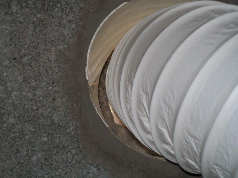

which goes through a hole in the wall to a terminal
For some reason, they've fitted a plastic sleeve in the wall which only goes about 2/3 of the way through (the hole isn't large enough for the outer bit), and the duct is clearly fixed to the grill with more tape.

Given that the manufacturer recommends 150mm duct, is 125mm sufficient. The hood does certainly suck with the 125mm, but would it be significantly different with 150mm ?
Is joining the duct with this duct tape acceptable ? Or what should be used ?

I'm thinking it would be better if the rigid duct went right through the wall, and was in fact the duct itself, so self supporting and the grill is just to "finish the hole" on the outside ?

My thoughts are to remove the grill, remove the piece of rigid duct, open the hole out and fit a longer section of 150mm rigid, and refit the grill (squarely on the wall this time !). Inside, use a 90˚ bend, another length of rigid duct, and finally a short section of flexi duct to the appliance.

I would not worry too much about the size of ducting but looking at the photo I wondered if rain could get into the ducting? Would it be better for it to initially slope upwards a bit before dropping down? Perhaps some string secured to a roof timber to hoist it up slightly. Duct tape comes in different qualities like most things but if you choose a known Brand such as 3M it should stay stuck and will seal despite the gaps. You could also run a bead of silicone round the joints before putting the tape round.
You could lag the ducting in the loft with fibreglass or something to avoid condensation problems.
I realise that it might be unavoidable due to the location of your cooker, but having ducting running that length (and upwards ) before it exhausts externally is far from ideal. The longer the duct the more resistance to air flow (back pressure). You are also likely to have fumes condensing and running back down/congealing on the duct before being exhausted from your property.
Does the manufacturer's manual mention a recommended maximum run ? Normally it's 3 metres absolute max.

Dunno if you still need help with this, but I'm a bit of a pro when it comes to ducting :) The duct should be 125mm for that extractor. You need to use proper foil duct tape like you mentionned (Duck tape isn't duct tape, and neither is PVC electrical tape!) a pvc duct hose is no good (it'll melt) it needs to be foil, and through the unheated roof, the duct HAS to be insulated in some way (preferably insulated foil duct: http://www.screwfix.com/p/insulated-hose-127mm-x-10m/28054
or http://compare.ebay.co.uk/like/1702...&ff3=1&ff11=ICEP3.0.0&ff12=67&ff13=80&ff14=65
or rigid duct wrapped in reflective bubble insulation (which is used in lofts) because water WILL condense in it during the winter, causing mould and dripping
the grille outside has no damper or flaps either (drafty!)
Well for now it's just been taped up with proper tape - so I don't think it's going to come unstuck ! Probably come back to it later - when the weather's cooled down and the attic isn't quite so warm.

When I first installed a fan duct, I made the same mistake everyone else does, and used that white vinyl duct through the loft. In the winter, water started dripping through the ceiling (just the moisture in the warm air from the room condensing on the walls of the cold duct through the loft caused it to sag and fill with water. It also went all black and mouldy inside. I replaced it with insulated foil duct and all problems solved.
