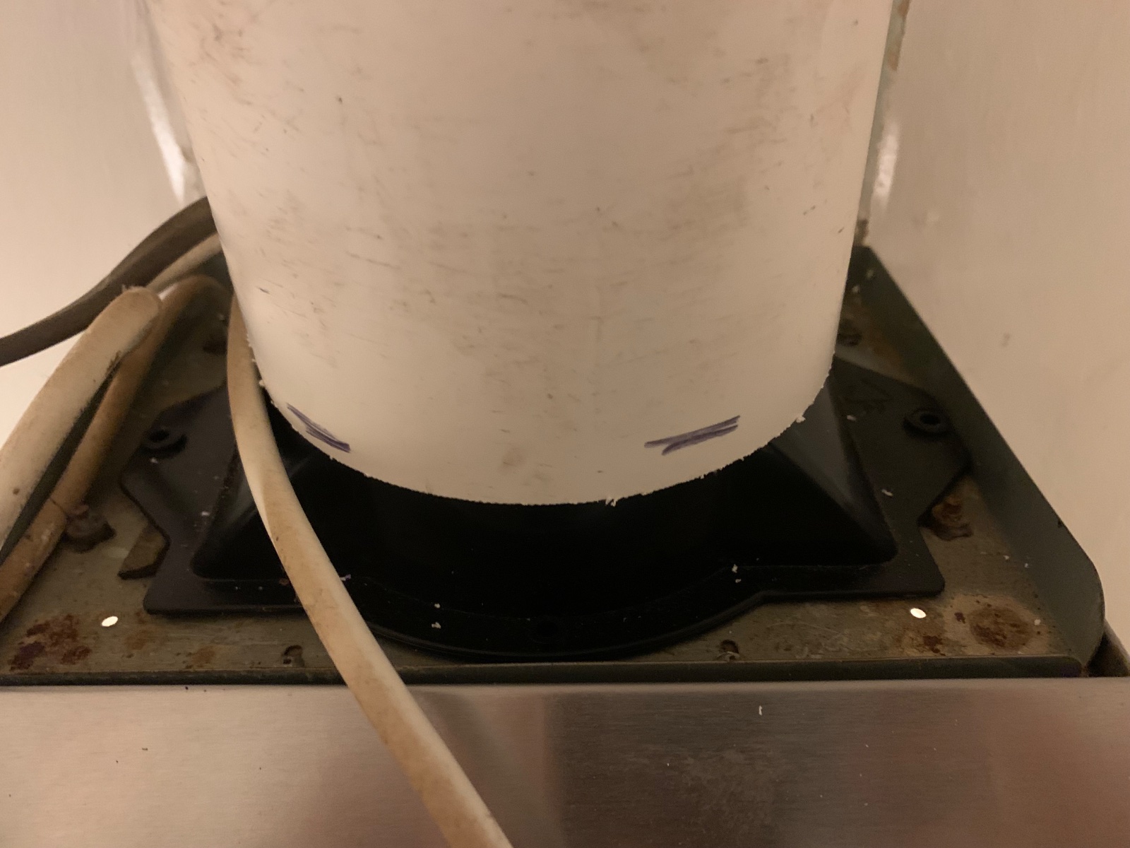

Hi folks, first post here. Recently had an electrician install an extractor for our cooker hood. I requested the core drilling and extraction ducting be 125mm which is specified by Baumatic. No problem they said…
Day of the install the guy keeps moaning about how 100mm ducting is standard and 125mm is a pain for various reasons. Then says he brought a 100mm kit and will have to run to Screwfix for the 125mm. He leaves and core cutting guys come and cut a hole big enough for 125mm.

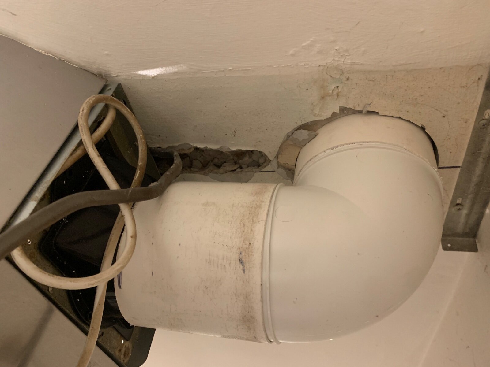

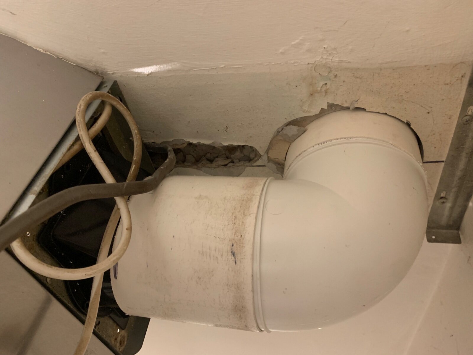

Guy comes back with not a 125mm ducting kit but a 5’ long plastic pipe with a 90 degree bend at one end. This seems weird but he claims it’s all they had. He cuts it to size and finishes the install while I look after my son.

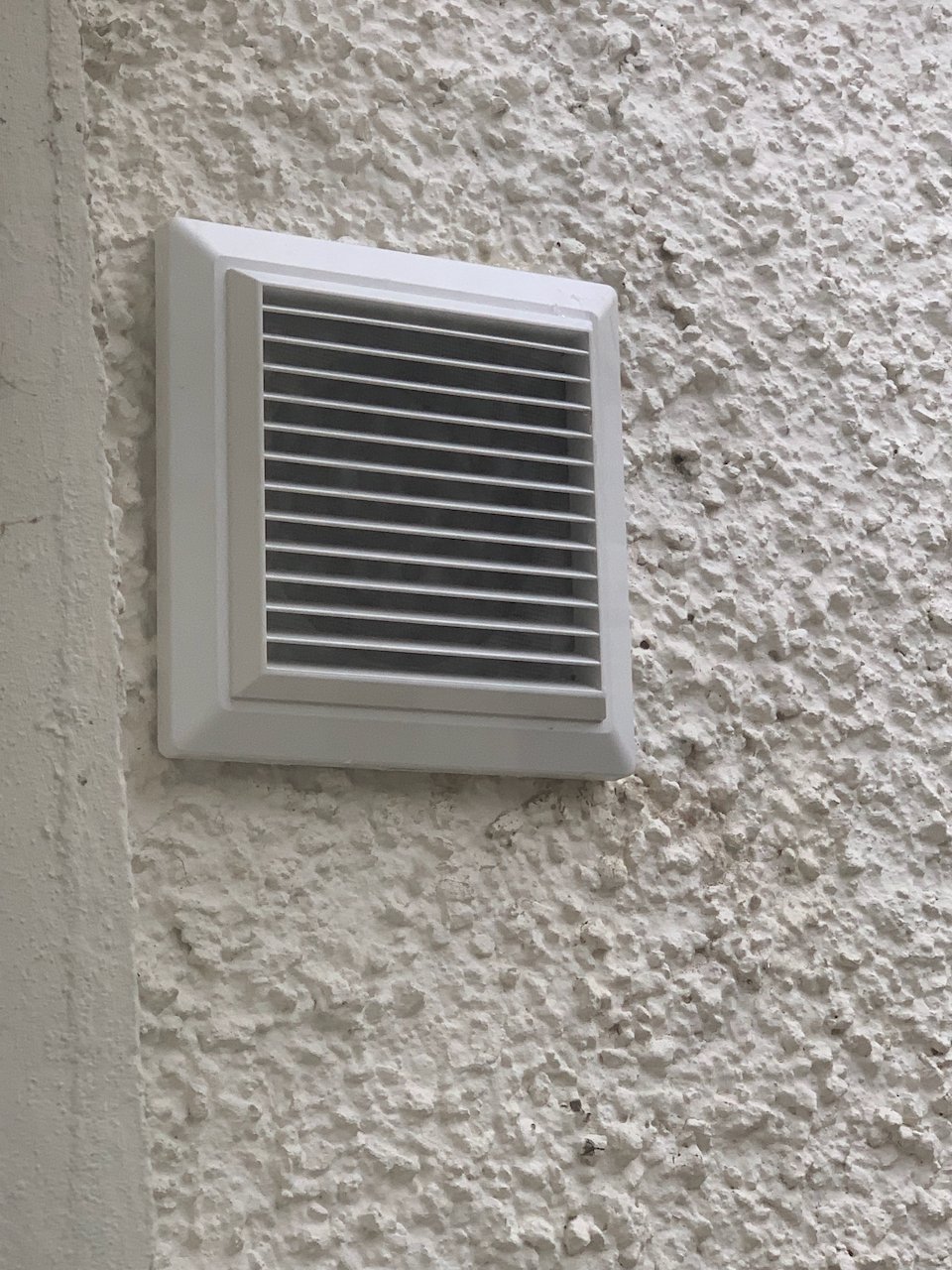

The last thing is installing the vent grille/cover on the outside of the house. Rather than use the included screw kit, the guy just puts a bunch of white sealant on the edges and sticks it to the exterior wall. Mind you it’s raining and around 4 degrees out, seems like a bodge but he claims it’s fine.

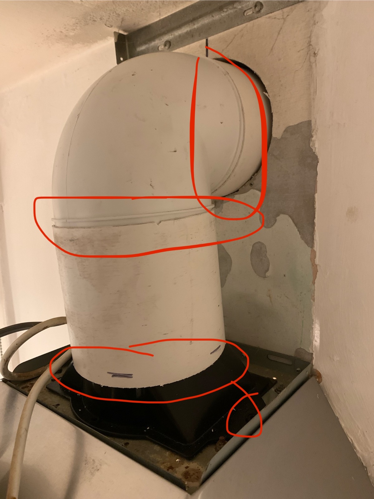

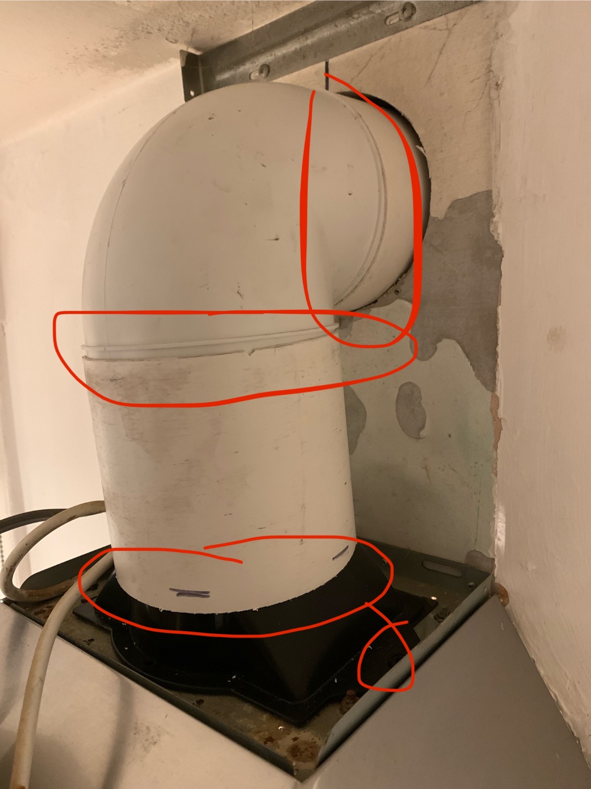

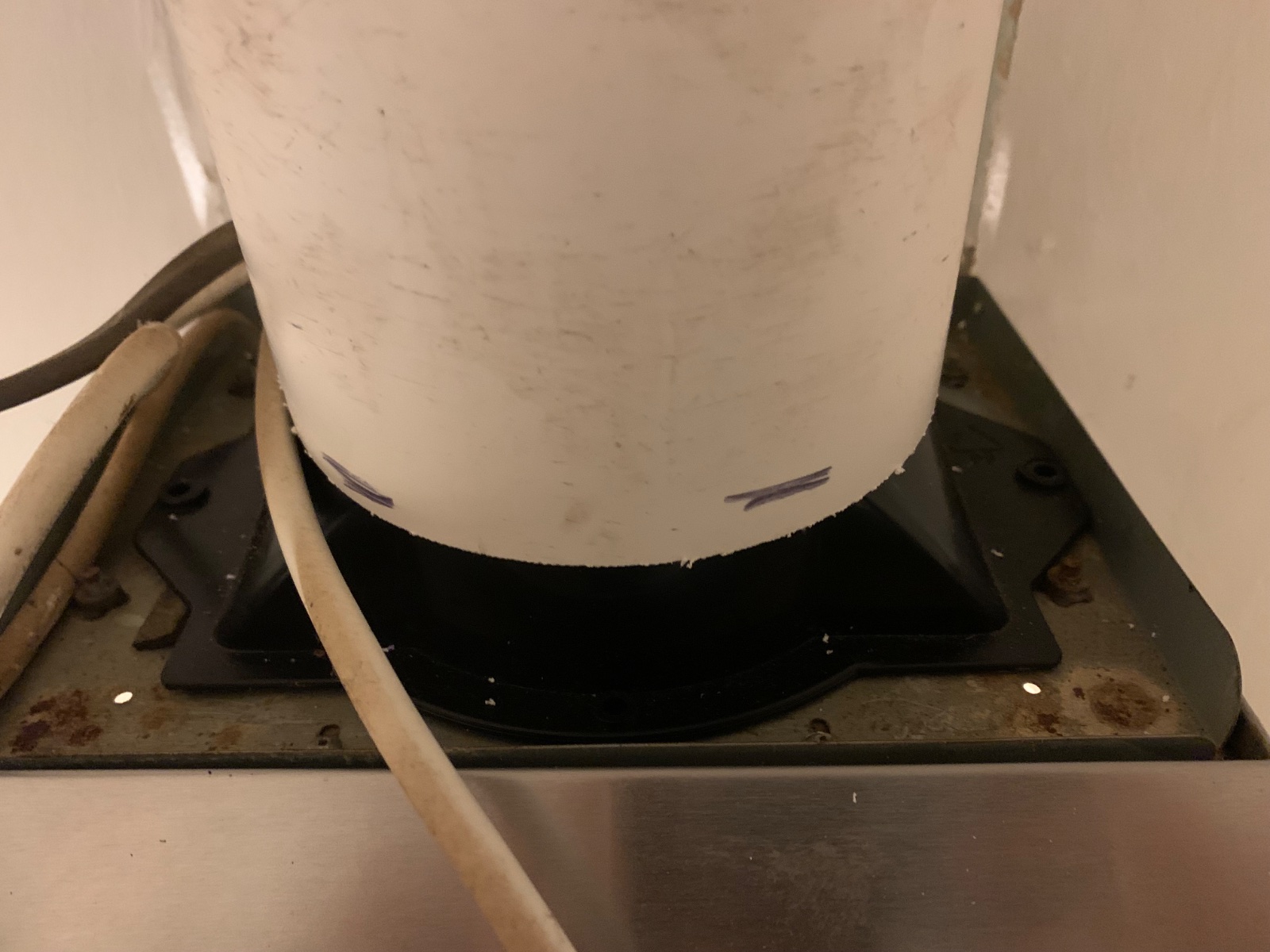

Fast forward 3 weeks and the extraction doesn’t seem to be doing much. We’ve had an air quality monitor setup since my son was born to check PM 2.5 and VOCs, and we’re not seeing much of a reduction compared to when the hood was only recirculating. So I take off the hood cover to see how the ducting is connected and find that there are 3 unsealed junctions which are bleeding air. This is because the plastic pipe is actually 130mm and is just sitting over the 125mm Baumatic vent outlet pipe attachment (black thing at the bottom in the photos between metal hood and plastic extraction pipe) with no clamp or sealant.
I put some duct tape around the 3 junctions and will monitor the air quality over the next few days but basically this whole job seems like a total bodge. I’m wondering if it’s common or even safe to use plastic piping instead of the standard aluminum ducting, and if the external vent cover is going to fall off or let rain in.

Bit of a bodge but plastic is fine , foil ducting tape gives a longer lasting repair than standard duct tape .
Where are you measuring this? 125mm inside diameter is very likely to be 130mm outside diameter.
BTW I did exactly this job myself but I stitch-drilled it as I couldn't really justify acquiring a 125mm drill.
If that is your total distance then that very short run should be very powerful and make a massive difference in the kitchen. The gaps you have taped up would not effect the flow much. Can you feel it outside, what grill is outside.
Tight 90degree bends, will drastically reduce the flow, but at least they have used rigid pipe.
That depends on the 'sealant' used. Hopefully, the grill, is fitted with some sort of automatic opening mechanism, to prevent wind blowing in?
Looking at the very short distance you could have almost got away with just a slow bend like this and straight out.

I saw a guide somewhere that said you take the hood manufactures recommended max duct run - say its 5m then for every 90 bend you then take off 1m
The OP doesn’t really even have a run so it should be amazing, odd as to why not
We haven't seen a photo of the outside grill yet, depending on design, they can add a lot of back pressure.
I have the one with 3 flaps but on studifying it I could see that under operation one flap was catching so I did a bit of trimming with a Stanly knife so it fully opens now..

Ours, is a single flap, with the pivot off-set, so gravity closes it, and wind blowing on the faces, closes it even tighter.

Hi Folks, thanks for all the helpful replies. From what I'm reading here, the rigid pipe isn't an issue, possibly a benefit actually, which is reassuring. Sounds like the 90 degree bend isn't ideal but it was a lot easier to go out the side wall than the roof (wall is approx 1 foot thick, so overall run is maybe 3 ft). I did notice an improvement in air quality after the initial install, but not what we had expected. Since I added some duct tape we have seen a makred improvement. I will remeasure the pipe, but the internal diameter is big enough that there was a 2-3 mm gap between it and the vent outlet pipe attachment, and I could feel air coming through. I think the biggest factor was that the vent outlet pipe attachment was not secured to the hood and was bleeding a lot of air.

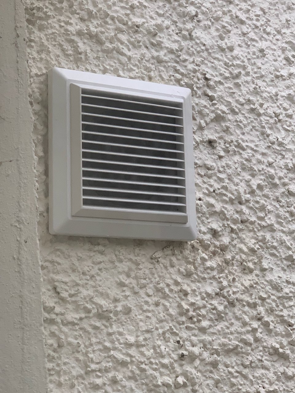

Coming to the grill, I've attached a photo. I think it's a 100mm grill as the guy mentioned he had brought a 100mm reducer, so I think he originally intended to reduce. It's 25 ft off the ground and I can't get to it out the window so I can't check more closely. The sealant was the white foamy type. I don't have experience with this stuff, but reckoned it might not set properly if it's raining and close to freezing. The flaps are fixed in place and do not pivot. Sounds like this might be an issue with back pressure. It is windy up here in Scotland!
100mm, if it is, will allow around half of the volume of air through as 125mm. That, plus the louvres, will cause lots of back pressure. If the wind blows against the face of that wall, that style of vent, has nothing to prevent cold air blowing in via the vent. So would certainly be looking to replace it with something more suitable.
Shame they reduced a brilliant 125 flow to a 100 at the grill. That grill looks very restrictive to me with permanent grill blockages.
