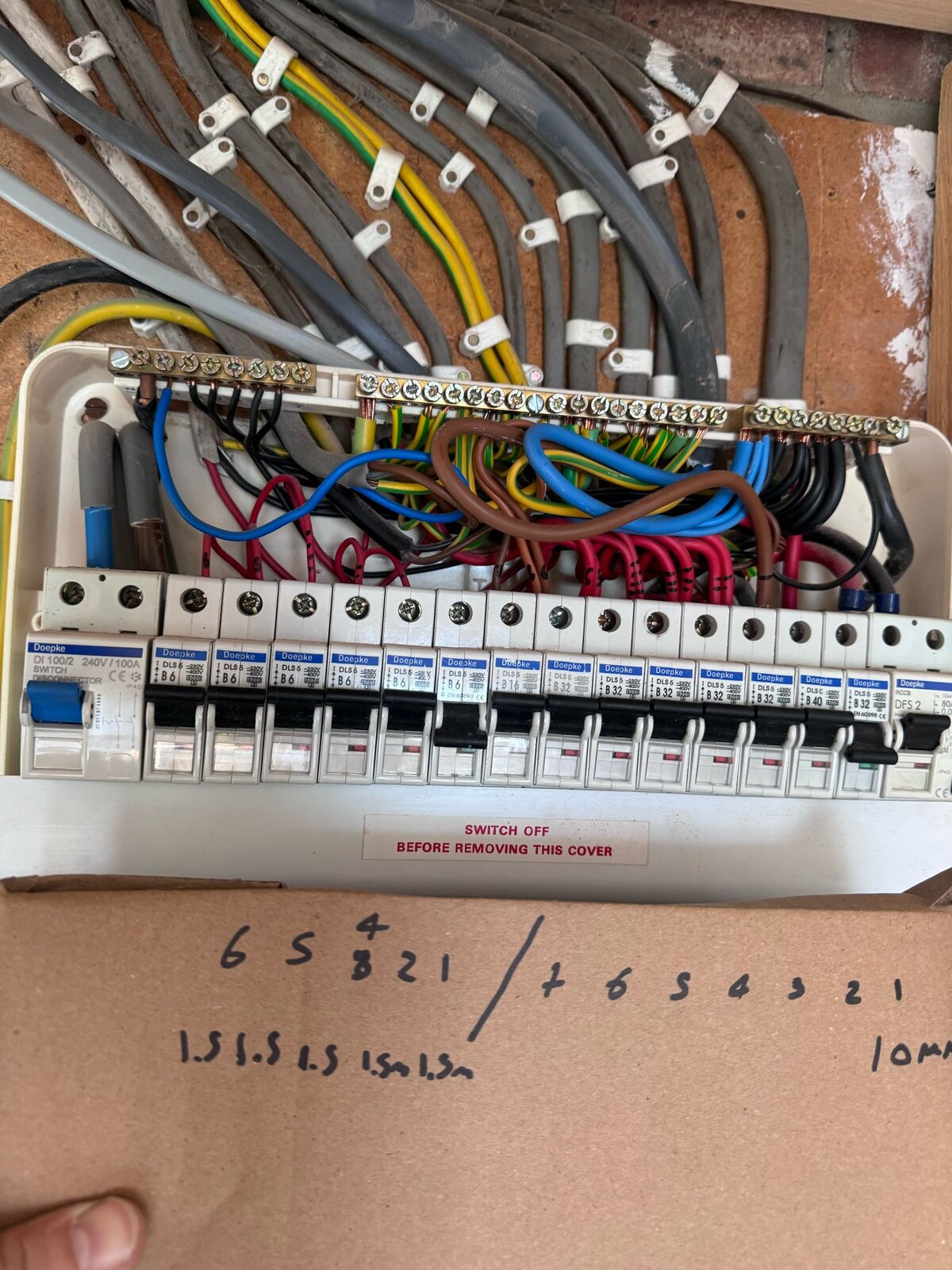

New CU installed, right type RCBO for EV?
Update all...guy came back after saying not paying..., changed the EV item rcbo, put in the empty blanks, and now provided some certificate documents, under new company name to the one he invoiced on. Not paid anything yet as waiting for EV DNO registration proof.
Are you saying the certificates give one company name and the invoice gives a different company name?
Could you post a photo of the CU now?
Being able to wield a screwdriver, and being able to run a successful business, are two different skill sets.
To correct my words... his quotation (not invoice) pdf was company with x name (which did not exist on niceic), and now the certificates are from a completely different titled name. Attached three photos, first the original CU, then before he left first time (taken when I was in kitchen talking to him), and as it is now.
