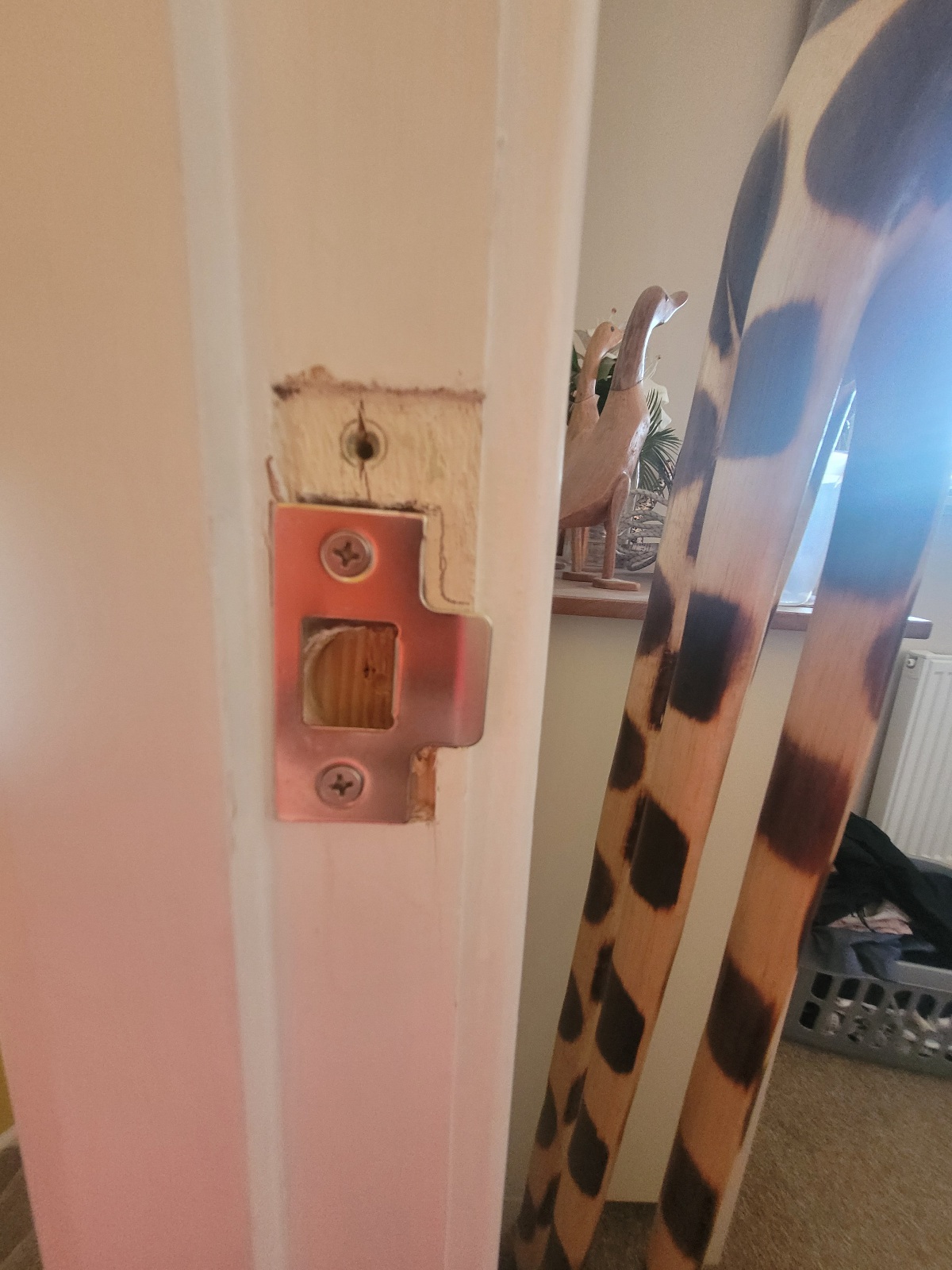

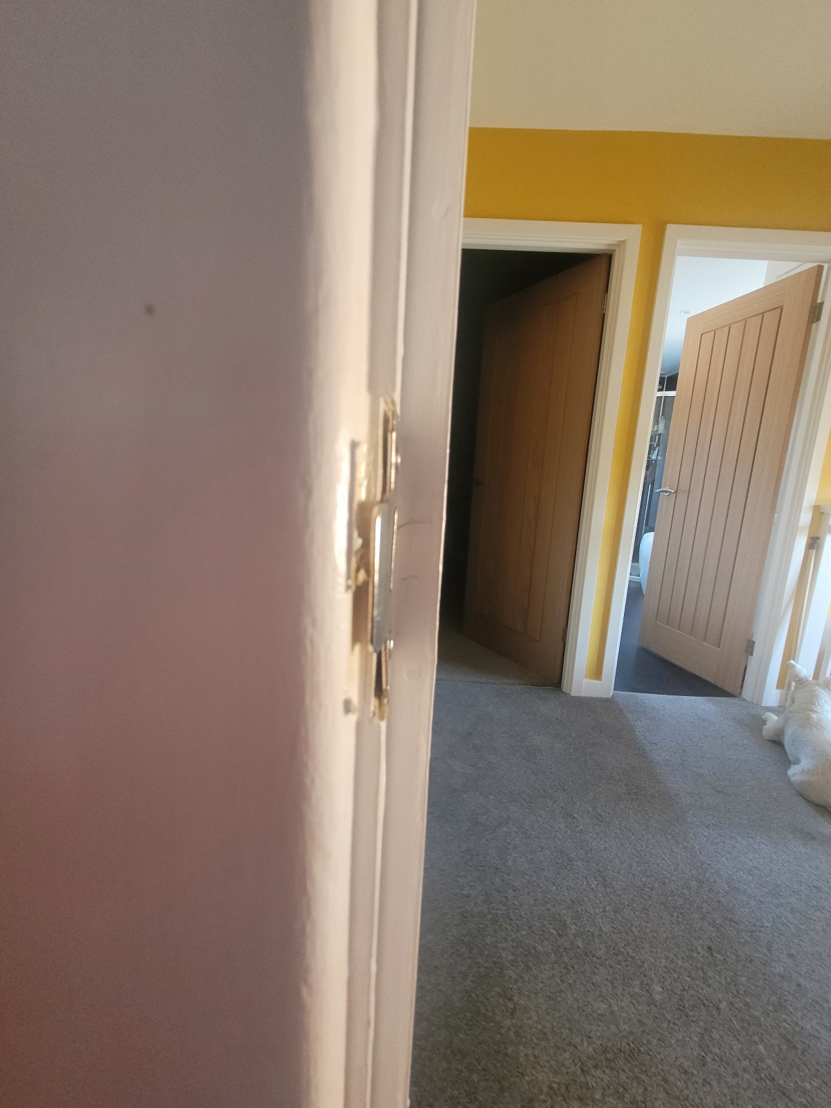

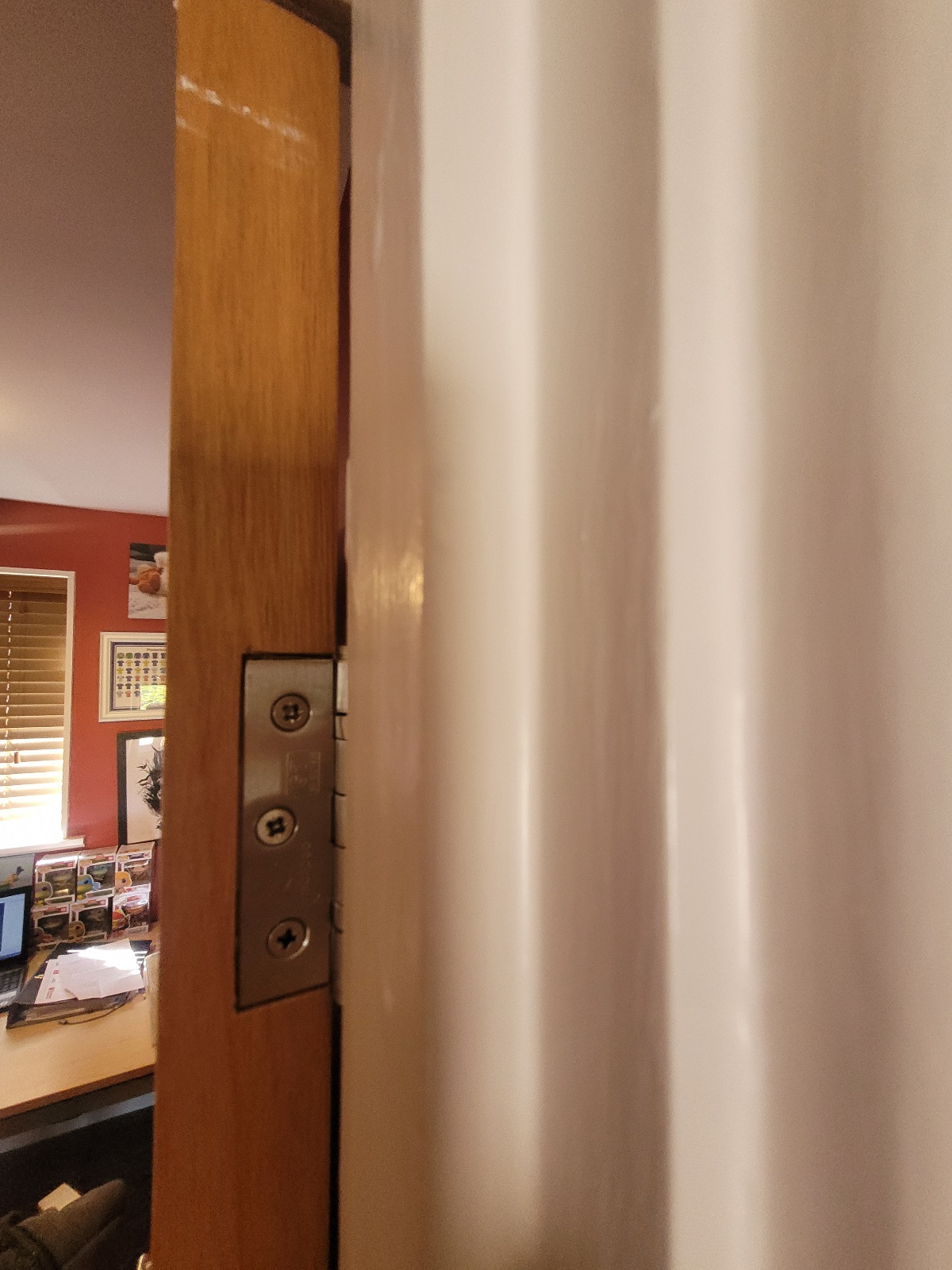

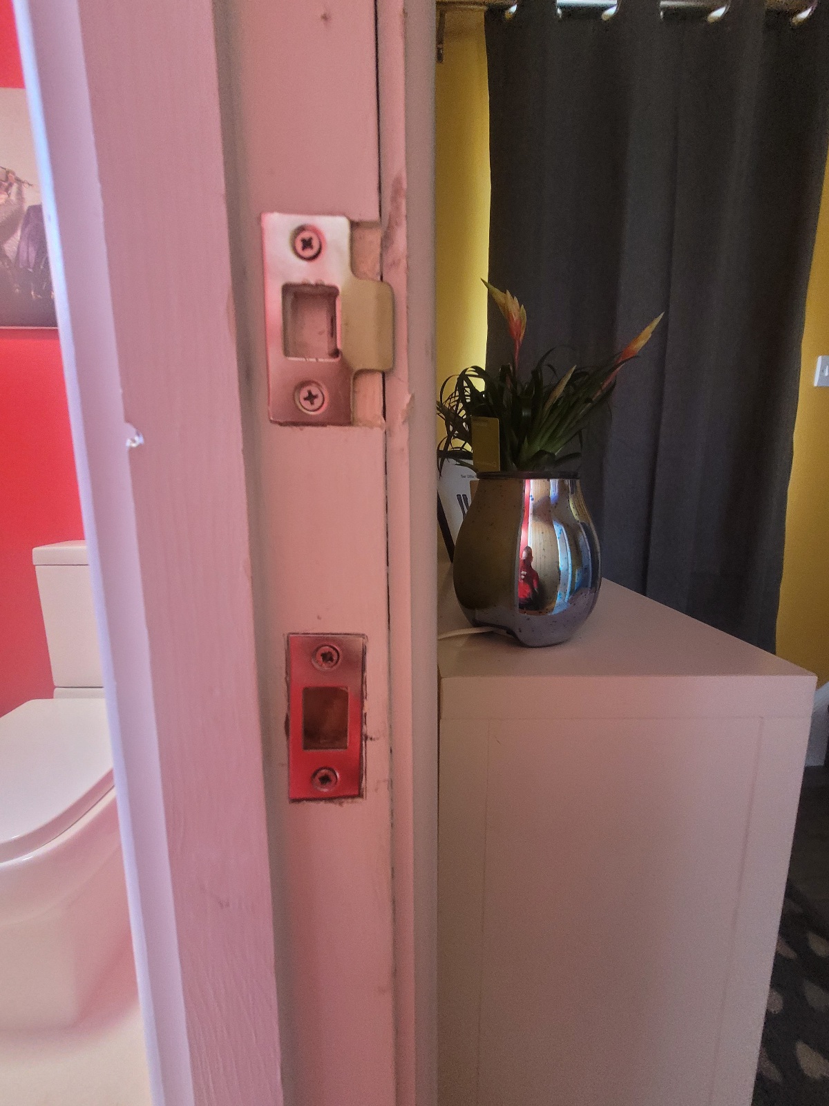

New doors, crap fitting
Even without making a jig, I always use a router freehand for most of the work, then razor sharp chisels, so to have nice flush hardware.
Said that, you would think that someone who is in howdens recommended list, would've cut themselves a jig, at least for the most popular hinges.
Few pics of work on the frames too. Tbf he can't do anything with the cut outs for the old catches but surely he could make the new ones straight and flush.
Also he's done what I think is a decent job of cutting the hinges into the door which makes me wonder why he couldn't do the same with the latches.
Anyway my missus is gunning for him when he comes back so he won't know what's hit him!!!

OMG!
Question: are you keeping the frames in white?
If so, you can remove the old hardware and fill the holes, then repaint them to a good standard.
But those doors...
OMG!!!
Agreed. Even for a one off it is still worth using a router to guarantee that your face plates are flush to the surface. If the lock side is this bad I can't see the hinges being any better
I'm not sure what to recommend about the doors. It may be possible to save the day by slicing 4 or 5mm off both edges of the doors, filling the latch body drillings with wood, relipping the doors with solid wood and then half redoing the job, but I think that requires a level of skill that this chap doesn't have
As to the casings, the way you deal with those is to rout away a section where the old keep was glue in a snug fitting repair patch (called a "Dutchman"), hand plane it back snd finally chop-in the ironmongery. Looks a lot neater than filling and makes the job of getting the new stuff in easier. Hinges can be dealt with in the same way. This guy has delivered very poor workmanship and he's made a right old mess of it

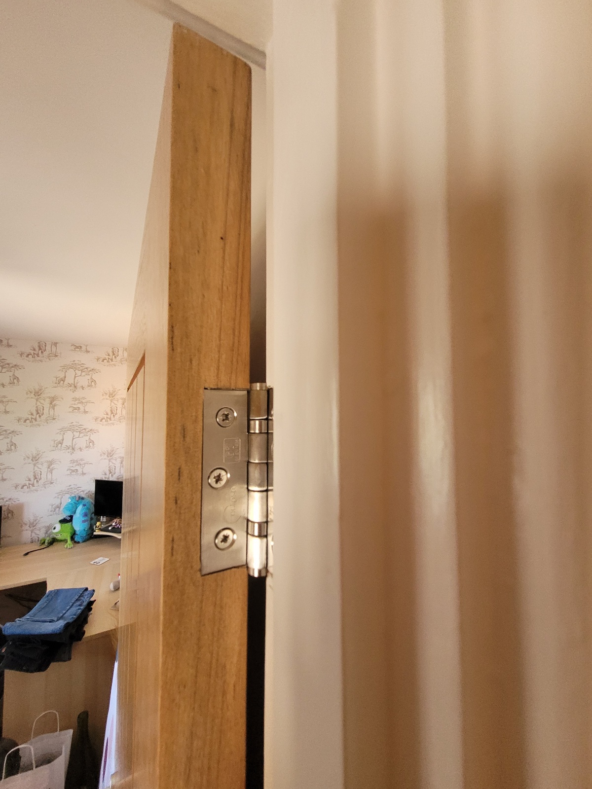

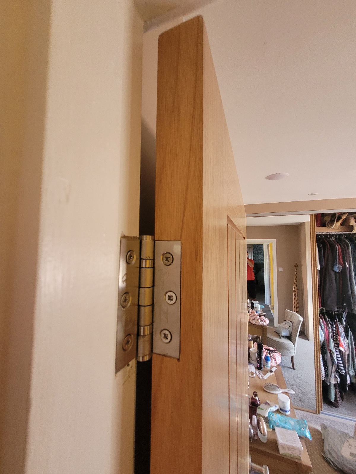

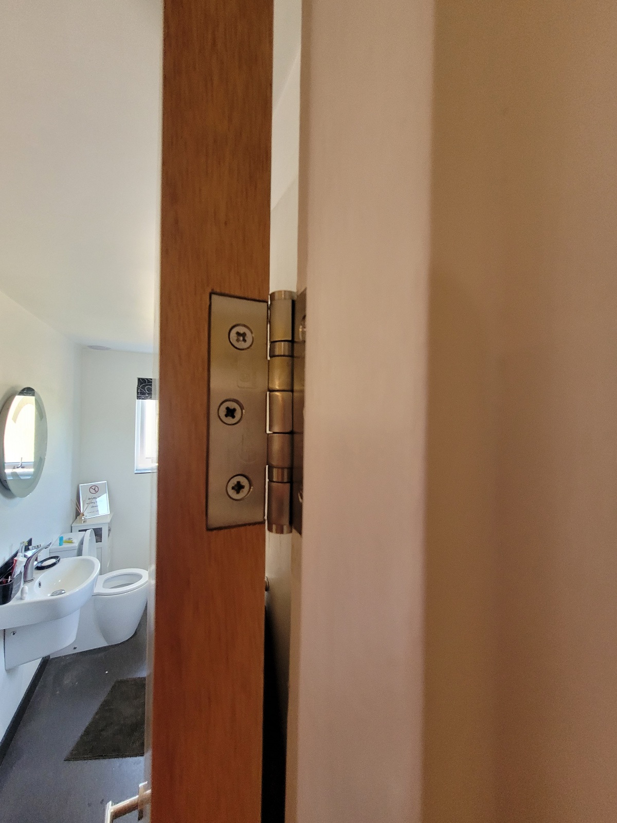

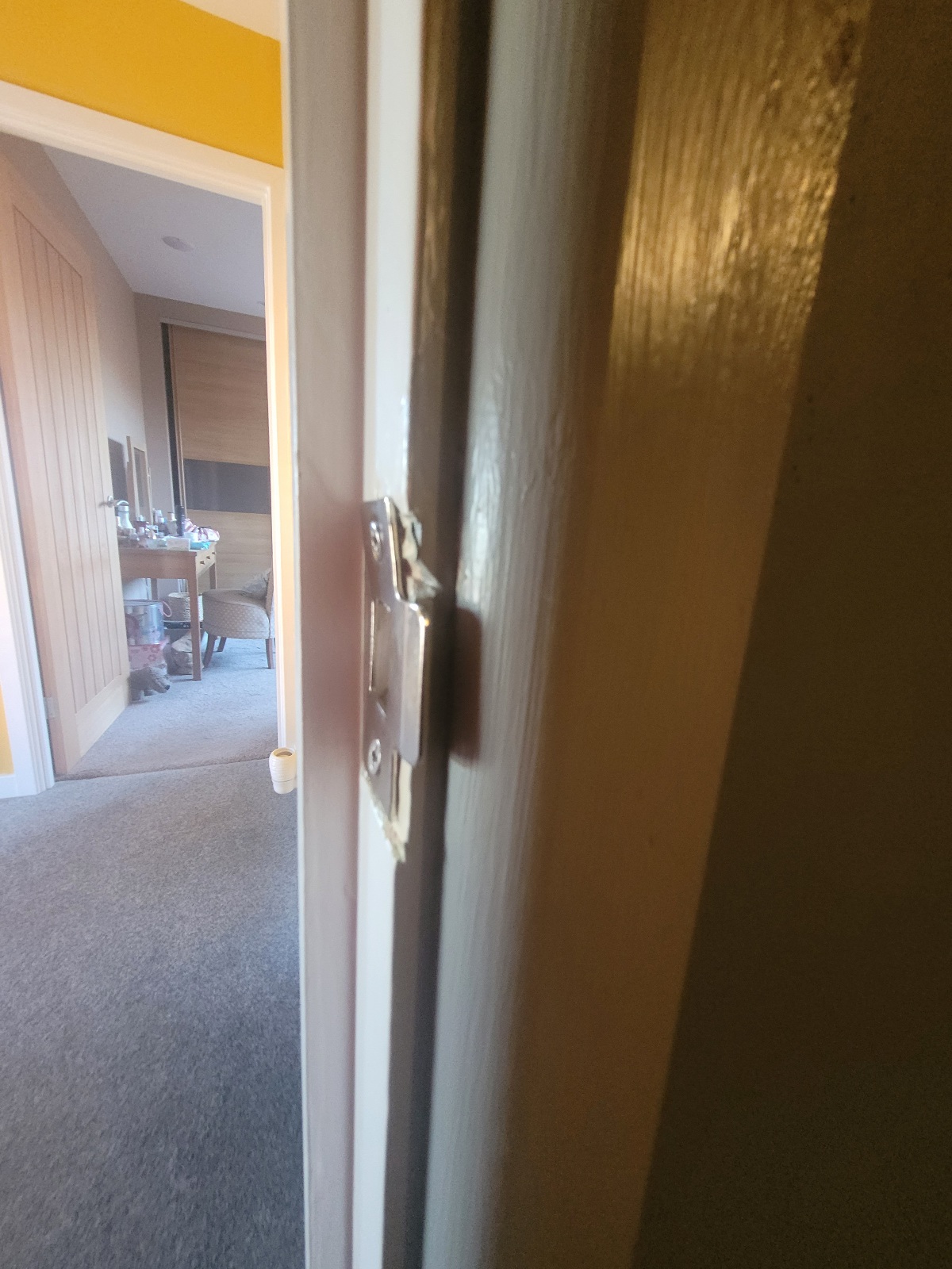

Please complete our day - pictures of the Hinge fitting both inside and outside.
TBH - I'd (at least, would have tried to) use the existing striker plates rather than fitting new. The chap I'm helping (a bricky/general builder, BTW) does a better job than what you have here.

You have only really shown photos of the poor latch fitting. If those are bad, I would expect the fitting of door into frame and hinges to be equally badly done.
[EDIT] I have just spotted the extra photos you have added. Which confirms what I said before - he is a wood butcher, not a tradesman. He has zero skill.
That's what I meant with "filling".
Comes natural for chippies to fill those with the Dutchman (y)

Pics attached. I'm no expert but on the face of it and in comparison to his other work I don't really have an issue with hinges. You may disagree?
