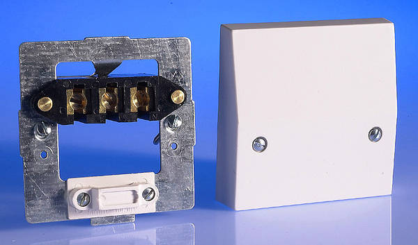

My old cooker has a thick white wire coming out of the back of it which plugs into a socket on the wall (it looks like an ordinary plug socket but its sealed).

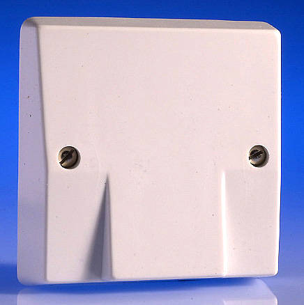

What does that mean? "looks like an ordinary plug socket but it's sealed" ? Is it actually a socket, or is it a cooker outlet plate similar to these?:

The white socket I told you about is indeed the cooker outlet plate, so thanks for clearing that one up for me.
