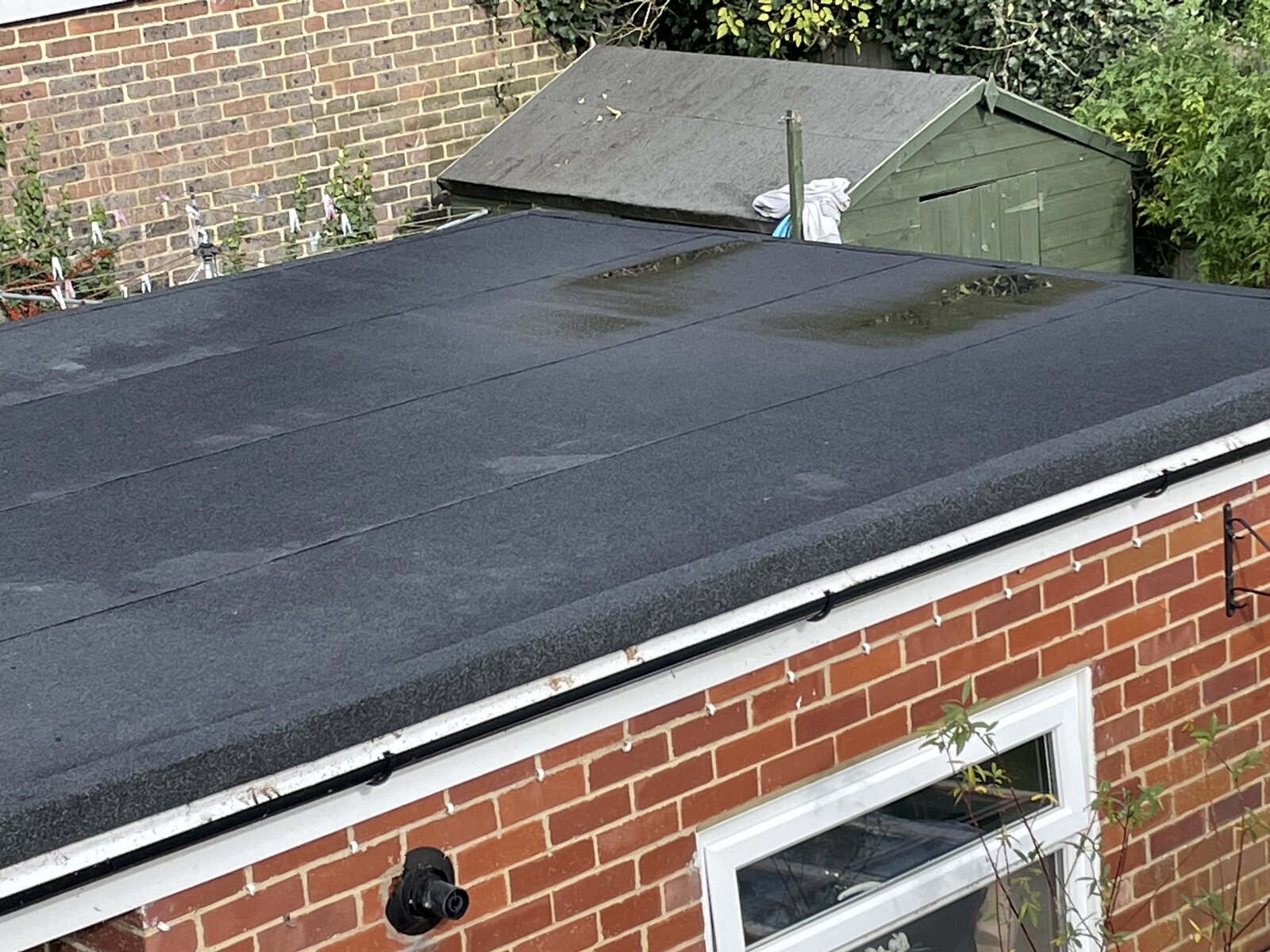

Your advice please guys,
Recently had this new flat roof laid which i am happy with & i do trust the roofer who did the work but your advice on the this standing water please?
It hammered down 2-3 hours ago & the puddle was twice as big one hour ago, if it doesn't rain again today maybe the water will disburse tonight
Is this ok?
What is that on the roof where the water puddles are, was it holding the water back.
Looks like the drip edges on your roof are the wrong way round , they should be under the capsheet (top layer )
