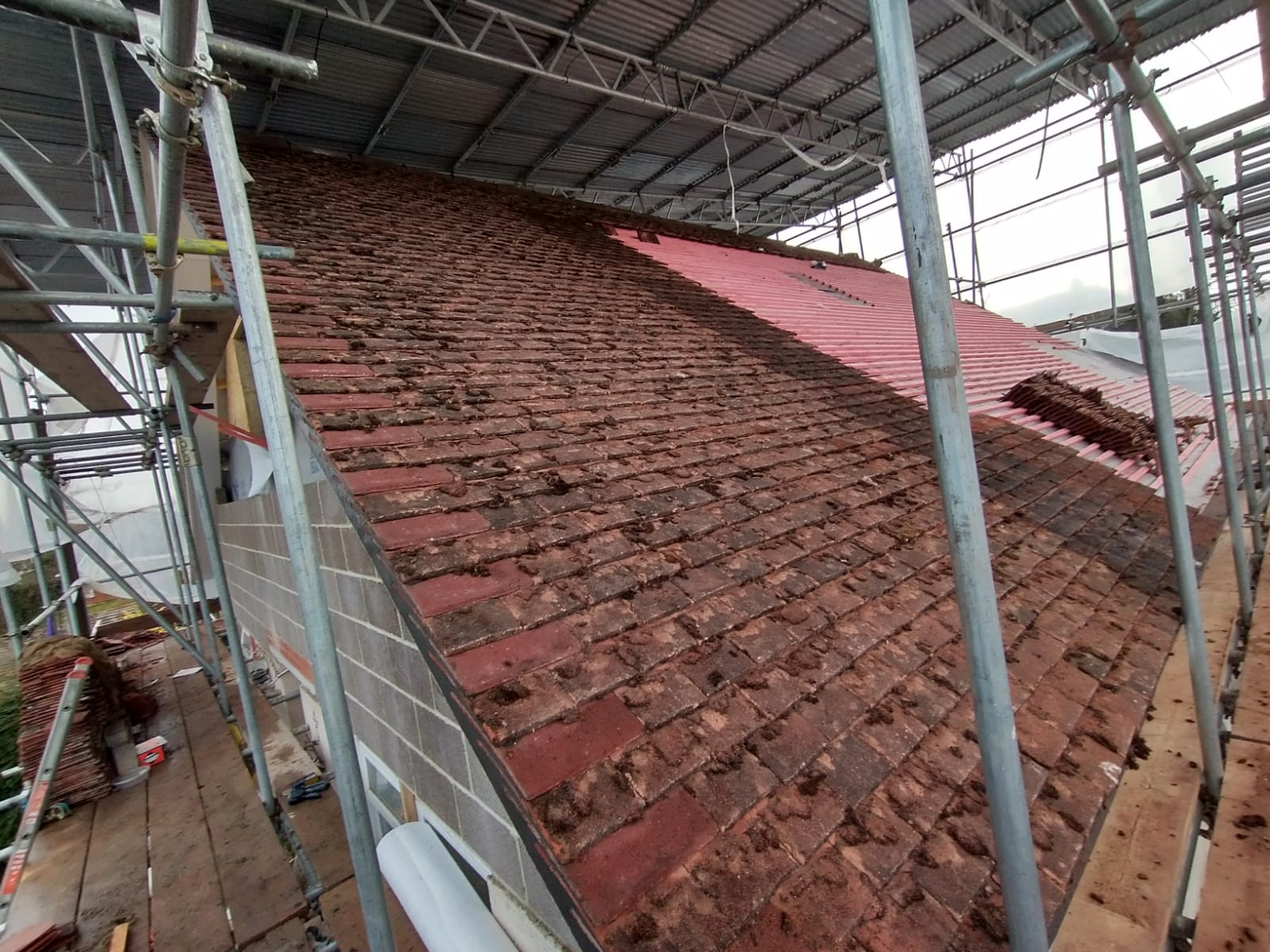

Hi we have had our front and back gable built up.
The nature of construction will be 20mm render/100mm concrete blocks/50mm airgap/13mm osb /4x2 studwork/80mm celotex 13mm osb x2/vapour barrier/plasterboard/skim
Now I asked my bricky if he needed 50mm cavity batts, to which he said no.
Just had a conversation with chippy who was here when the building inspector was here and he wanted cavity batts.
Confused. Com
You can't have cavity bat insulation on a timber frame, the frame needs a clear ventilated cavity.
