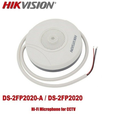

Can’t seem to find any mics. Are these Hik or aftermarket?
Look at the manuals for the camera's with an S, they should have information on how to add a microphone, to be fair never added one.

If the camera doesnt have the ability to add a microphone directly to it, then you would have to go back to the NVR potentially, or record the audio separately but starting to get more difficult to manage.
Nothing about the microphone. Just says make sure it’s connected and working before installing.
