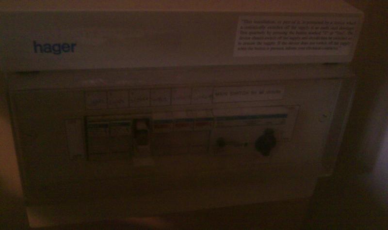

Hello
We are looking at re-fitting our kitchen we have been given 2 sets of advice regarding Part P and RCD requirments. At the moment, our consumer unit has 1 RCD switch which protects *ALL* rings on the CU - so if something causes it to trip - ALL the power goes out in the house. Each ring is protected by a fuse.
I know that the kitchen falls under Part P, so that moving sockets, adding additional sockets to an existing ring would require it to be re-certified and thus RCD protected.
I have been told that we will either need a new consumer unit (with RCD protection per individual rings) OR an individual RCD box for the kitchen.
I have also been told that the consumer unit we have should be more than enough due to all rings been RCD protected already... I can see where he is coming from but was unsure if this was correct?
Can anybody advice if we do need a "new" RCD protected ring for the kitchen OR if our existing CU with a single "protect all" RCD would be enough?

All of the following answers assume that the RCD is a 30mA one.
Whoever told you that was either ignorant or was trying to scam you for extra work.
It was.
It complies with the regulations which apply to the work you're having done. It doesn't comply with the ones which look at your installation as a whole but you aren't doing a rewire or replacing the CU so they don't apply, and there's no requirement to bring old installations up to date.
But if the RCD is not 30mA you will need a new CU or a separate RCD for the kitchen. And then the same for any other modifications you make in the future, so the former would be better.

Just taken another look at the CU - and it has 1 ^ n 0.03a (the ^ is a triangle) so am I safe to assume that it is a 30mA trip or is this mark representing something else??

That's a 30mA RCD, so it will be fine, and will comply with the regulations for protection of sockets and concealed cables.

awesome - thank you very much for your help - should be able to filter out those kitchen suppliers who want to drain additional money from me for work thats not needed :)
