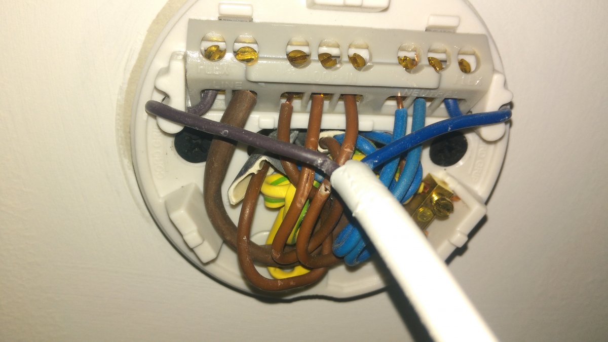

Previously done a light with 2 wires on the loop now there's 3 as my picture shows need help how to connect this to New light guys I show the existing ceiling light rose and new light I wish to install
Switched live in the L
Neutrals into the N
Earths I into the earth (middle term)
Loops into a separate connecter.
But...
restrip them first as they have got a load of nicks in them!
//www.diynot.com/wiki/Electrics:Lighting-Rose
But what I really cannot understand is, if you've successfully done this before when there were 2 loop conductors, why on earth can't you do it when there are 3? What difference can it possibly make?
thanks i m a bit clear now with the diagram , i dont have any give in the cables can i tape up over where i see the nicks in the cables ??
Inspect them to see if the copper is damaged. If that's ok you could sleeve them with brown heat-shrink sleeving.
If you can't get them to reach the ternminals on the new fitting you will have to do a joint within the light fitting, with a new piece of cable linking the light and the joint.
