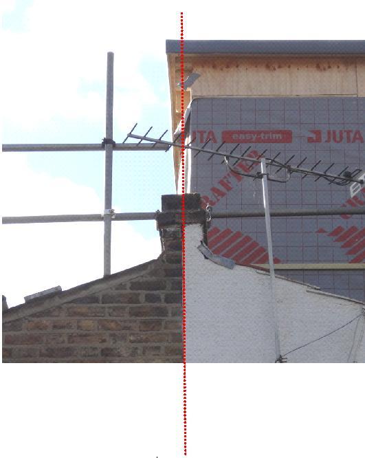

So we're half way through getting our loft built by one of the big loft companies.
We've just had the roof done in that fiberglass stuff and the neighbour has noticed the roof overhangs onto his half of the party wall.
Its best to see the photo attached, which the neighbour has provided from ground level illustrating his point. Note we're the white house on the right.
Basically we chose not to build up the party wall, instead placing the new timber wall on top of the existing brick party wall. The inside edge of the timber wall is in line with our edge of the existing party wall, and the outside edge of the timber isn't even at the halfway point of the party wall. However once the battens and tiles are on the outside of the wall, they will most likely be over the halfway point, but still nowhere near the neighbours edge of the party wall. The roof obviously has to overhang the tiles to complete the weather proofing, clearly putting the roof overhang over the halfway point of the party wall, but not actually completely to the neighbours edge.
Its my understanding that while the tiles and roof overhang are indeed over the neighbours side, if/when he comes to do a loft conversion these are simply removed, his new dormer wall attached to mine to make one solid wall and the roofs sealed together, whether or not they're at the same height.
Basically he wants the overhanging roof cut back, I mentioned that I thought that would simply happen at the time of his own loft going in but he thinks that unlikely.
The builders doing the job, who apparently are one of the best teams for this rather large loft company say they haven't had a complaint like this in 20 years of doing the job.
I know nothing about it all but am stuck in the middle at the moment.
Question is, is this normal for the roof to overhang the party wall?
The actual structure of my dormer wall is on my side, the only thing using any of his space is going to be the tiles and part of the roof, which would be removed (or used as part of his roof) if/when he does a loft conversion anyway?
He's worried he'll have nowhere to build his wall and therefore nowhere to build his roof and doesn't want to be restricted into matching my roof height (which is as high as we could go and is still only inches above my head!)
Is neighbour worrying over nothing or has the builder done something crazy here?
Advice would be helpful!

Yes we have a party wall agreement with them unfortunately it doesn't mention any overhanging roof as neither of us were aware this would be the case, although thinking about it now it should be obvious ... if the wall is built to the half way line, the roof needs to overhang the wall slightly, so clearly the roof overhangs the halfway line too.
Would that not be normal?
If we ensured the roof overhang only comes to the halfway line, that means the wall has to be back further (reducing the floor space in the new room) and that would mean there'd be a gap between it and any new future opposing wall in his future dormer no? (ie if my roof overhang can only come to halway, so must his, pushing his wall back as well).
If the boundary is at the centre of the party wall, then you have built over the boundary, and if the neighbour hasn't consented, you can't do that - it's a trespass. In my inexpert opinion, the neighbour is right.

You are not legally allowed to overhang the boundary, the centre of the wall. When he comes to do his loft you may have moved house or just changed your mind and why should he pay for the cost of adjusting your roof when that time comes, which it may not anyway? And then if you were to move and he joined on to this he may well end up being responsible for the waterproofing of that which will inevitably come back to him if there is a problem. It may also be a problem if he sells and the new owners are unhappy with the overhang either. Your loft conversion boys are Muppets.

The diynot thread merely states that everything should be agreed in writing which is fine. But you don’t seem have this agreed in writing, that you can oversail the centre of the wall and that it will be acceptable for your neighbour to attach to your wall.
The morrlaw summary also states that that decision did not constitute a precedent and that each case would be looked at.
When all’s said and done, get your agreement between you and your neighbour drawn up legally in writing and then rest easy.

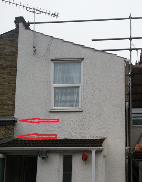

I think I'll probably point out to him the existing and quite similar situation with his ground floor extension and its roofline being higher than the original utility room bit on ours. There seems to be an overhang there. An overhang that doesn't effect us in the slightest and would just be cut off if we extended similarly or larger... obviously.
I think I'll probably point out to him the existing and quite similar situation with his ground floor extension and its roofline being higher than original utility room bit on ours. There seems to be an overhang there. An overhang that doesn't effect us in the slightest and would just be cut off if we extended similarly or larger... obviously.
Exactly the same would have applied to that overhang, had the person living in your house raised the issue. Perhaps they did, and it was agreed. If not, and it's been there for 20 years, it has a prescriptive easement, meaning it's acquired a right to be there. In any case, two wrongs don't make a parsnip, and the legal position is quite clear.
