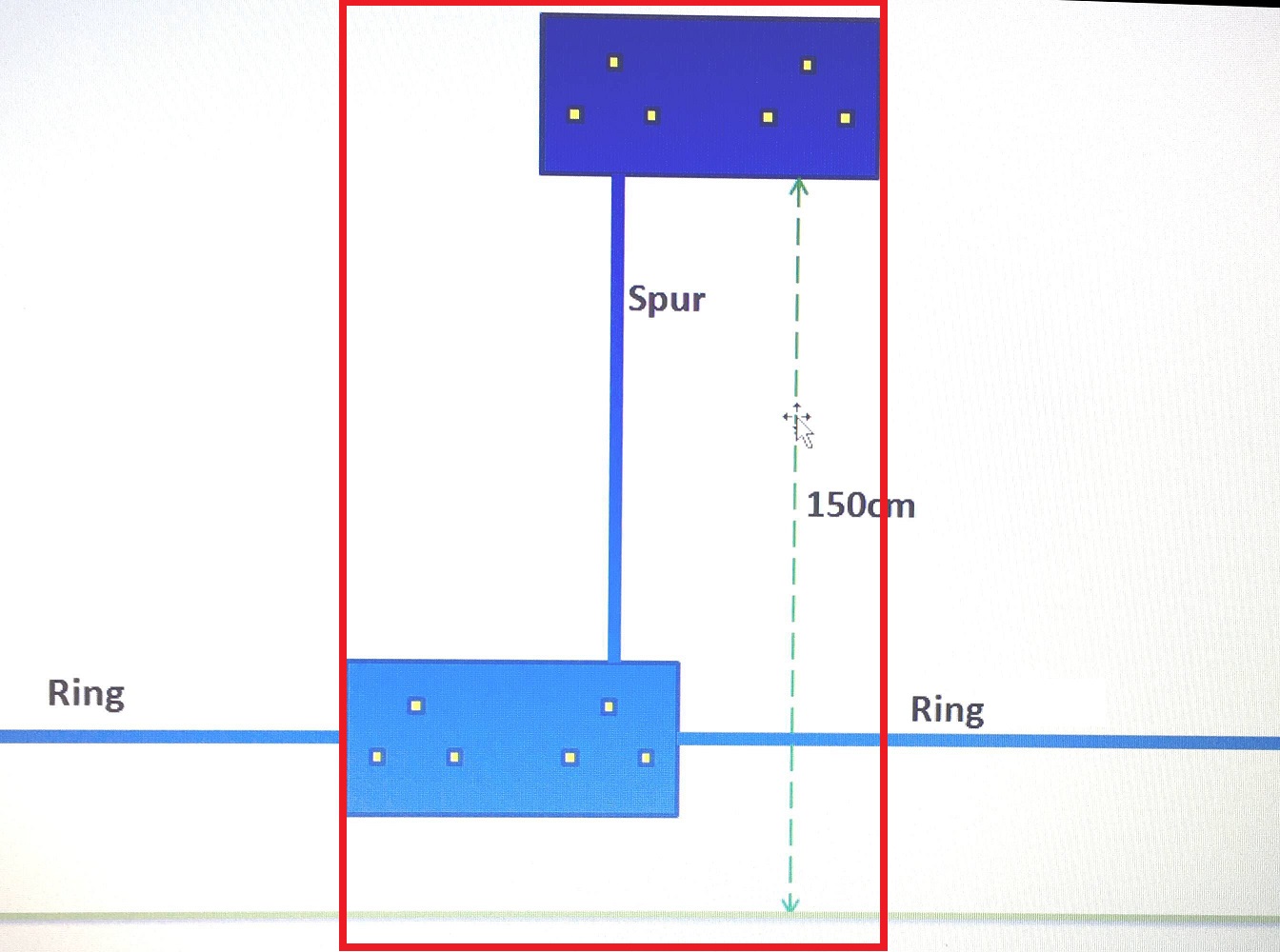

See pic, ...is this acceptable?;
The spur cable will run vertically up the wall but the new double socket for the TV will be slightly off-set. :unsure:
is this acceptable?
Yes, fine, the vertical 'prescribed zone' shown(formerly 'safe zone') would actually cover the width of both double sockets, as the cable is connected to both accessories...
edit: the higher socket can even be further right if you need it to be, with the cable having a 90° bend in it, because the higher socket will create a horizontal zone of it's own, which joins the vertical zone of the existing socket. I wouldn't do it that way personally, but it is allowed.
