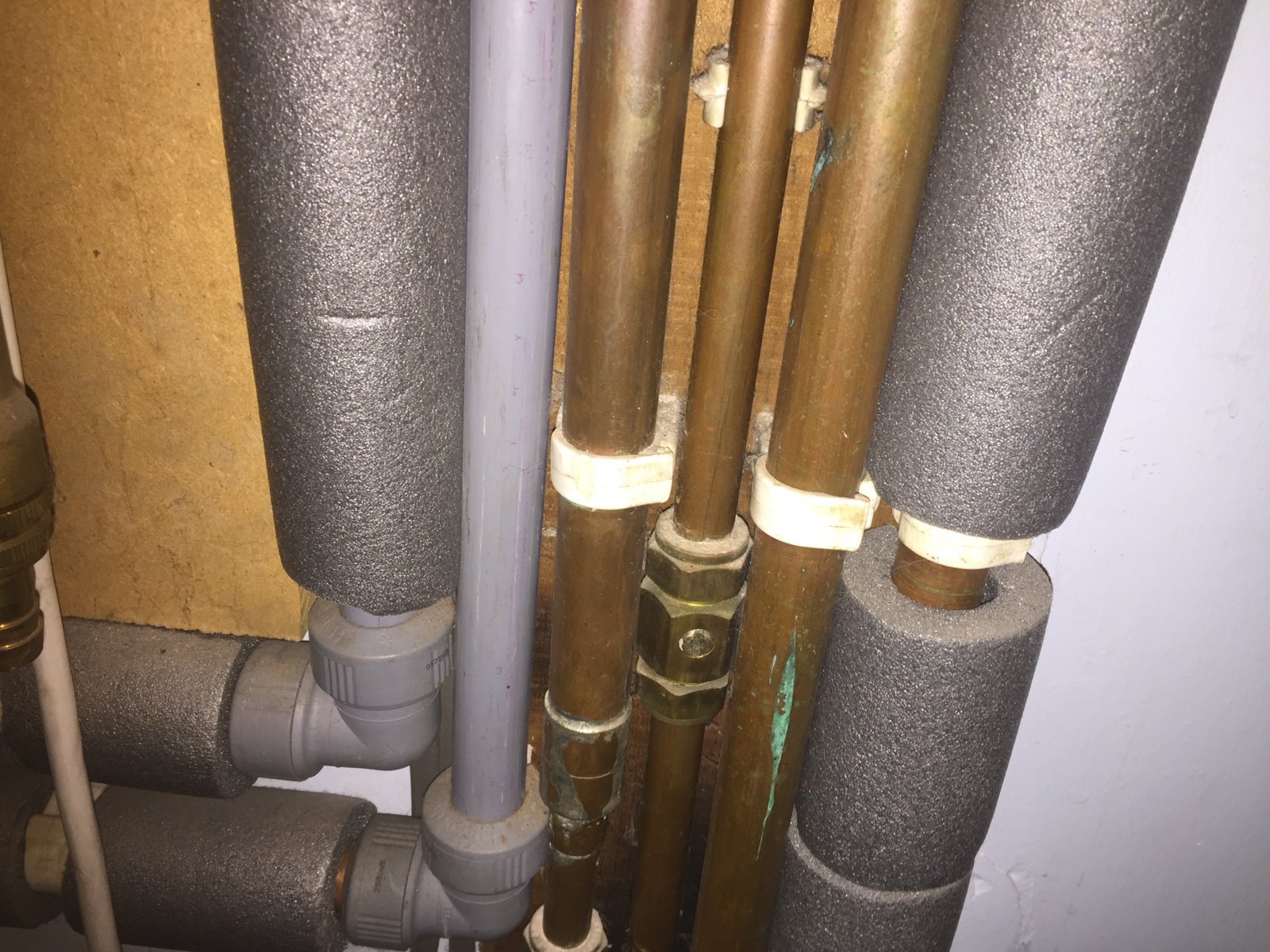

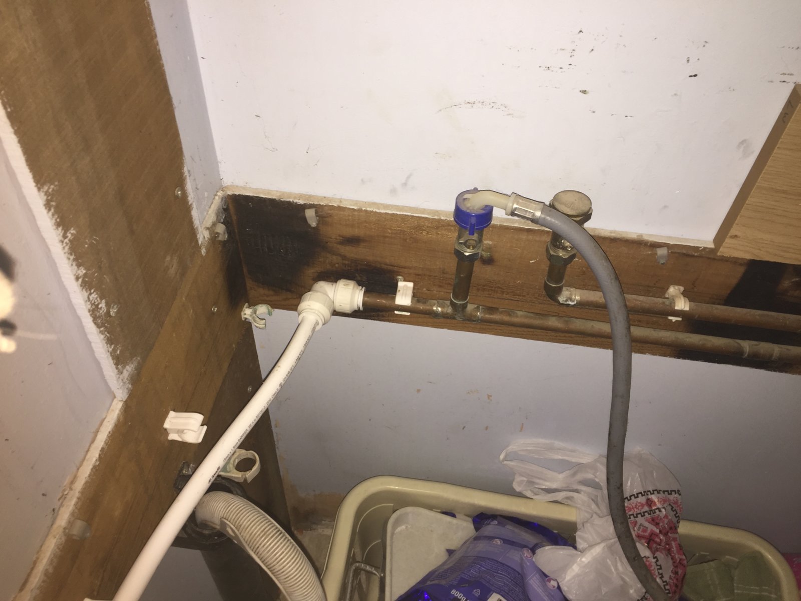

The cold feed now comes in at the rear of the house and fits onto the cold feed tee'ing into the washing machine. After this i have a check valve which is compression and then another about another 70cm further up the piping. All this is in the big cupboard downstairs which is a mini laundry. I haven't checked these valves, but i wonder if these could be a problem ? They are older and required a flat headed screwdriver to move them. I can get a photo if needed.

can you show us a pic of these valves?

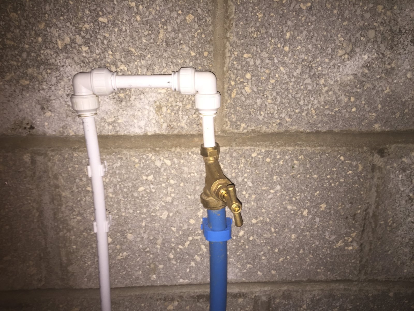

What size is the stopcock?

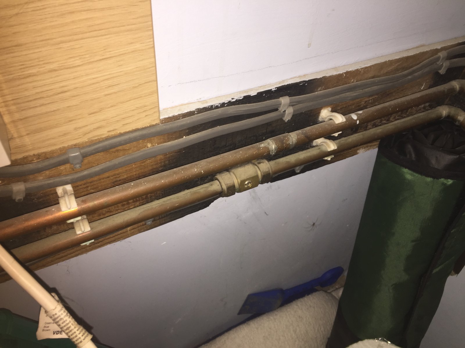

Pics of:
1) the stop cock
2) Where the 15mm of new plastic water feed connects to the older copper work.
3) The isolator just along from the T for the washing machine

the appliance isolators don't matter, all they do is restrict flow into the appliance.
I don't understand the purpose of the check valves (I am not a plumber). Are they intended to prevent backflow into the main, for example if a fire engine or other pump creates suction in the main?
I've only used such things on the supply to a garden hose, where the end of the hose might be in a puddle or pond or otherwise unclean.
I imagine they constrict the flow.
If they are just isolation valves, you can get a full-bore one with a larger waterway, that will not constrict flow.

Those ISO valves look as if they are full bore. The bigger issue is the drop to 15mm. Pressure won't be affected/altered unless the mains is hiked up, neither will the flow as a 15mm pipe wil only pass a certain amount of water at a given pressure per min. Multiple bends will also slow the flow.

By the looks of it those 2 valves in your pics aren't check valves, they are FB isolation valves.
Water regs dictate there would normally be a check valve just after the mains stop tap, then a drain valve but would you be shot for not having them, probably not.
