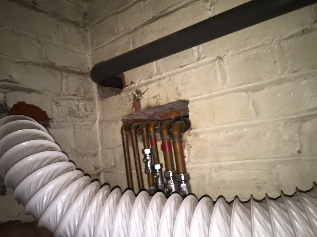

I'm getting my downstairs bathroom done. Replacing the mixer shower. The system is a gravity system, cold water tank in the loft, boiler and hot water tank in airing cupboard on 1st floor and the shower is on the ground floor. The current 10 year old mixer works fine pressure wise and is a 15mm inlet on the instructions. Shopping around for showers it seems some come with a 1/2 inch inlet/outlet and some with a 3/4 inch one. Does it matter which one I get? Do I need to match them to my current pipes? If so the picture below is taken from the extension loft space directly above the shower. Some are big some are small! Any clues what pipes I've got or do I need to wait till my fitter has ripped out the old bathroom. My Mrs already moans about the shower not being powerful enough to wash her long flowing locks so want to max out what pressure we do have!!

Best to wait until you have the pipework exposed in your bathroom Ben, that way you can be sure of the pipe sizes. Unfortunately, being a gravity system you are probably are at the max with regards to pressure and flow though that will be apparent when you fit the new shower.

In your picture, the two 22mm pipes on the right hand side are labelled "SH" and "SC". Shower hot and shower cold, perhaps? Each has an isolator, so try turning those off to confirm that they do in fact supply your shower.

Oh wow good spot!! Perhaps should have looked at the picture before asking you guys!! If these are indeed my shower pipes would this point to getting a 3/4 inlet/outlet shower and therefore maximising my shower's pressure?

Certainly, if the shower is supplied by 22mm, which is ideal to maintain flow in a gravity system, then it will be a 3/4" bsp inlet shower you'll be looking for.
As gas mentions tho, make sure you are buying a shower designed for a low pressure system.

Sorry Ben, that's a medium pressure mixer, you have a low pressure system.
I thought you said that the current shower has 15mm inlets? If so they that 22mm reduces down to 15mm somewhere so that's the size of shower inlet you will need. I'd wait and see what the inlet pipework is when the old shower's removed.
