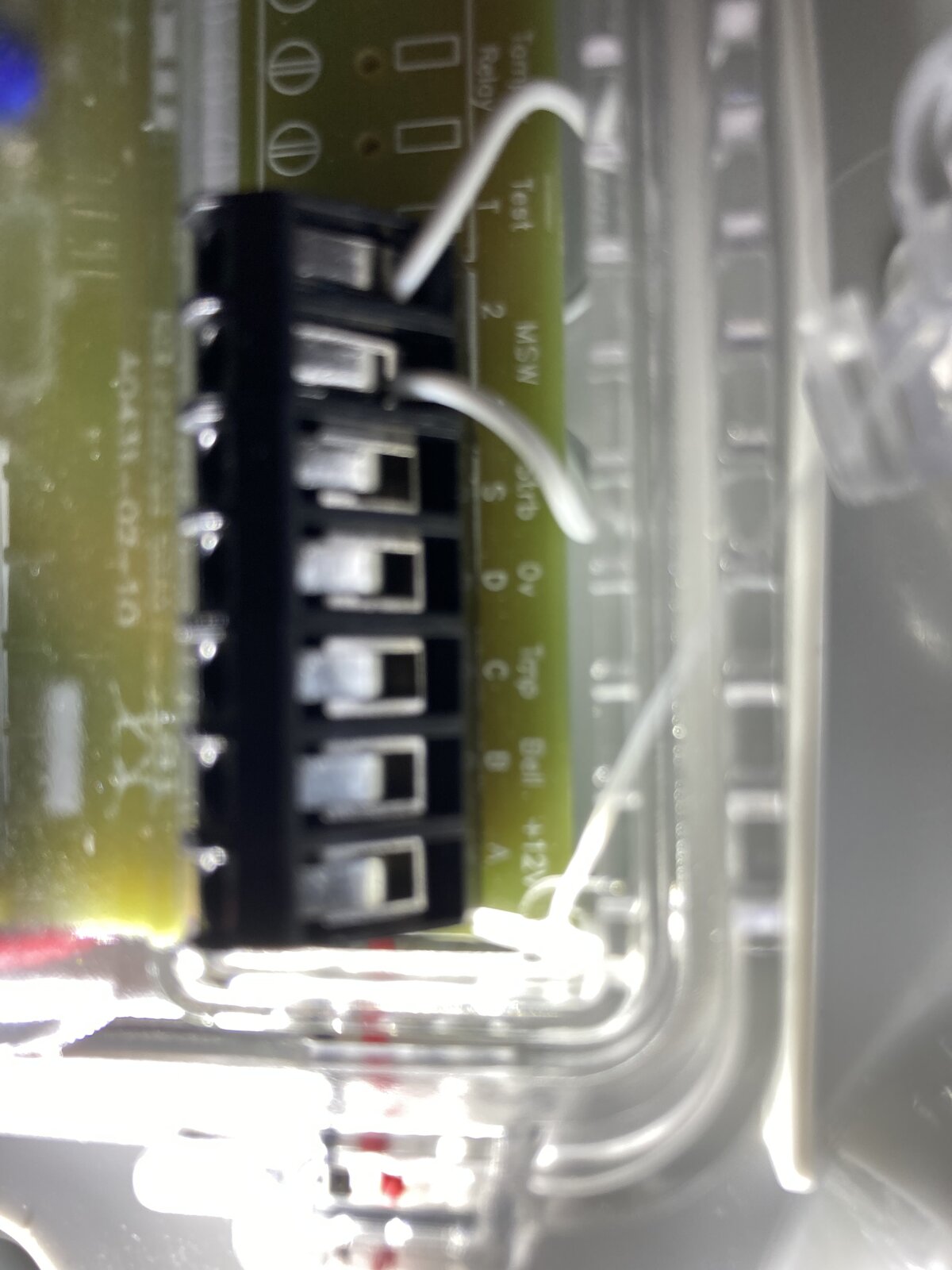

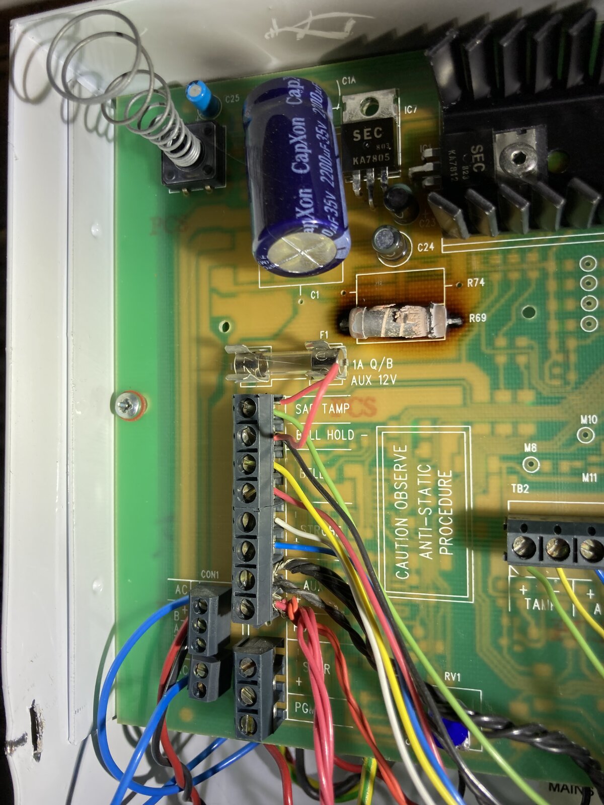

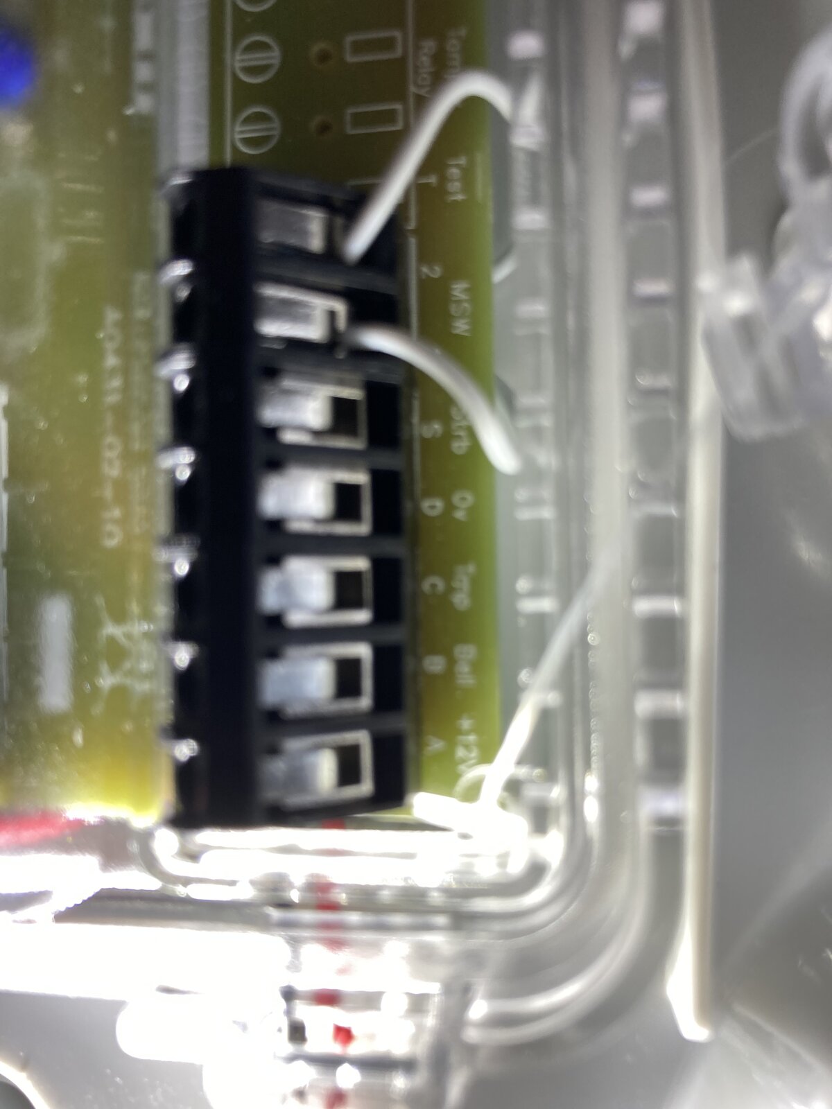

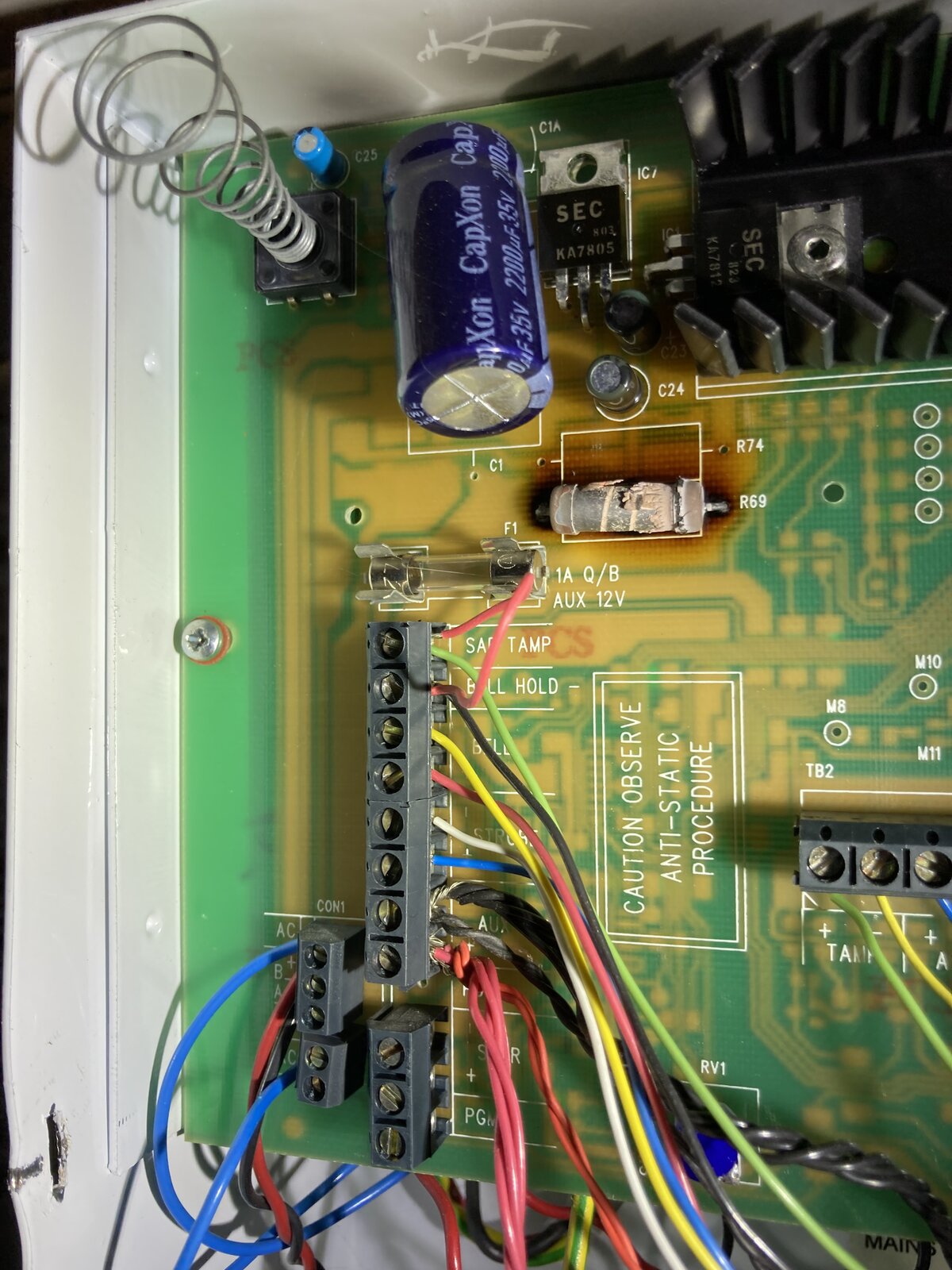

Hi Guys
Finally got around to changing system over to Texecom Panel as recommended by Sparkymarka and first step is new bell as weather dry - so going from old bell to Odyssey 3
Wiring in existing Gardtec panel shown along side terminals on new Texecom Bell - At this point if all I have is lights /strobe on bell thats ok as will change panel at a later date when wet and windy outside but for now just new bell,
Advice welcome and thanks in advance
Derek
Bell Hold - goes to D 0V
Bell - goes to B Bell trlgger
Bell + goes to A 12V
Strobe- goes to S strobe
Tamper goes to C Tamper
Looks like you have had a bell tamper issue as the panel is linked to 0Vuf I read it correctly which effectively pulls the tamper registering at the panel end
Thank you secure I am - spot on.
Turns out the little fuse on panel had blown too…..
Little light flashes and I think if I set it we should be good.
Can’t thank you enough.
