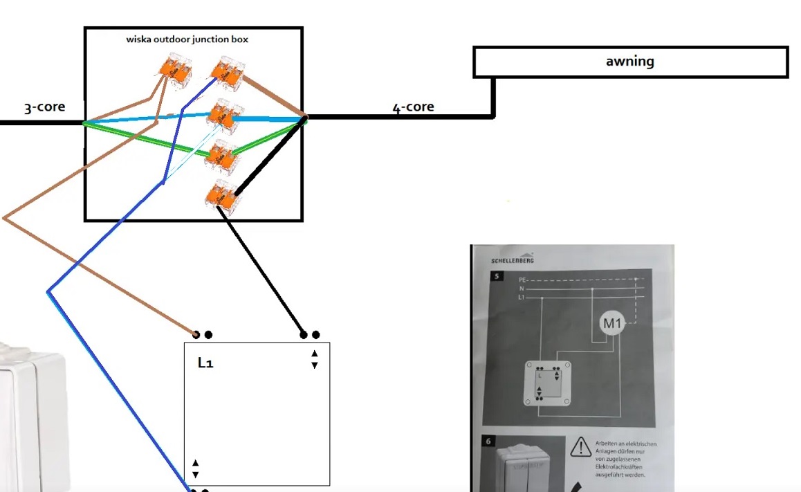

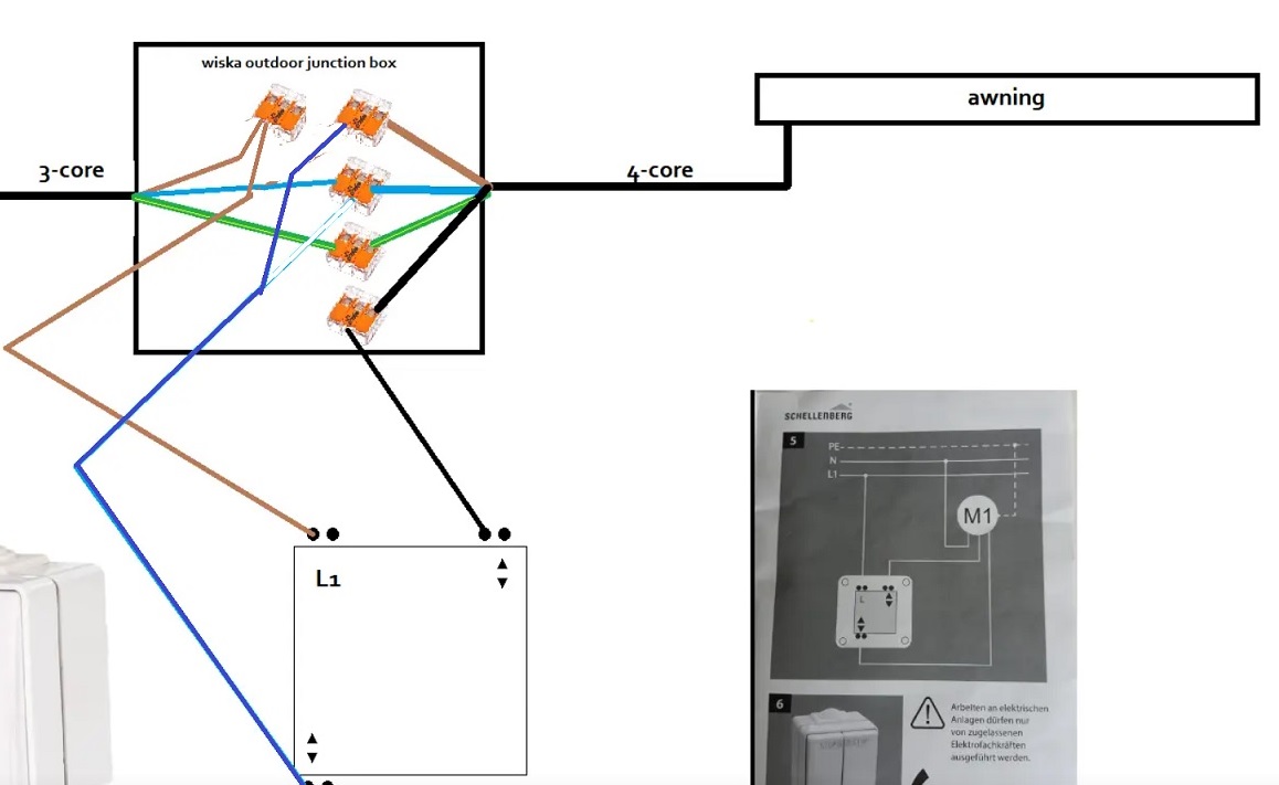

I've just installed a new full-cassette motorized awning from Primrose awnings. It seems to retract ok, but when I try to extend the awning outwards, it's making a buzzing noise and blowing a fuse when I try to extend it.
I spoke to Primrose, and they're telling me I need to confirm it's been wired correctly before they can proceed.
I purchased a Schellenberg 25010 Awning Switch for Outside Installation switch from Amazon to control it, which seems to get plenty of decent reviews. The instructions were in German but I can't really see how I could go wrong.
In terms of wiring, I wired it as follows using wago 221's:
Would someone be kind enough to confirm this should work as expected, and that I'm not missing something obvious? I'm inclined to think it's a faulty motor, but want to be sure it's not something I've done! :giggle:
cheers
thanks Pete, I think what's confused me is that Primrose show all wires going to their own brand of awning switch (which I didn't purchase) which then goes to mains power. The Schellenberg switch was half the price so went with that instead.
So do I only have the live and the black wire going to the switch?
The brown from the plug goes to L1 in the switch
The up down goes to brown and black on the 4 core (motor)
Neutral from plug straight to 4 core (motor)
just tried it and it worked! :giggle:(y)

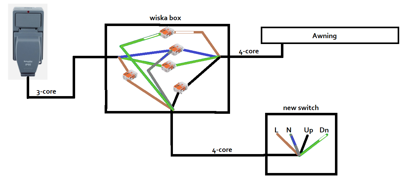

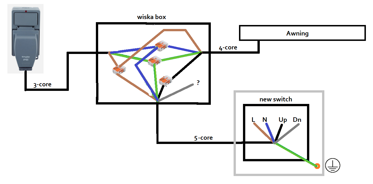

I decided to "upgrade" the switch to a fancy one that includes Amazon Alexa so that we can say "Alexa, open awning", etc, but noticed this new one requires the neutral wire.
Would the following change to the wiring be correct?

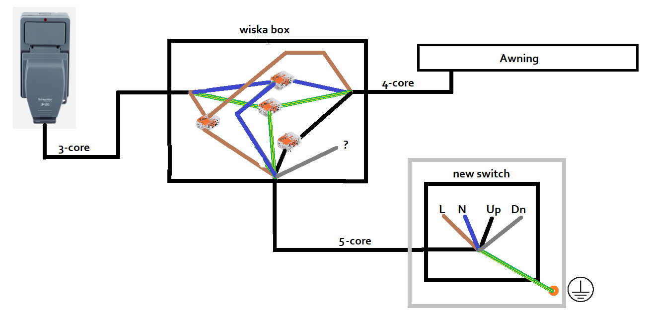

You should not use the green/yellow wire for anything but Earth, Even if the new switch does not require an Earth the operate the cable to the new switch has Live wires and thus requires an Earth conductor in the cable.
Use 5 core cable ( 4 core + Earth )
Your brown wire from the 3 core plug should not be directly connected to the Brown Awning wire.
Your above wiring diagram connects Mains LIVE permanently (all the time) to the Brown Awning Wire, meaning Awning will try to go Down all the time.
To fix this, in the wiska box, the Grey switch wire (carring Switched Live) that comes from the switch should be connected to the Brown wire going to the Awning.
To explain.
-The motor in the Awning is always connected to the Neutral.
-The Awning is never connected to live until the switch is pressed.
-When you want Awning to go up the switch connects Switched Live (via the Black switch wire) to the Black the Awning Wire.
-When you want Awning to go down the switch connects Switched Live (via the Grey switch wire) to the Brown the Awning Wire.
(up and down are assumed by me and might be reversed).

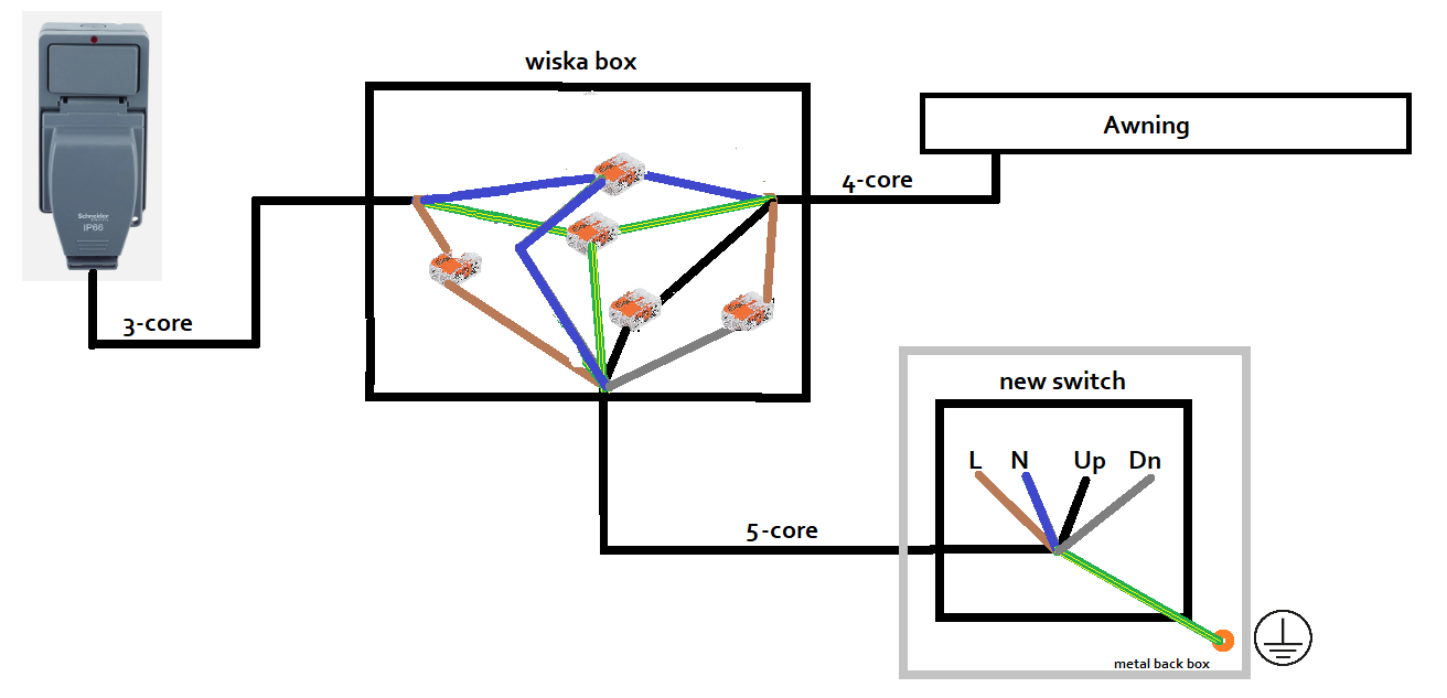

Your brown wire from the 3 core plug should not be directly connected to the brown Awning wire.
Your above wiring diagram connects Mains LIVE permanently (all the time) to Brown Awning Wire, meaning Awning will try to go Down all the time.
To explain.

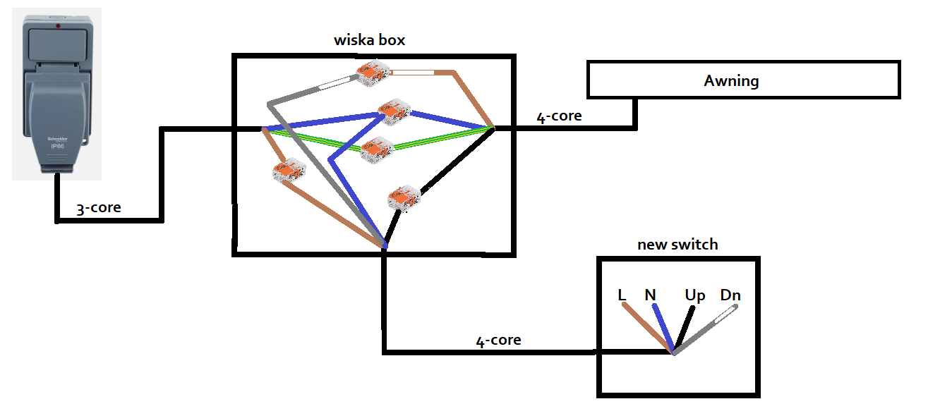

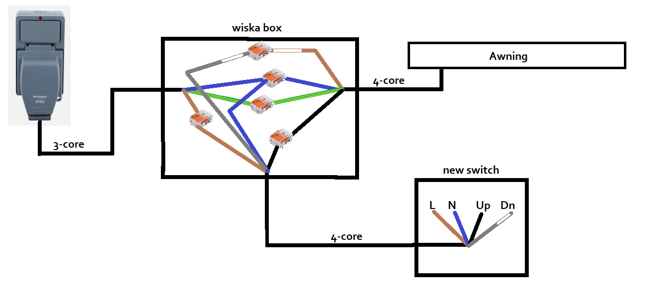

ah ok, so like this?
Yes - wiring exactly like that.
