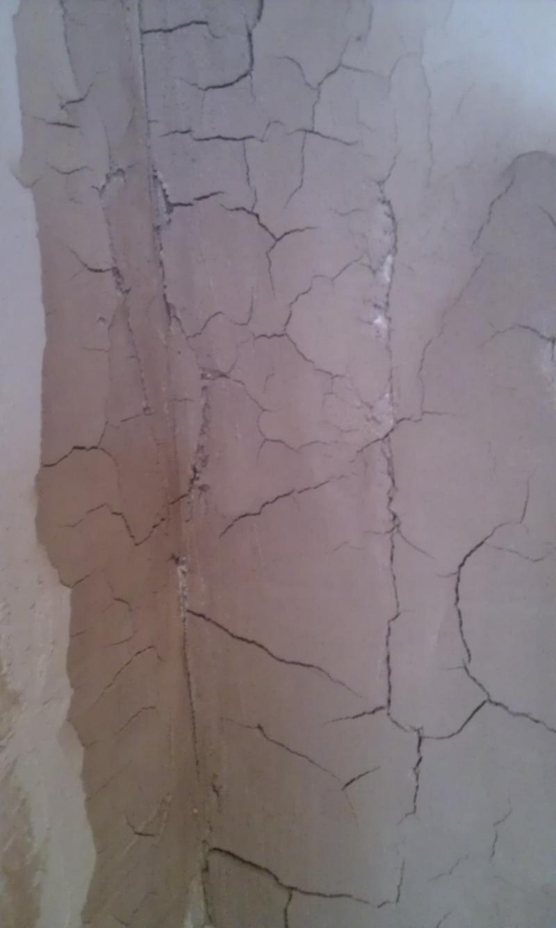

New Plaster problem
So, cement based tile adhesive. If I go down this route what is acrylic prime and how do I use it? Will it go over the PVA I've already put on the wall?

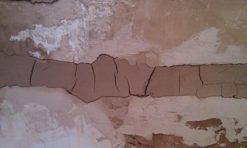

Oh dear; PVA can be a plasterers best friend but unfortunately it has no place in a tillers world & can a problem, particularly in wet areas. Standard PVA should never be used as a tile primer or in preparation for tiling, the problem is it remains water solvent & can re-activate when subject to water/damp; is this a wet tile area?
Too late now really but give the area a good going over with a stiff wire brush, acrylic prime http://www.bal-adhesives.co.uk/products/prime-apd (or similar) & then fill out with Rapidset tile adhesive a couple of hours before you tile. The area you have is not particularly large so, hopefully, you should be OK but you haven’t said what size weight tiles your using?
Before you move to the tiling stage of your project (preferably even sooner :wink: ), I would advise you read the Tiling Sticky & Tiling Forum Archive posts before doing any more work or buying materials, it could prevent you making disastrous & potentially expensive mistakes. Tiling/re-tiling isn’t rocket science but there are still many things that can catch you out. With walls, you need to consider tile weights, prep & materials & suspended timber floors need special consideration. It’s also important to use only quality trade tilling materials of the correct type for your tiles & tile base; cheapo own brand & DIY stuff is mostly crap.
The area I have applied PVA to is where I need to plaster. Its bare brick. When I was chipping off the old tiles a chunk of plaster came away. The rest appears sound. I've tapped it and it doesn't sound hollow.
So if I apply the Prime over the top of the PVA thats on the bare brick my cement adhesive will be ok?
The cement adhesive, is it suitable for an area 40 x 60 cm?
Haven't bought the tiles yet so I'm not 100% sure of the weight but we do like large ones, around 60x30 ish.
Yes, it will be a wet area. It's around a bath.

The depth of the area I'm filling is about 1.5cm. The largest area, apart from the strips that you can see in the picture, is about 60cm x 40cm.

Hardwall it, skim then tile.

Stiff wire brush it first which will cut through the PVA & give something for the acrylic primer & adhesive to grab onto.
Rapidset addy will cover any area you want up to around 12mm thick; it’s a fairly expensive way of doing it compared to render or plaster but the big advantage is no waiting time.

adder, your options should be based on the plaster you already have on the walls, not the patch. The areas you are going to tile in your bathroom that is already plastered would have to come off if they didn't meet the spec for large tiles so it would be throwing money away if the patch was spec but the plaster wasn't and failed.....
So keep this in mind when going for the tiles. The weak link is the plaster on the walls already.
Update.
Went with the Hardwall / skim option. All went on a treat and has dried without any cracks :-)
