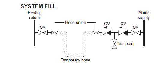

I'm looking for some advice. Our boiler began losing pressure recently and it turned out it was venting through the PRV. Brand new PRV was fitted but we're still losing pressure. I noticed it was still venting from the PRV again even though the boiler was only showing 2 bar of pressure (still in green zone) so I don't know why it should be doing that.
I'm going to get a different plumber to look at it but I wanted to get an opinion so I don't end up just having parts thrown at it again and hoping for the best. Could it really be overpressurised and the gauge is just broken? Just a dodgy new valve fitted? Anything else?
The boiler is a Greenstar 24i system, probably about 11 years old. I've topped it up and given it another run - it was showing about 1.2 bar cold, rising to pretty much bang on 2 bar before the PRV vented again.
I'm not sure if it's related (although we've had this problem since we moved in 18 months ago well before the boiler started playing up,) but our hot water cylinder also drips fairly often from the 3 bar valve to the outside pipe (Megaflow CL250). I've tried restoring the air pocket as per the instructions on the side of the cylinder, but it doesn't last long at all before it's dripping again. I'll get that fixed at the same time so any advice on that would be good too.
