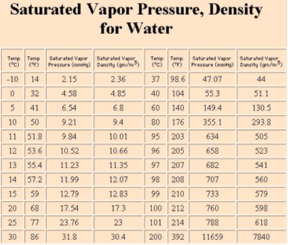

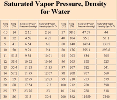

Lot's of talk here about RH. Some misconception about what it means. It is the ratio of water vapour in the air compared to the maximum the air can carry at that temperature. In a room at 22 degrees and 60% RH the relative humidity will increase as the air cools, until at some point the air reaches the dew point (100%RH) and water vapour starts condensing out.
To identify condensation risk, you need two things - a hygrometer and an infrared surface thermometer.
e.g. from the table the saturated vapour pressure at 20 degrees is 17.54mmHg. So at 60% RH it's actual vapour pressure is 0.6 x 17.54 = 10.52mmHg
10.52mmHg equals the saturated vapour pressure at 12 degrees, so any air at 60% RH and 22 degrees, will start condensing if that air is in contact with a cool surface of 12 degrees or less.
With a hygrometer find out room RH and temp. Calculate the dew point. Zap surfaces with a surface infrared thermometer, identify condensation risk.
Ventilation and insulation need to be understood in context. Imagine an unheated but insulated room allowed to cool to 5 degrees while you are away. The weather changes and it's now 10 degrees and 100% RH outside (it's raining). Open the door, let that outside air in and every surface in that insulated room which is still at 5 degrees, is now wringing wet with condensation because the insulation has kept it cold, and stopped it warming up when the weather changed. In this case, insulation worked against you.
