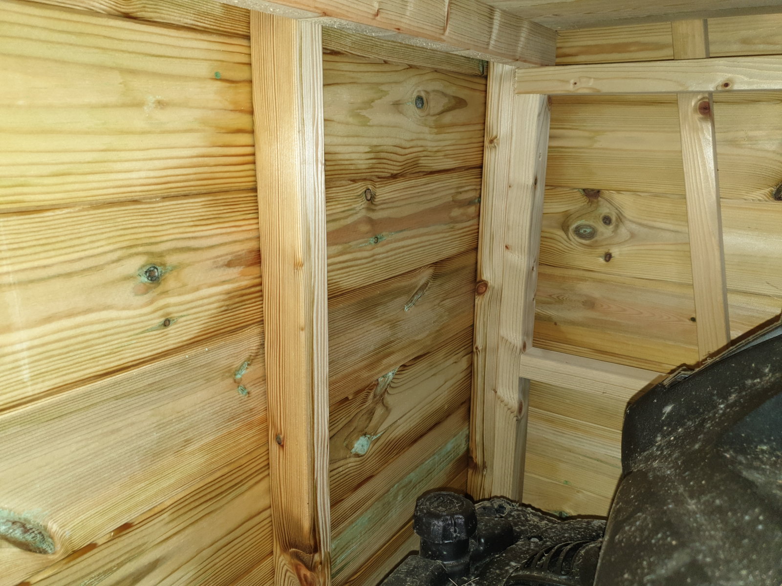

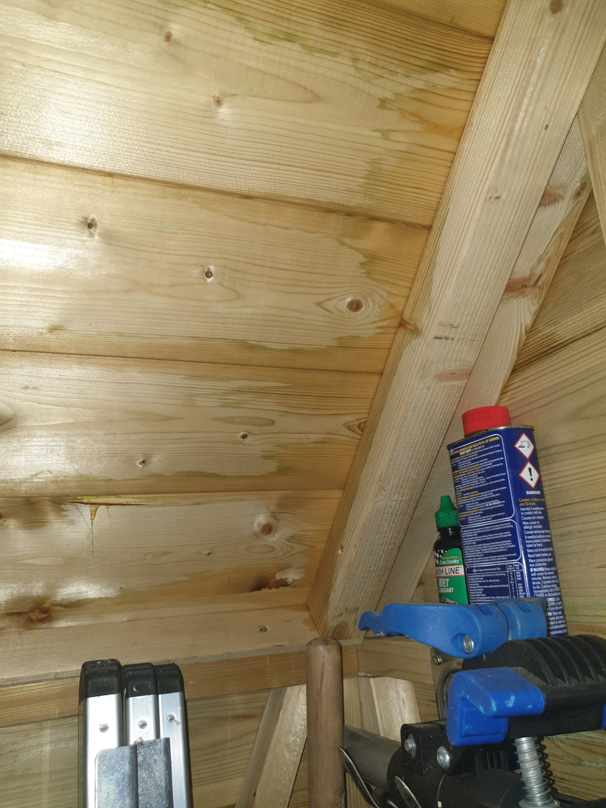

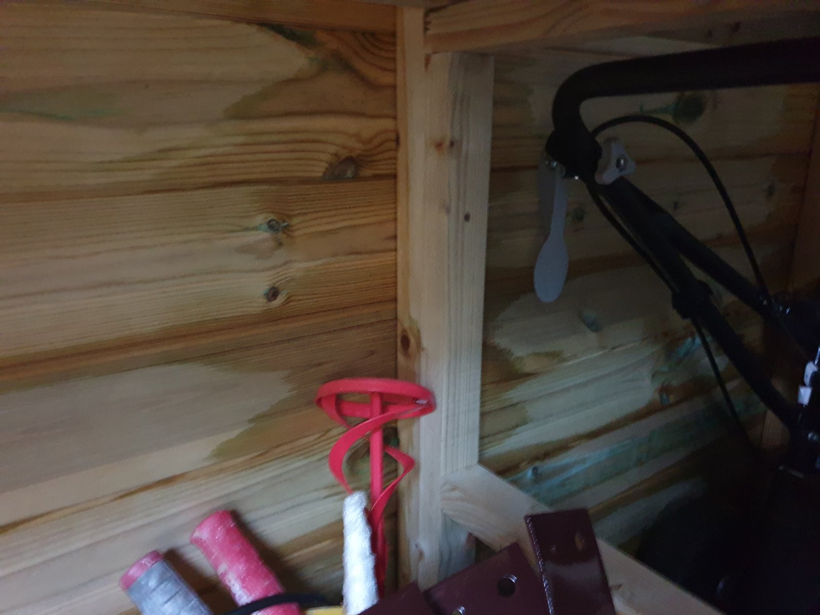

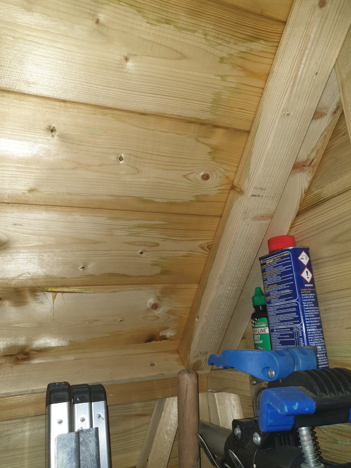

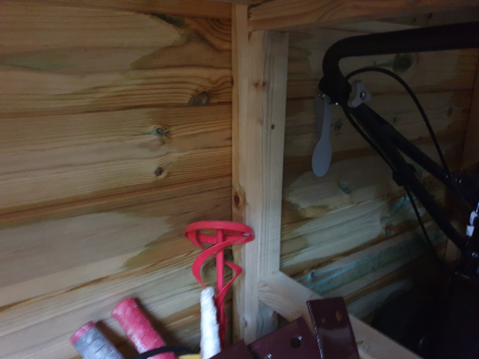

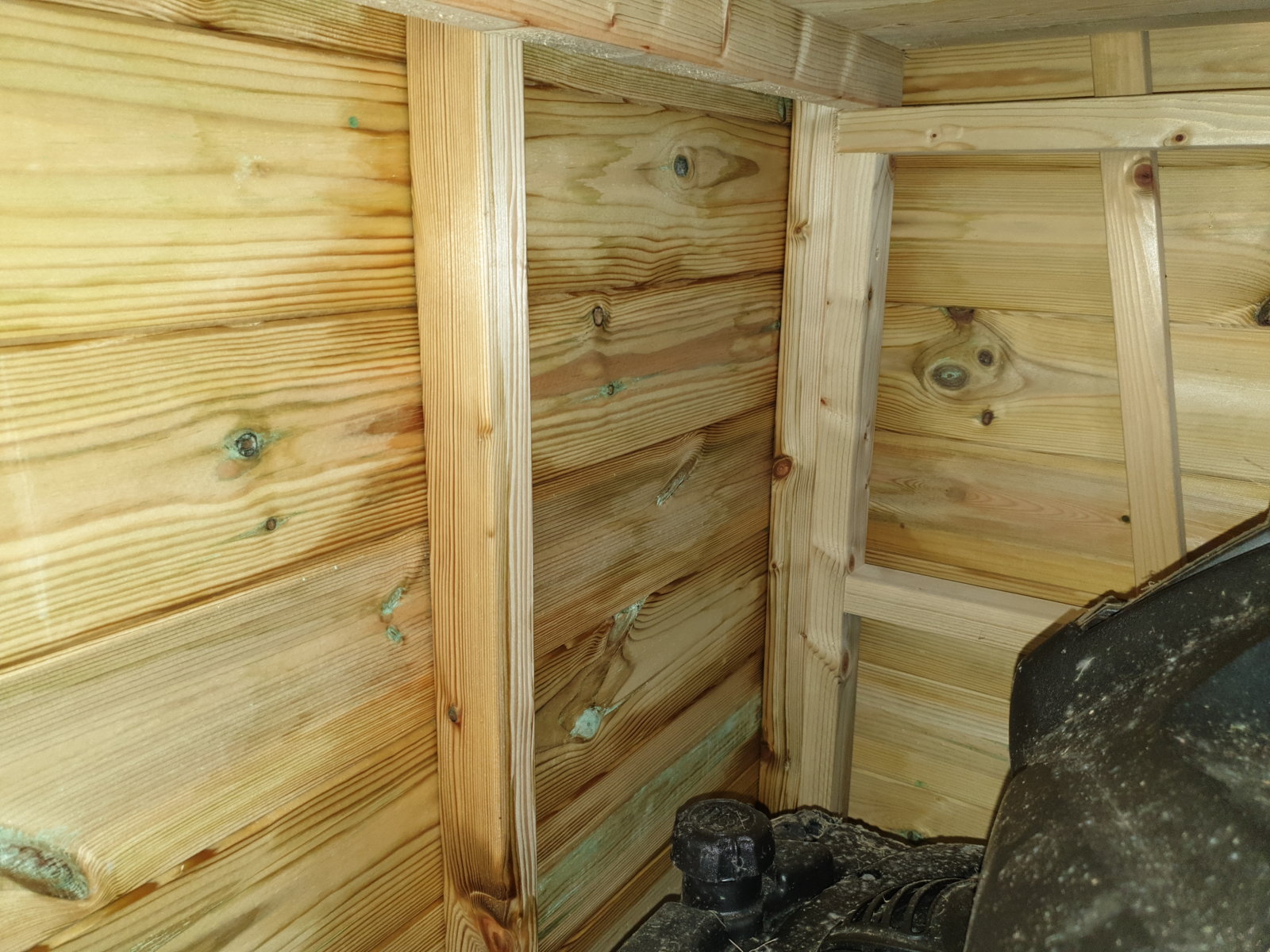

Hi,
At the end of August we took delivery of a Fort Harpford Barn shed, with 15mm pressure treated shiplap and shingle roof.

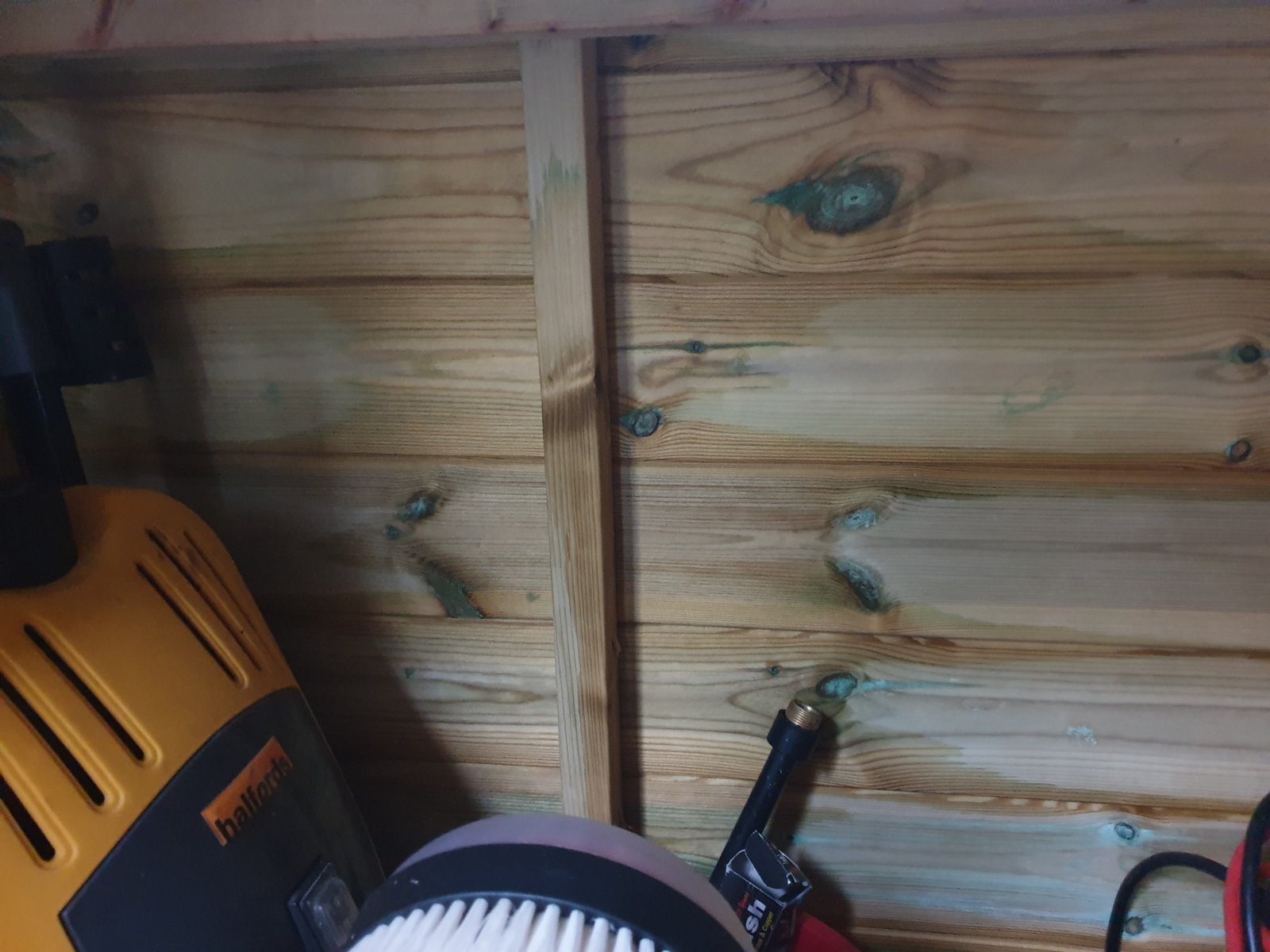

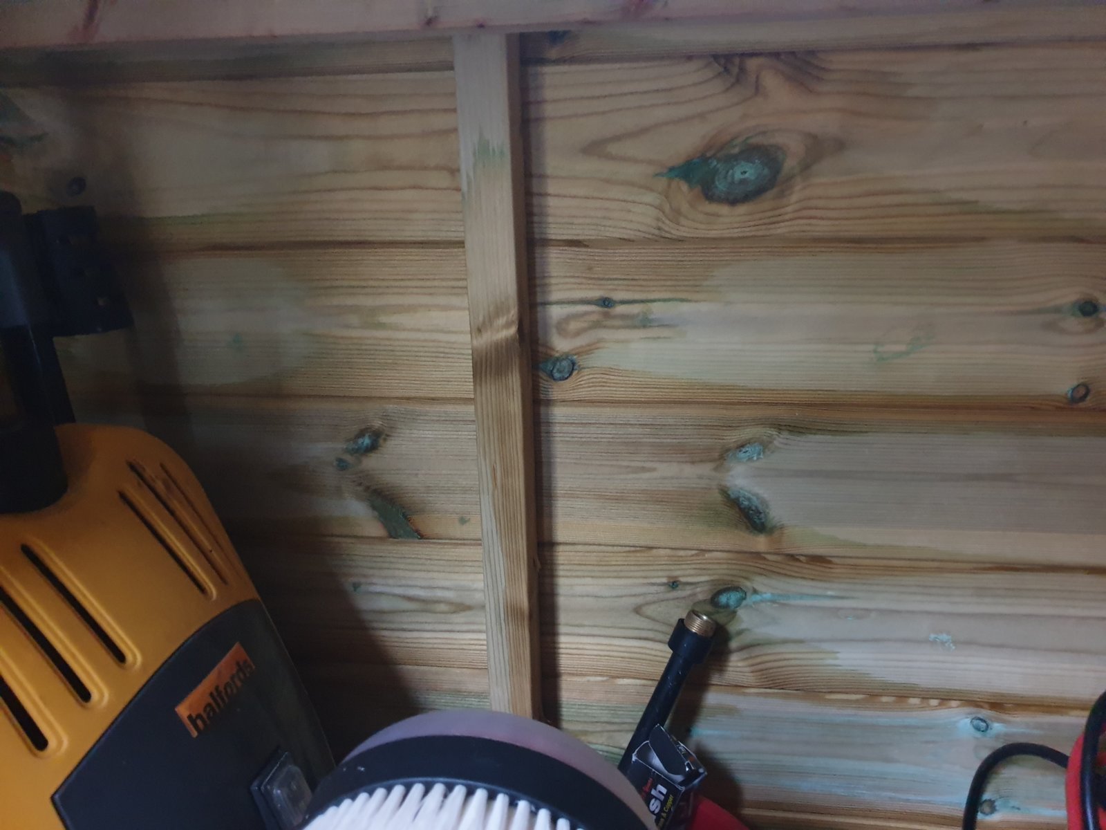

Last week I noticed water soaking along the t&g roof on the inside and on inspection found that there is no felt overhanging the edges of the roof sides and likely allowing water to enter the t&g before capillary action takes over.
I contacted the manufacturer and they admitted this is not acceptable and are coming to reflet the roof in two weeks. Which I thought whilst not ideal will solve the problem.

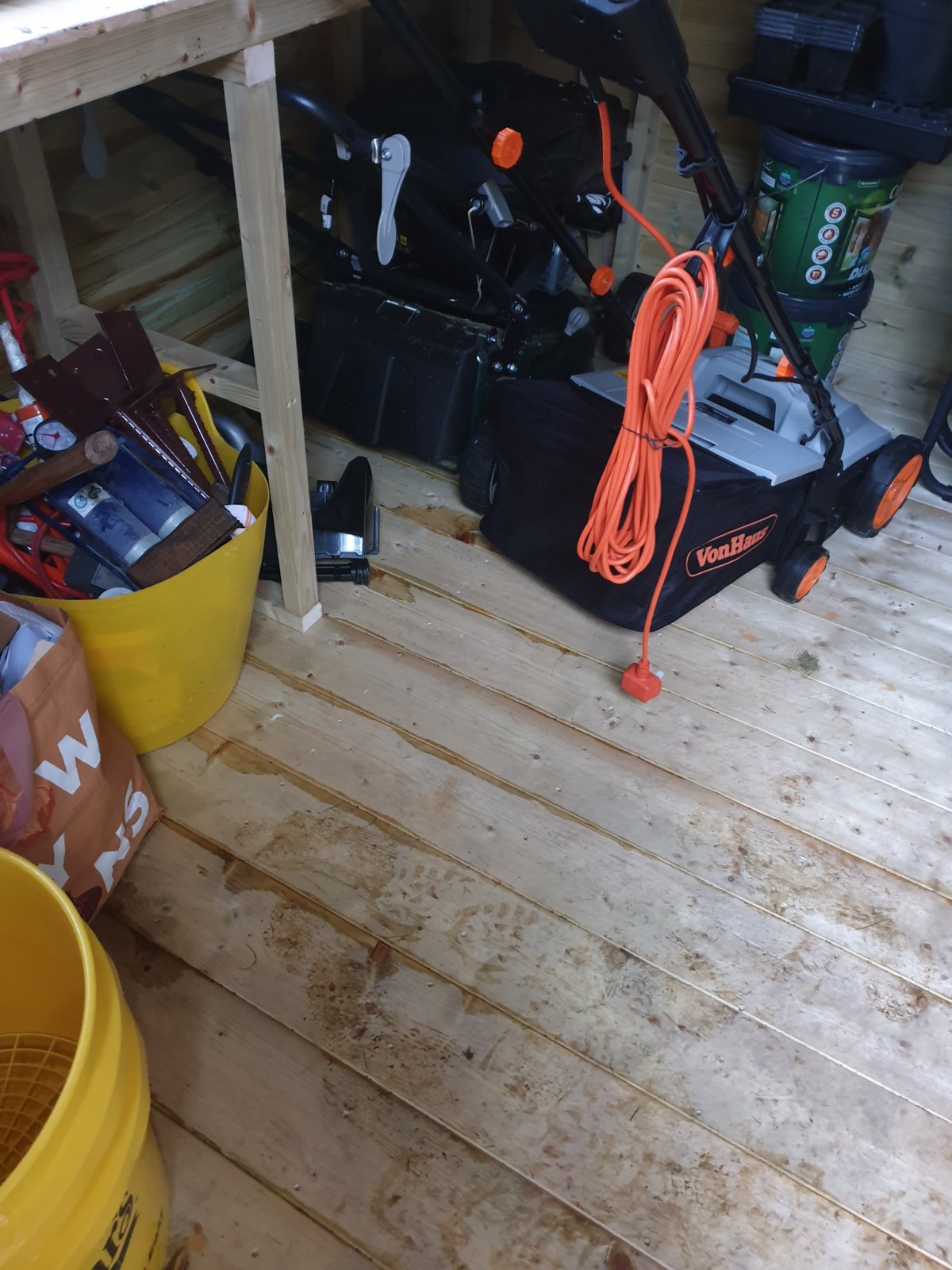

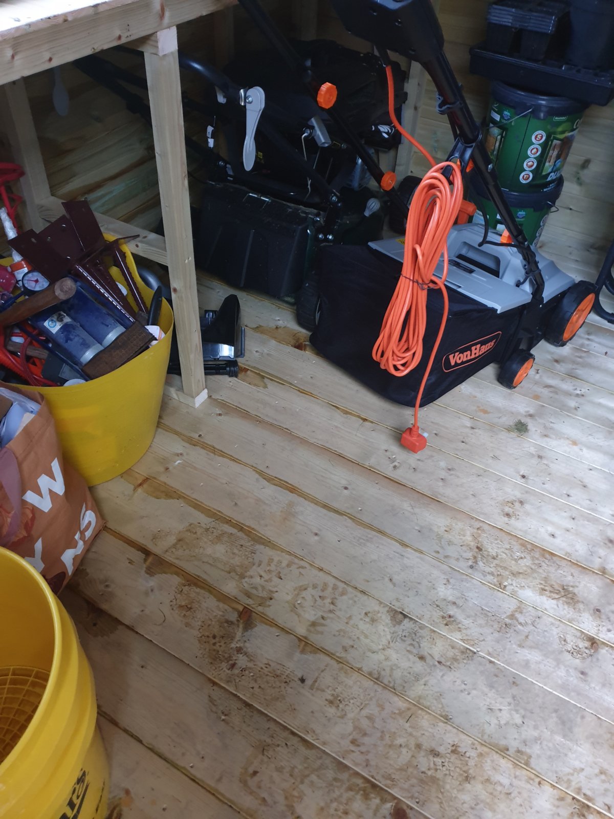

However, I have gone into the shed last night and the walls are now allowing water to get through the t&g cladding. So much in fact it's running across the floor. Given this was quite a considerable outlay I'm pretty furious.
Now I know, timber t&g isn't perfectly waterproof, but our last shed was a £400 B&Q affair with 8mm shiplap and didn't leak until it was all warped after about 12 years.
Anyone got any advice to offer? I've emailed the manufacturer again but won't get a reply until Monday. What's extra annoying is it's around 40 days after delivery, so I believe I can't now reject this building.

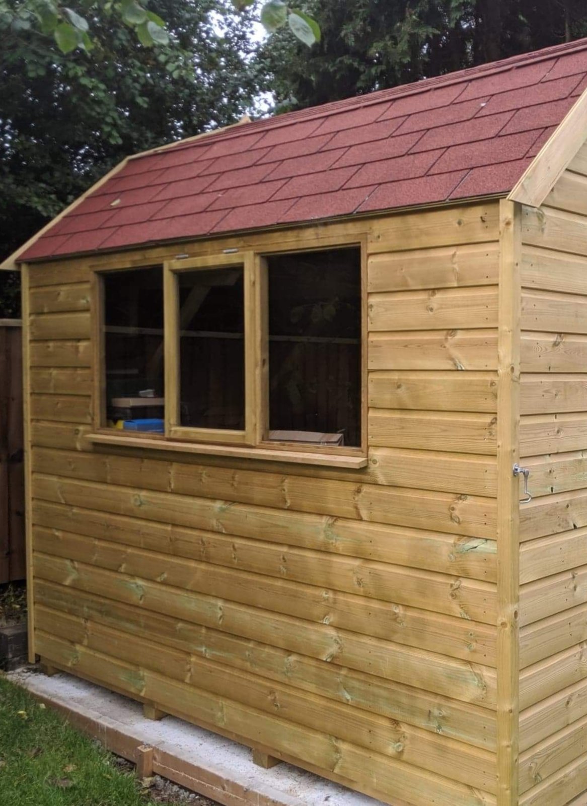

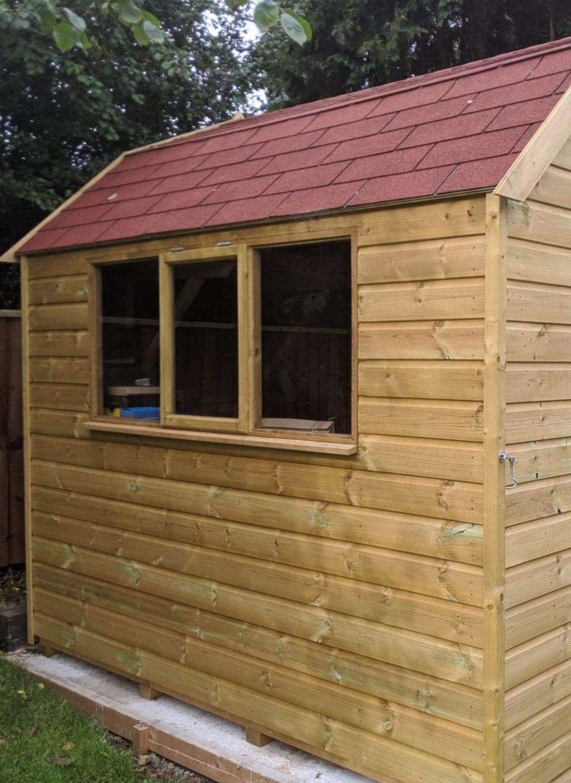

One thing I have noticed is the roof only overhangs the side by about 10mm. Wondering if this is allowing the water off the roof to run down the walls.

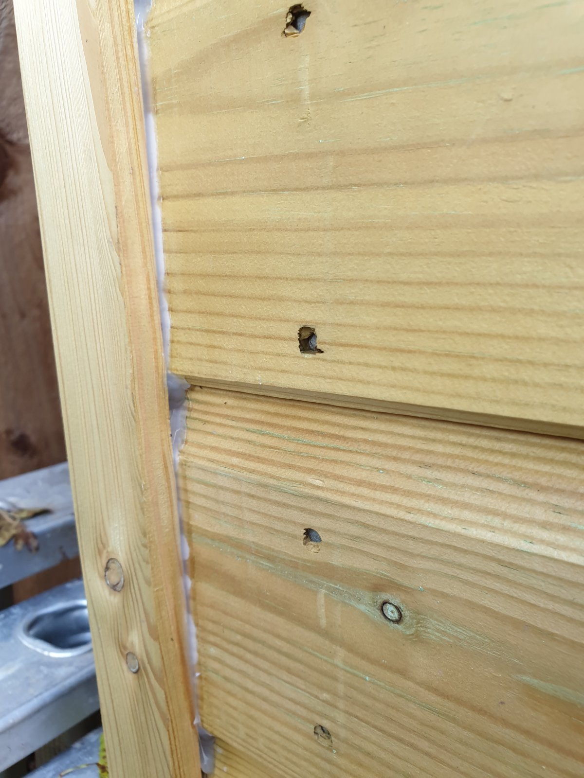

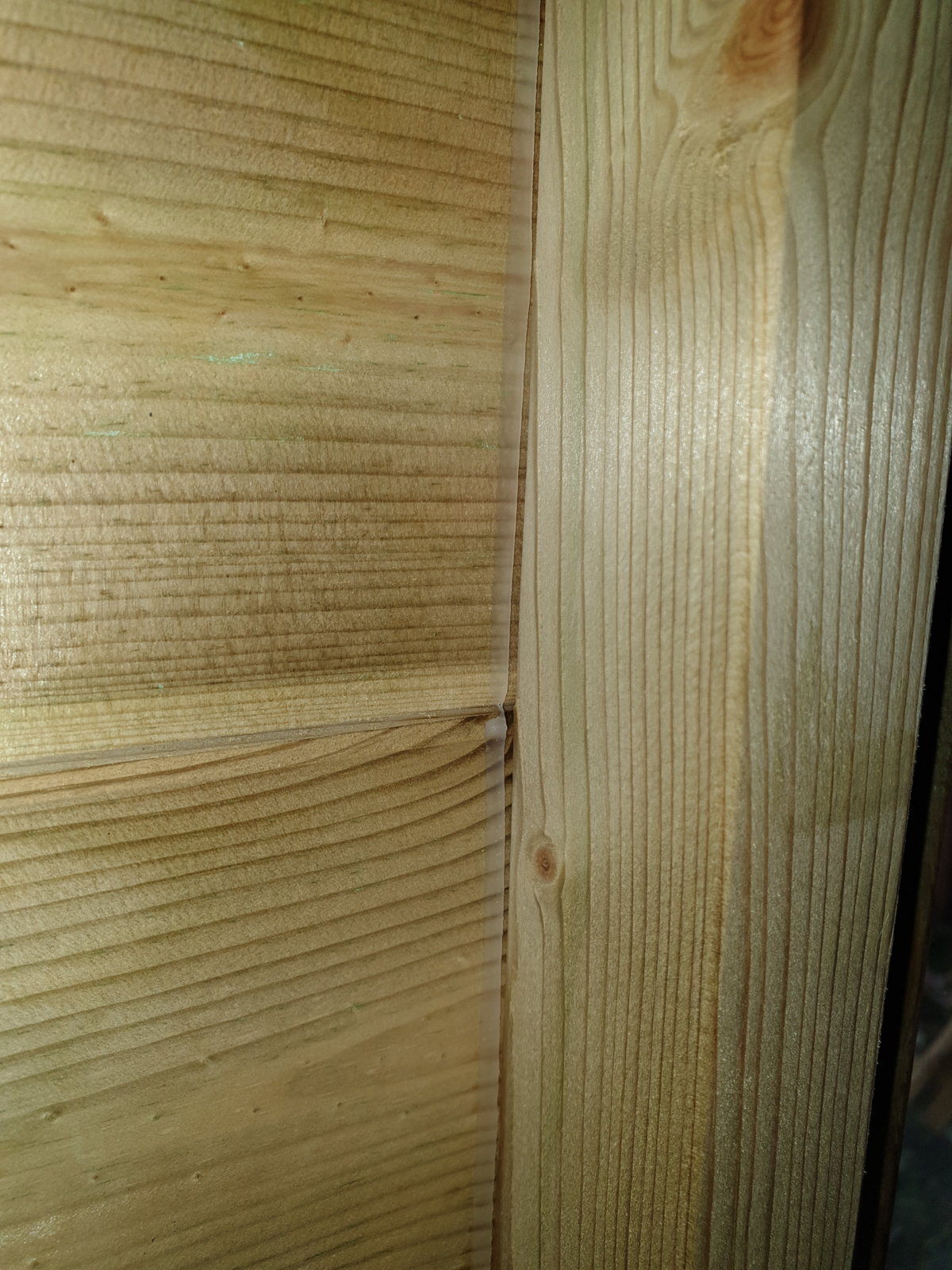

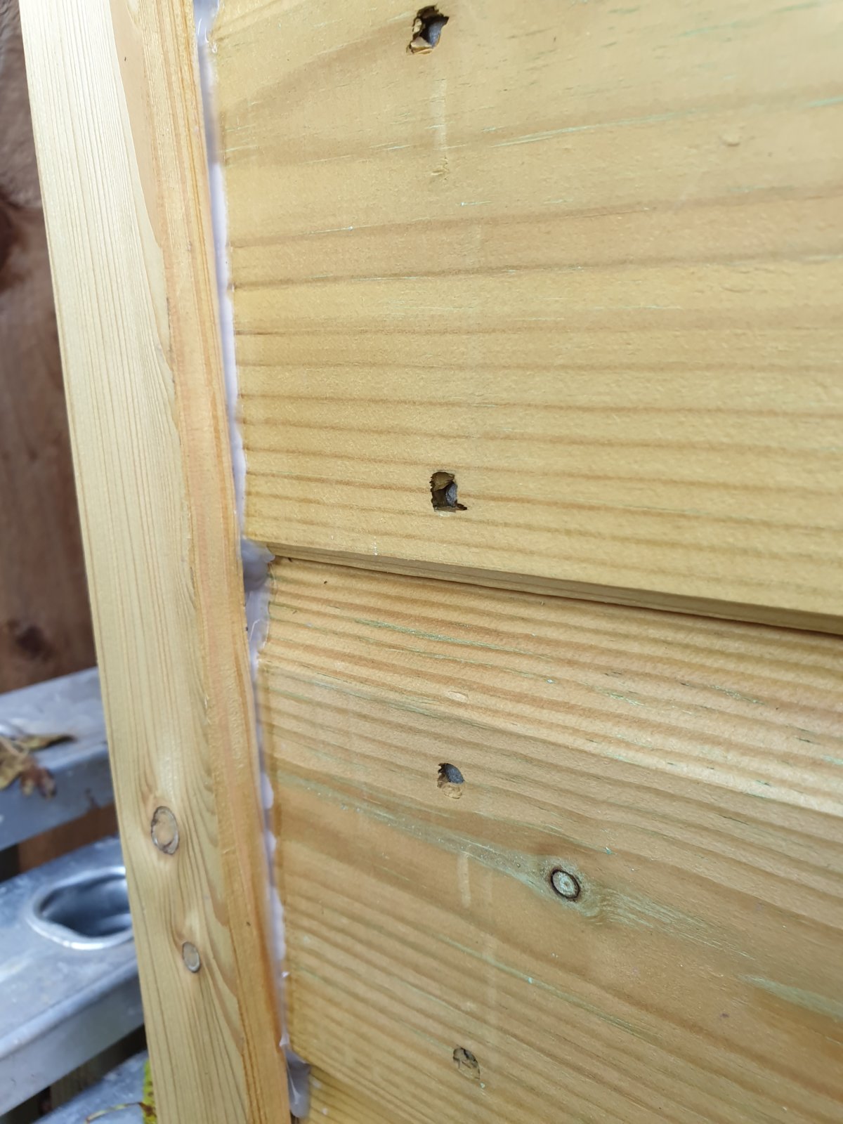

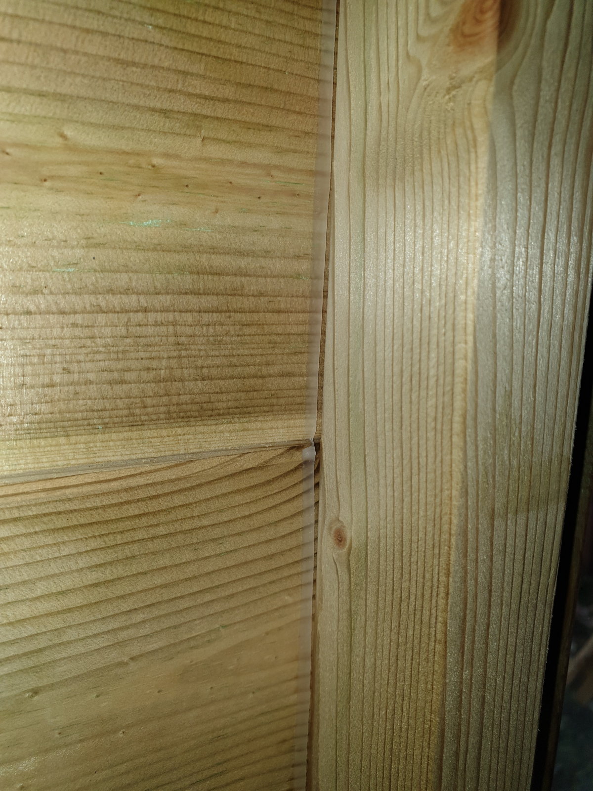

Update on this shed. It's still leaking water in through the walls despite several visits from the manufacturer. I now have silicone around the windows and all sorts which I'm furious about as when I apply preservative it's going to dissolve.
I've asked 3 times for a refund and collection of the building, which they're stalling on. I've now involved my bank, and placed a claim for a chargeback.
The shed was ordered via a concession in Dobbies
I agree, I have raised this with the manufacturer. Water is literally running down the walls externally.
They say they're all made like that. All I can assume is there's a lot of people out there with the issue who probably haven't noticed.
Fitting a gutter might solve the problem. ( the supplier of the shed paying for it )
I did consider this, but have been working in China for a few weeks and returned last night to look at their latest attempts.
Not only have they clad silicone all over, but the bottom corners are soaked through also. The table legs are saturated too.
I think it's gone beyond a gutter now. I don't want the building anymore.
If all their roofs are like that the will all leak. You need the overhang (or a gutter) to direct water away from the wall.

On another front. which way up is the T+Groove? can you see any ends or areas where you can find out if the Groove is uppermost or the Tongue uppermost?
Ken.
If its been caulked with silicone it will repel any surface treatment you paint on which is surly unacceptable..? looking at the pictures it seems the tongue is uppermost which is correct but having said that, theres nothing to say they are in deep enough.

I thought maybe the T&G is the wrong way, but if it is the entire shed is because it is all the same way up.
