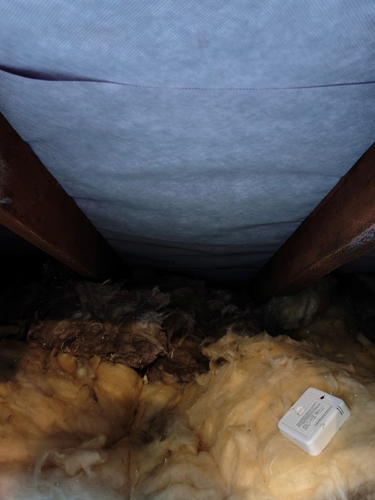

The eaves has new fluffy insulation laying on it, which they added as the previous insulation was quite pathetic.
I took a photo inside the eaves. There is nothing between the breathable felt and the air in the eaves as seen:
Breathable (membrane) means it will let water vapor escape. It is not a protection from the sun. Nor does it insulate form the sun.
You may benefit from some through ventilation i.e. OFV's and vented ridge etc.
You can see they weren't, too late now, some soffit vents and some slate vents are all you can do now, assuming a clear ventilation path can be achieved between the soffits and the void. I'm gonna hazard there's no ventilation behind that cladding either.

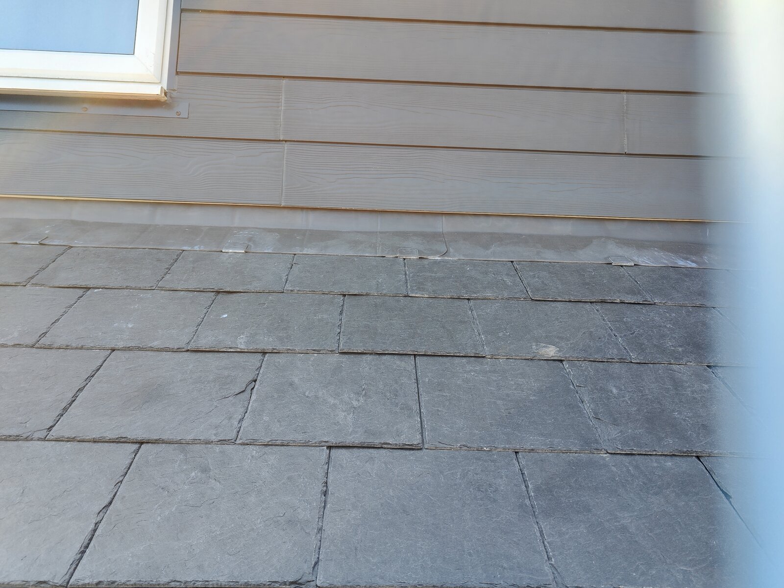

How would you ventilate behind the cladding?
With battens? If so there were battens
The battens are fine, you would normally have a gap at the bottom between the cladding and the lead and at the top between the top of the cladding and the soffit.
Thank you for the advice
I think there was a gap at the top of the cladding to the soffit and at the bottom (the lead is under the cladding) but the lead from tiles to cladding at the bottom is tight with no gaps. Presume that is normal, but no idea.
