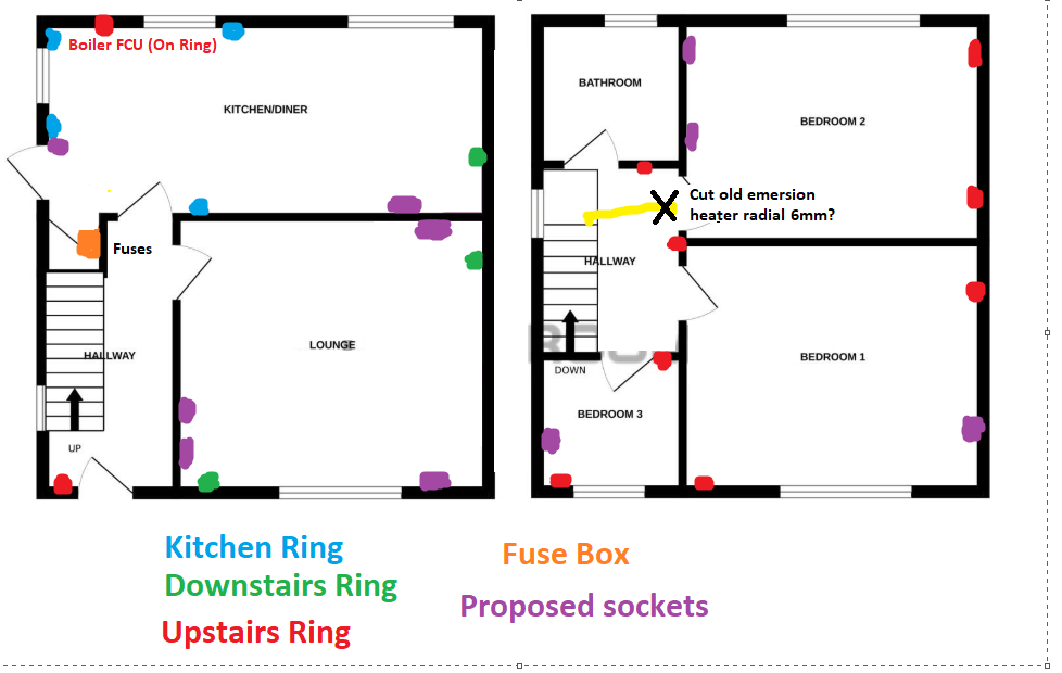

New sockets - from which ring?
Fwiw the circuit our boiler is on also goes to the loft socket and loft light.
