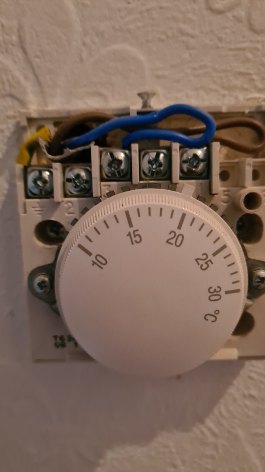

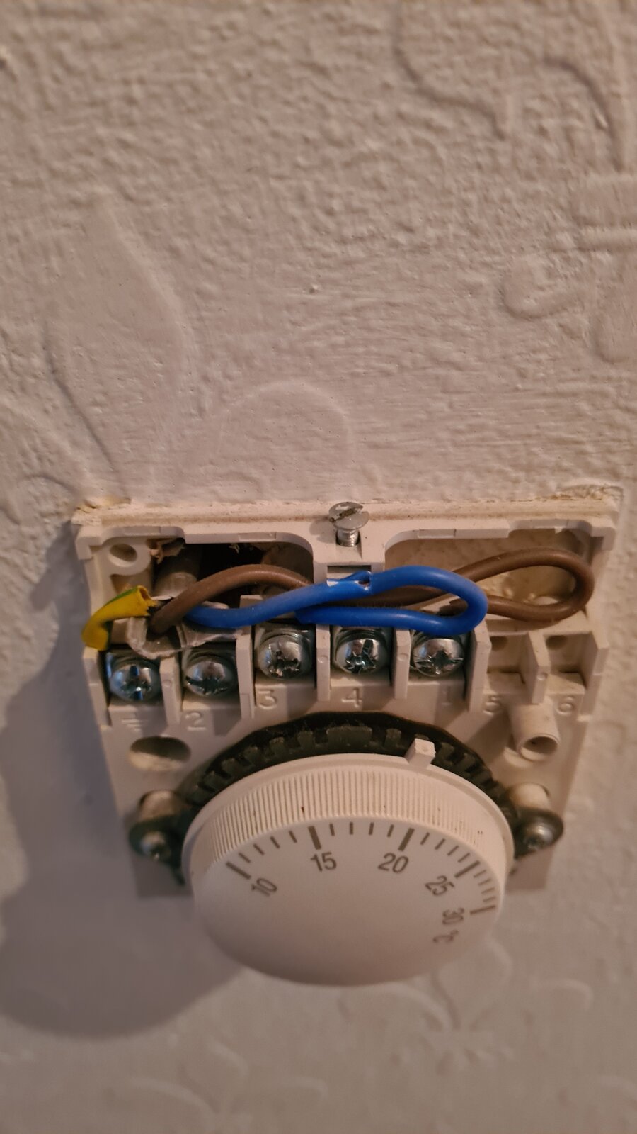

Hi
I wanted to ask your advise, in case I missed something obvious, before I call someone in.
We have moved in to a new place, which had a Honeywell t6360b (and combi-boiler Main 24 HE) installed. The problem from the get go was that t6360b was useless as a thermostat and functioning only as a switch to turn the boiler on (when set to 25 degrees) and on (when set to less than 25 degrees).
I assumed that the thermostat was faulty and as I also fancied something more modern (but didn't need a smart thermostat) I have bought Honeywell t4 to replace it.
I have installed the new thermostat but as it could not controll/connect to the boiler I quickly replaced it with the old unit.
Is the wiring (old one on the boiler side, or new one-on t4) incorrect?
My old thermostat's wiring and cover plate are shown in the photos.
I have connected 1 to A, 3 to B in the new unit and isolated earth.
I did not open the boiler as I didn't feel confident enough but I'm happy to open it if I know what I'm checking for.
Timer on the boiler is set to constant.
Thank you for any ideas.

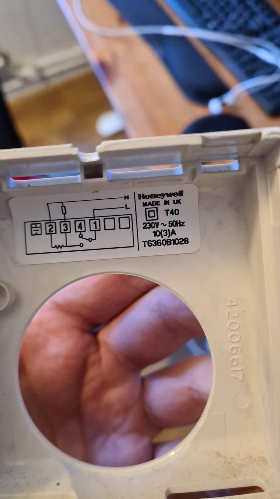

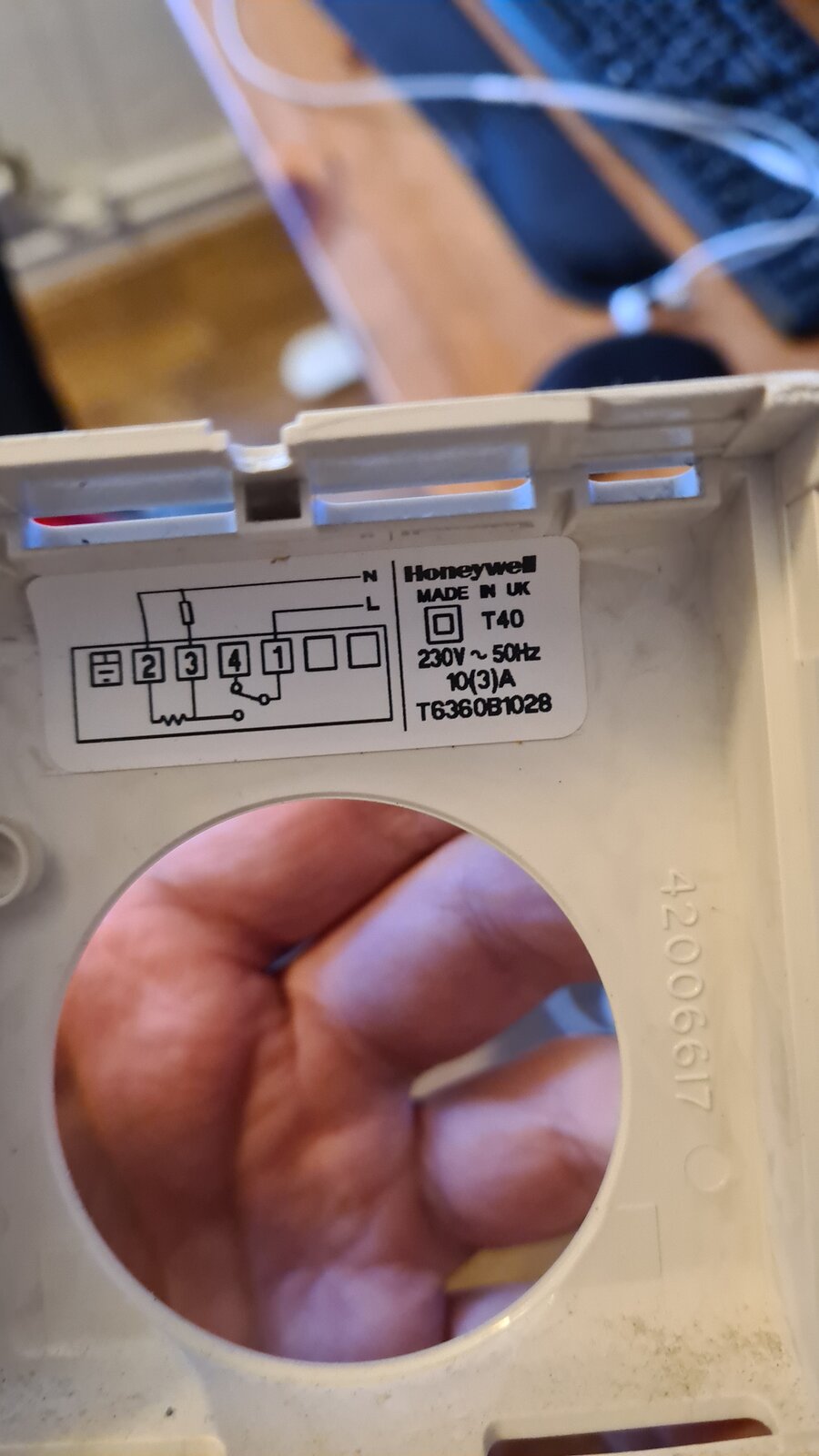

There are not many choices for the T4, it's A & B to be connected. The older T6360B in theory should be 3 wires including a neutral in 2 as well as 1 and 3 connected. Is your T4 the non-wireless model or the wireless T4R? Not sure what you meant by "I have installed the new thermostat but as it could not control/connect to the boiler I quickly replaced it with the old unit".
I wonder if you have a more fundamental problem. One way you can check if the thermostat wires actually control the boiler would be to place the blue & brown into a common terminal, i.e. effectively setting the thermostat as permanently on. Naturally turn off the central heating at the fused spur first. If the boiler fires up then the cable is ok, if it does not then you probably need someone to check further.

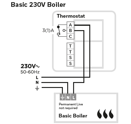

if you think about it, the T6360B thermostat is simply a temperature controlled switch. You only have two active wires connected to the thermostat, they are either open (heating off) or closed (heating on) when the programmer permits. The order of A or B on the T4 does not matter as it's just joining them together. Hence I don't believe the wires from thermostat location to boiler are the problem.

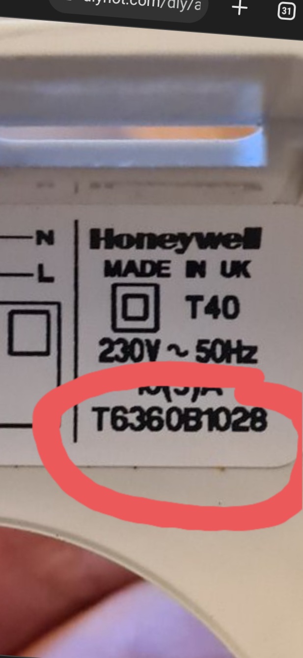

Why are you showing a T40 above if you have installed a T4?, wiring diagram, below, which you do seem to have wired correctly as B should be the switched live to the boiler when there is a call for heat from the stat and the switch closes.
Some sort of mistake in your wording?
The stat is supposed to turn the heating on and off. Like a switch. Do you mean it didn't?
Hi John,
I meant that it doesn't do it based on the temperature of the environment but only when I manually set moved the dial to 25 degrees.
Hope that clarifies it.
