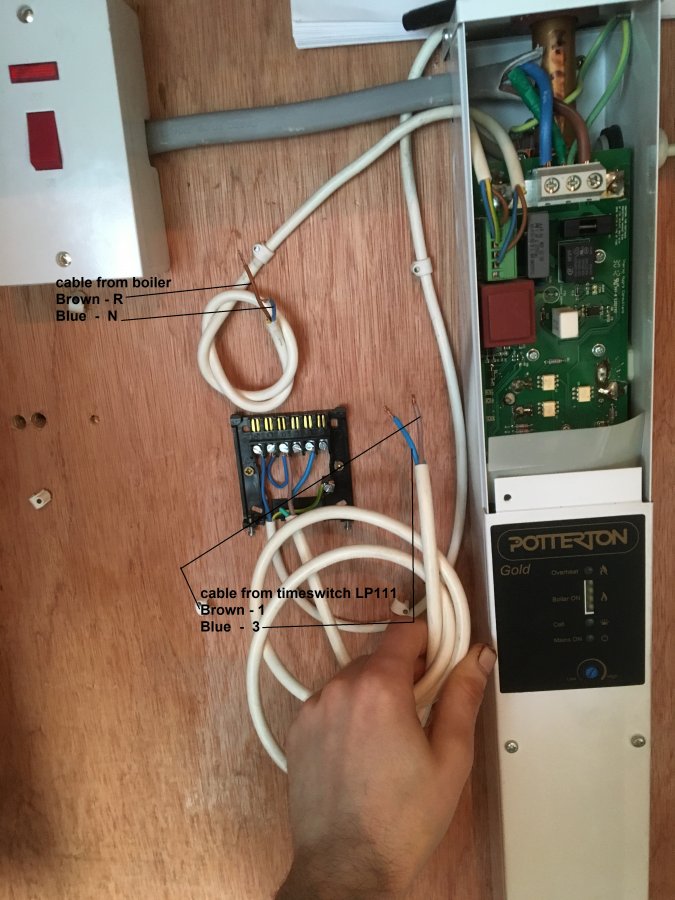

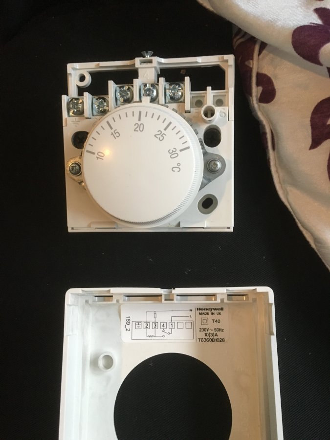

I need to connect Honeywell Thermostat T40 - T6360B to my boiler and timeswitch
I have 2 cables.
First cable is from boiler. Brown is connected to R in boiler, Blue is connected to N in boiler.
Second cable is from timeswitch. Brown is connected to 1 in timeswitch black plate, Blue is connected to 3 in timeswitch black plate.
Where do I need to connect cables in Honeywell thermostat?
I remember 1 cable brown was connected to EARTH but I don't remember if it was from boiler or timeswitch.
Timeswitch: DRAYTON LP111
Thermostat: Honeywell T40 - T6360B
Boiler: Potterton Gold 12kW electric boiler

I didn't want to change Thermostat or anything - I wanted to move it from different wall into room where boiler and all of that is, as I needed to fit furniture close to the wall where thermostat was before. I had paper showing how it was connected before, but has been lost, so now after few days I am not entirely sure how it was connected. Loose 2 blue and 2 brow cables that you see on the picture, were all connected to Thermostat.

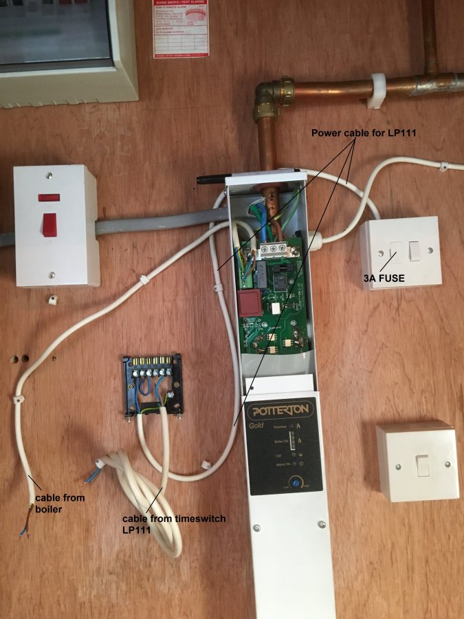

Is there an additional 3A fused mains supply for the controls? This should lose power when the main boiler circuit is switched off.
If not, wiring up a 3A spur close to the switch in the picture should be your first job.
Sorry I can't see it in the pictures. There should be a mains cable from that supply to power the LP111 programmer.

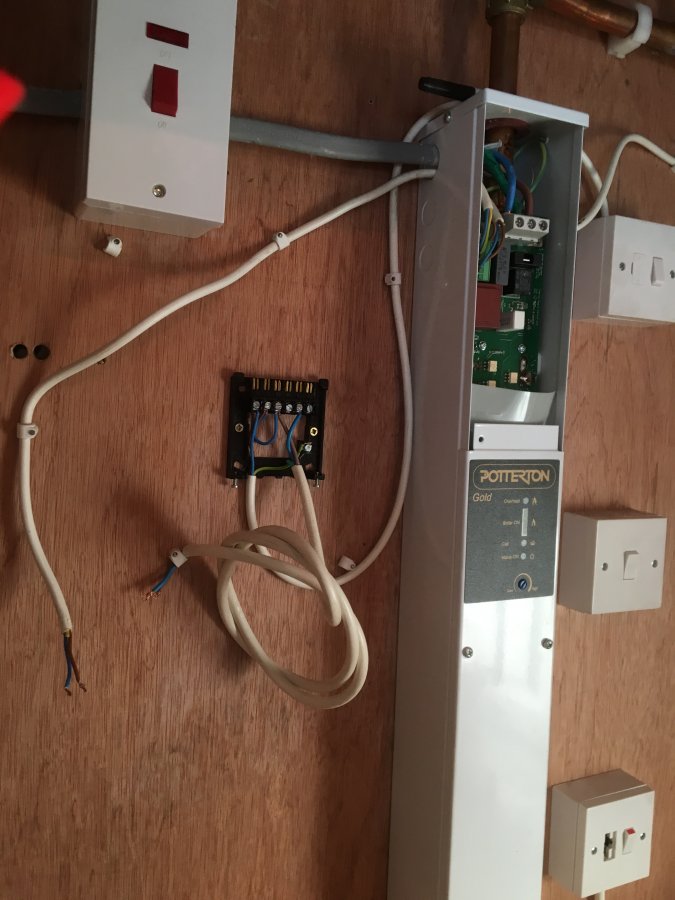

Maybe thats a bettry pictures.
I didn't want to change Thermostat or anything - I wanted to move it from different wall into room where boiler and all of that is, as I needed to fit furniture close to the wall where thermostat was before. I had paper showing how it was connected before, but has been lost, so now after few days I am not entirely sure how it was connected. Loose 2 blue and 2 brow cables that you see on the picture, were all connected to Thermostat - this part is what I don't know how to connect
Manual is not clear - termostat manual also is not clear for me.
I disconnected thermostat from cables and now I need to connected it back but I don't remember where to put which blue and which brown as there are two cables of each color.

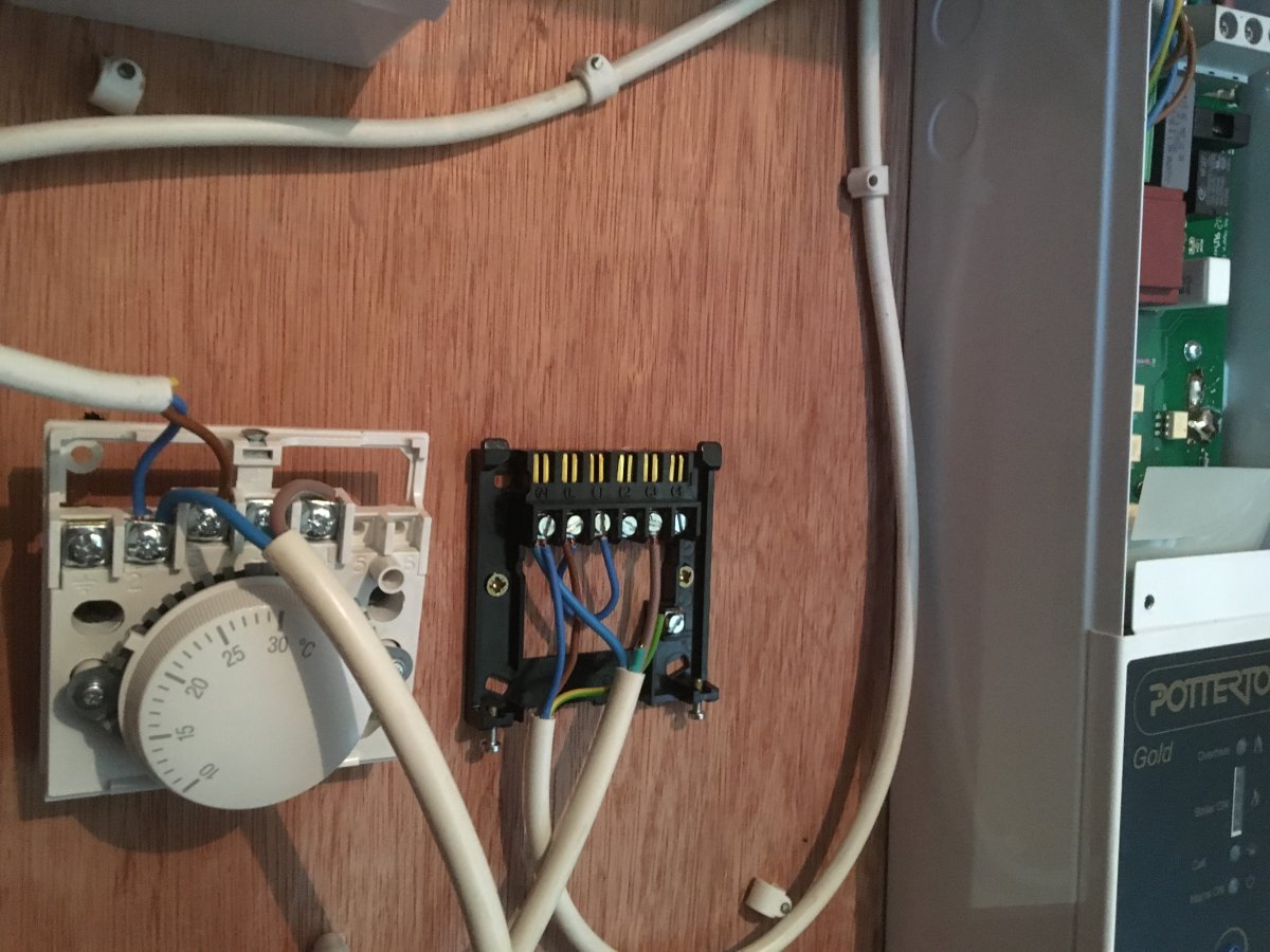

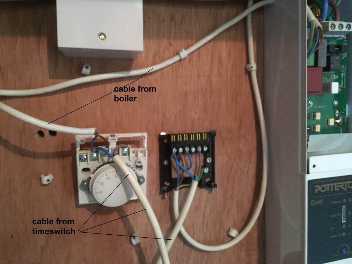

OK I would first disconnect the cable you show held in your hand so the programmer then only has the mains from the spur.
ie brown Live to Live terminal of backplate which is also linked by short wire to terminal 1. Blue to the Neutral terminal.
Then add back the removed cable to the backplate with Brown to 3 and Blue to Neutral (now 2 wires together here).
The other end of this same cable connect Brown to Honeywell 1 Live, Blue to Honeywell 2 Neutral.
Then the cable from the boiler Brown R goes to Honeywell 3 and Blue N goes to Honeywell 2 Neutral (2 blue wires in this terminal).
Looks good but cables need tidying up and clamping so they can't easily be pulled out.
When you come to mount the thermostat further away try to get hold of some proper 3 core flex for the run and fit a small junction box on the board where the honeywell is now to combine the existing 2 cables together.
