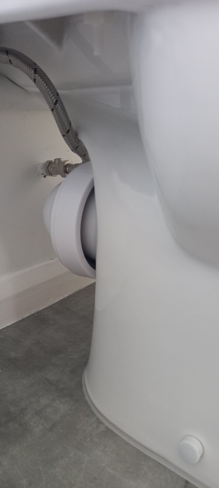

Hi all,
I had an ensuite built in my house recently. New toilet and wash basin.
I christened the toilet this morning and found that the flush did a good job of clearing the load. However, once the main load had disappeared and the tank started filling, some very small fragments slowly drifted back to the pan. Repeated flushes were not successful in making these go away, they'd drift back again after being flushed away.
They have eventually gone but it is a bit annoying. Anybody know why this is happening?
No issue with the neighbouring toilet in the adjoining bathroom. No obvious issues in terms of blockages. It is as though there isn't quite enough power from what is a small toilet, but having said that, it completely cleared the main load no problem and the little tiny bits seem to elude subsequent flushes.

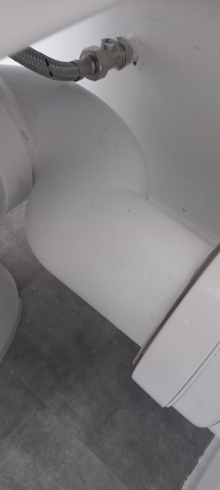

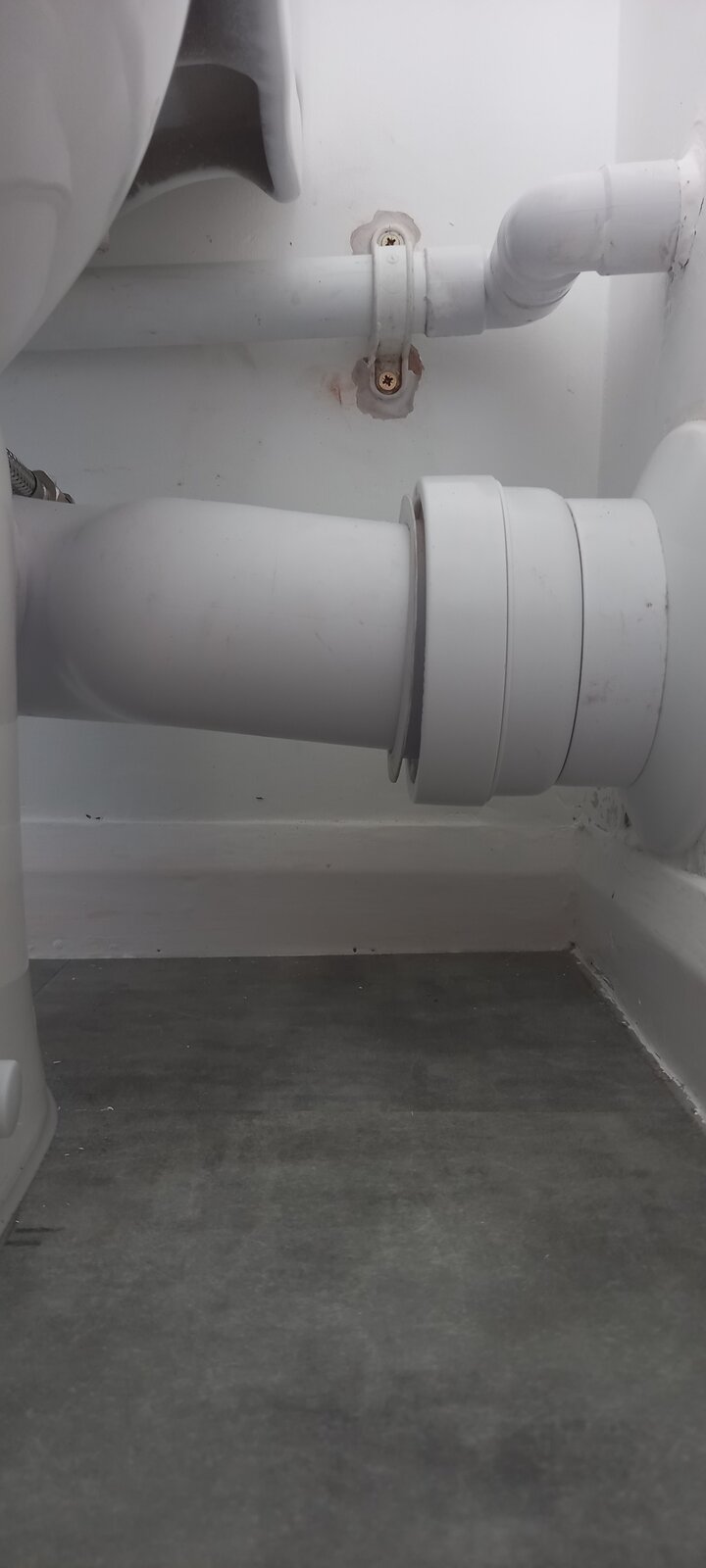

Back fall?
The soil pipe is slightly falling back towards the wc meaning it’s trying to flow uphill so that once the main load has been flushed, some of what has been flushed runs back into the toilet.
From what I can see, there is a fall away from the toilet after the soil pipe turns the corner...
