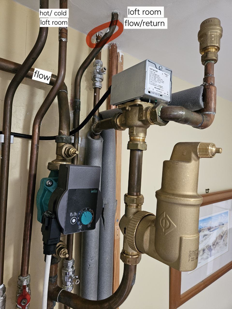

* Spirovent de-aereator between the pump & three-port (new)

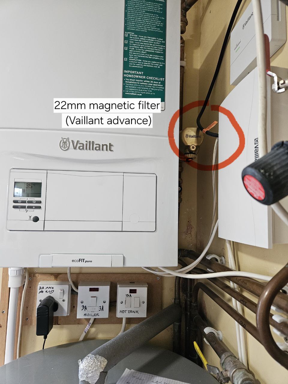

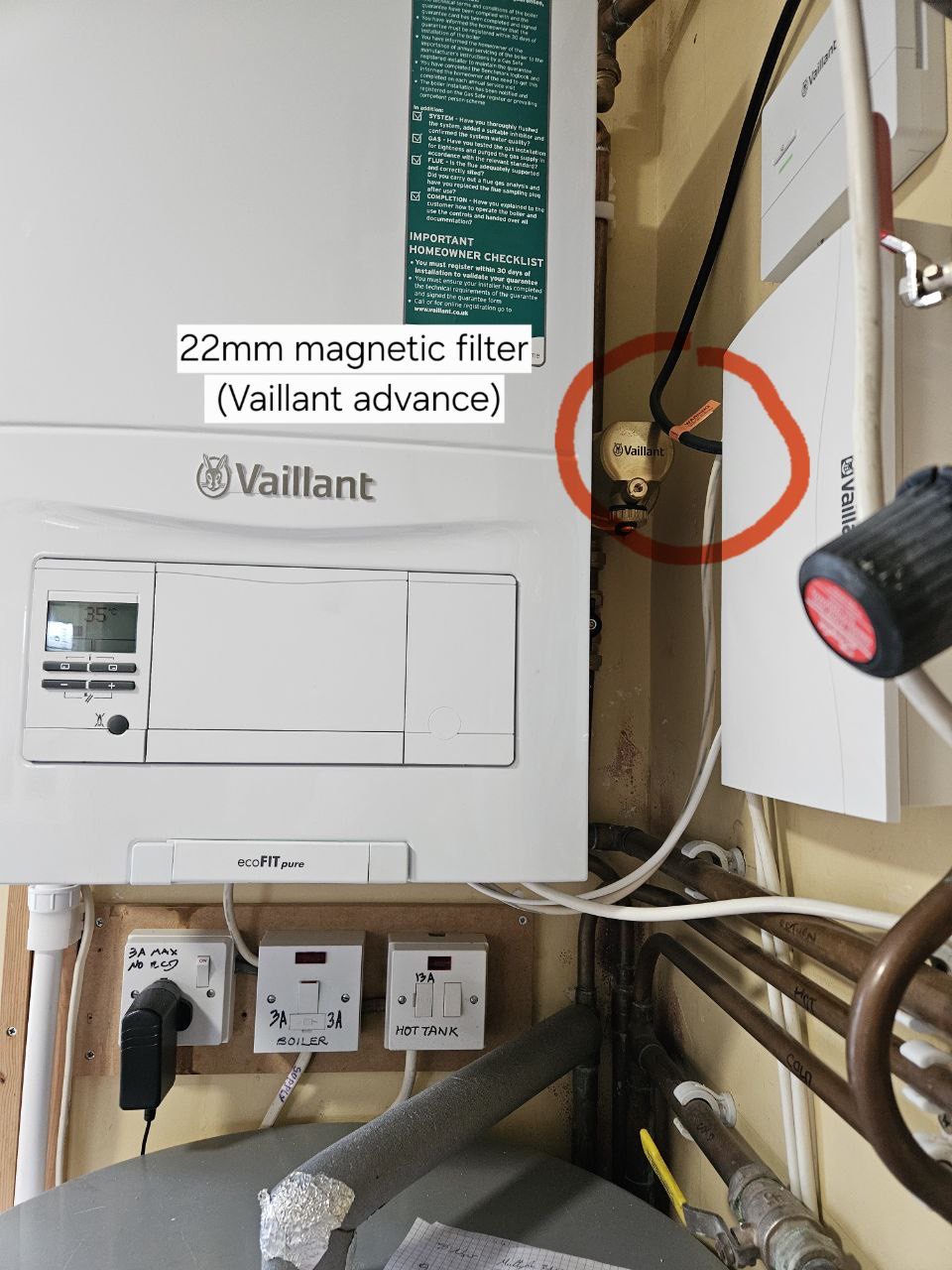

* Magnetic particle filter next to the boiler (new)

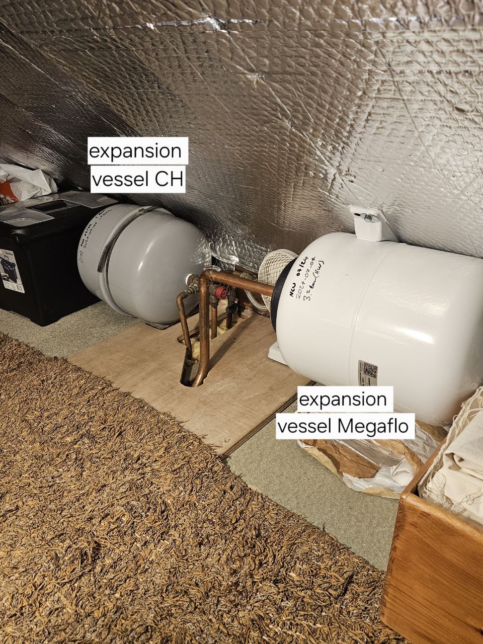

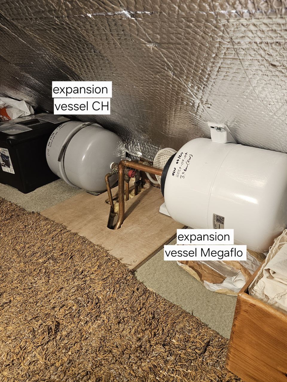

* Heating circuit expansion vessel in the loft (replacement)
* Hot water circuit expansion vessel also in the loft (new addition to Megaflo)

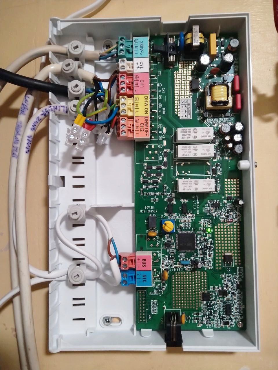

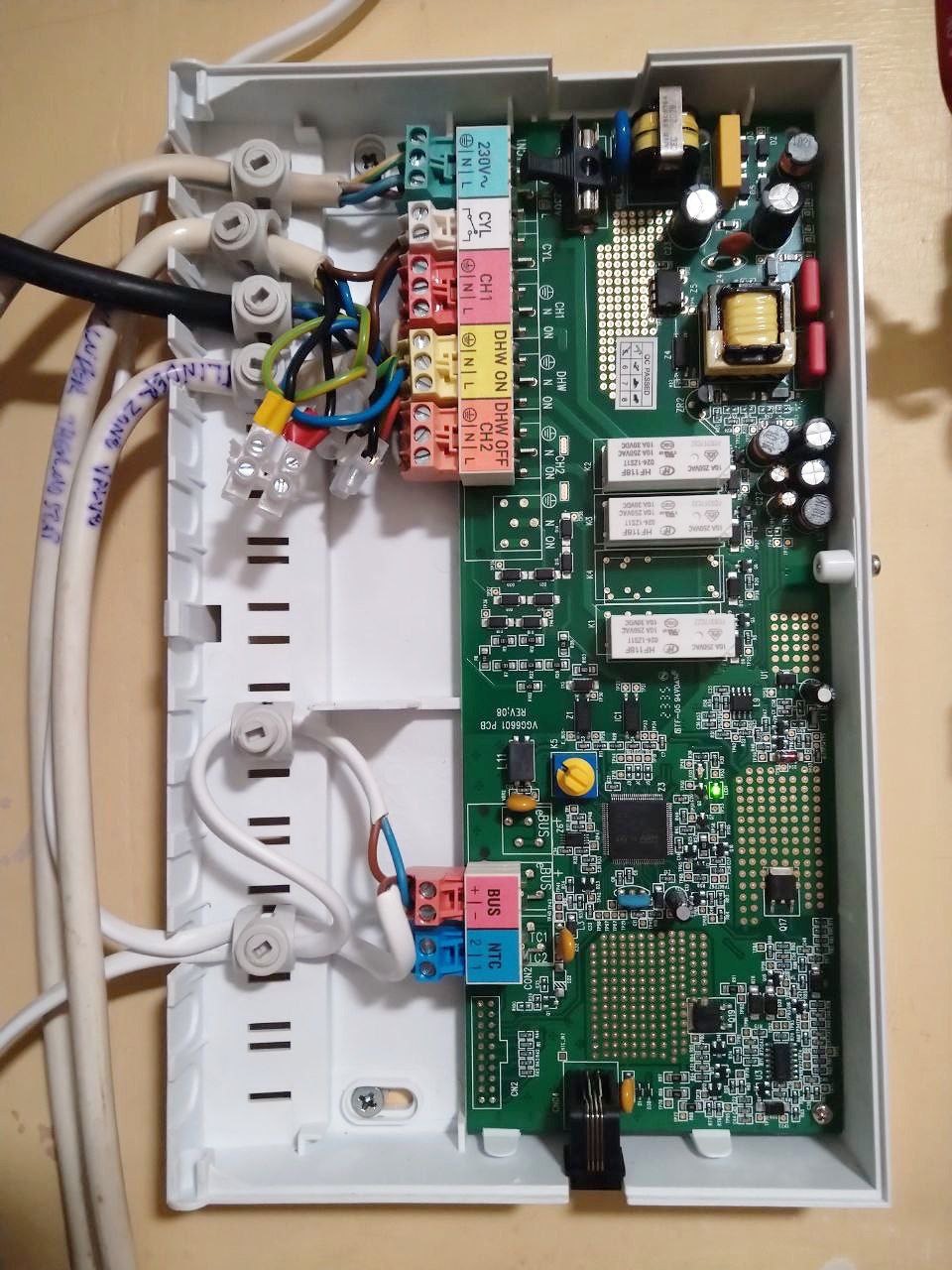

>Have you any wiring diagram for this setup?
It seems pretty normal in the picture, but we haven’t deciphered all the bits

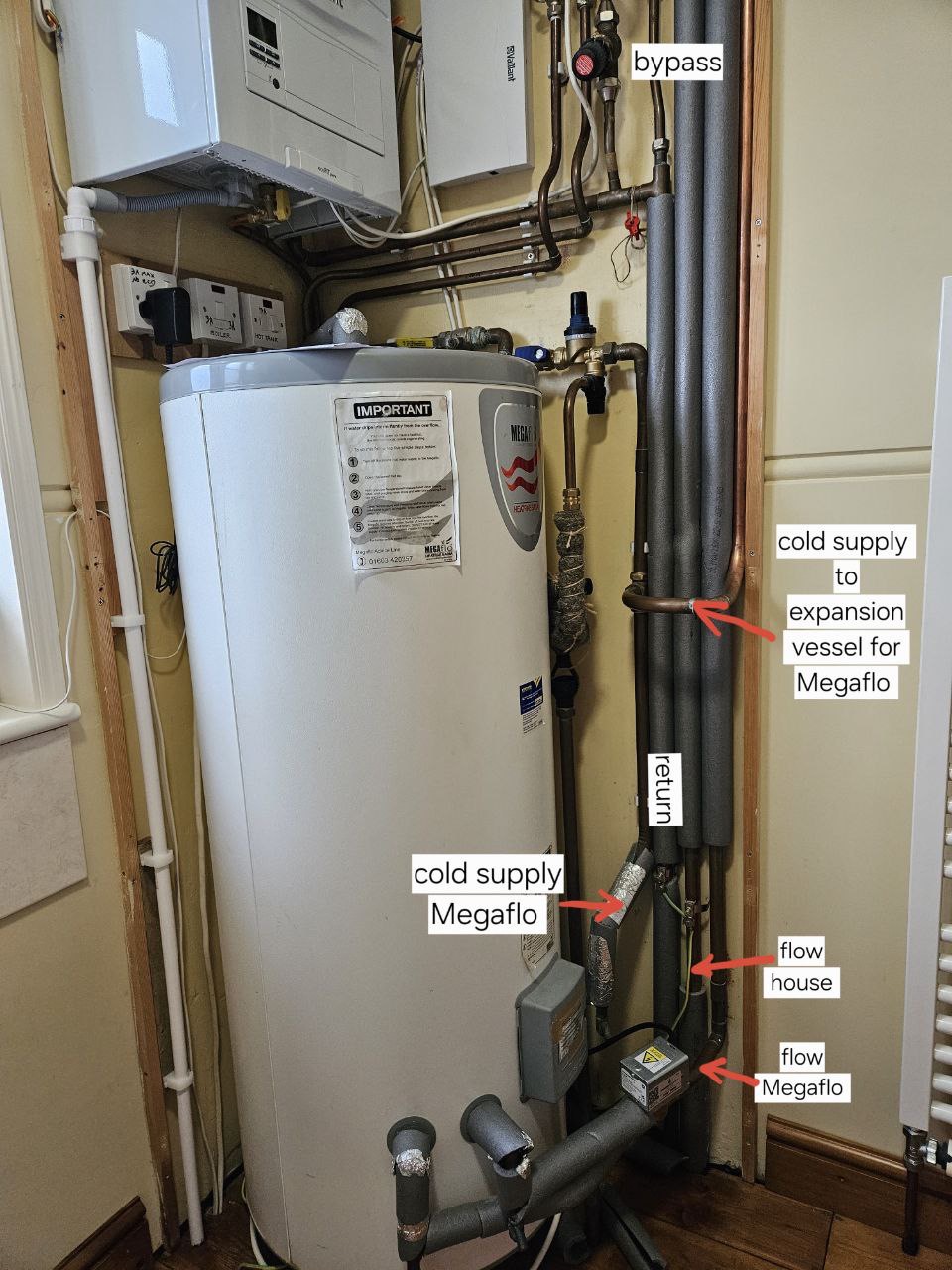

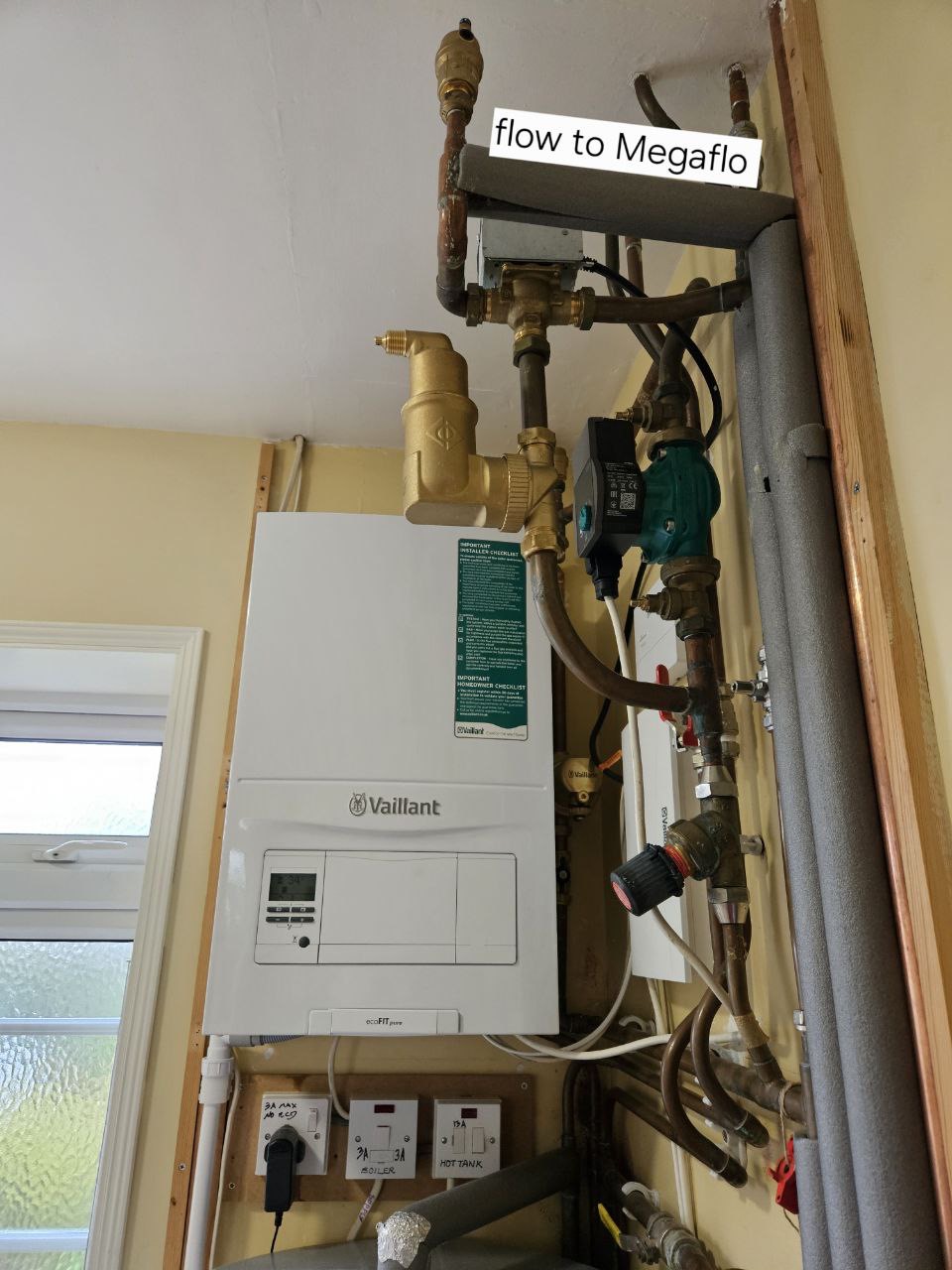

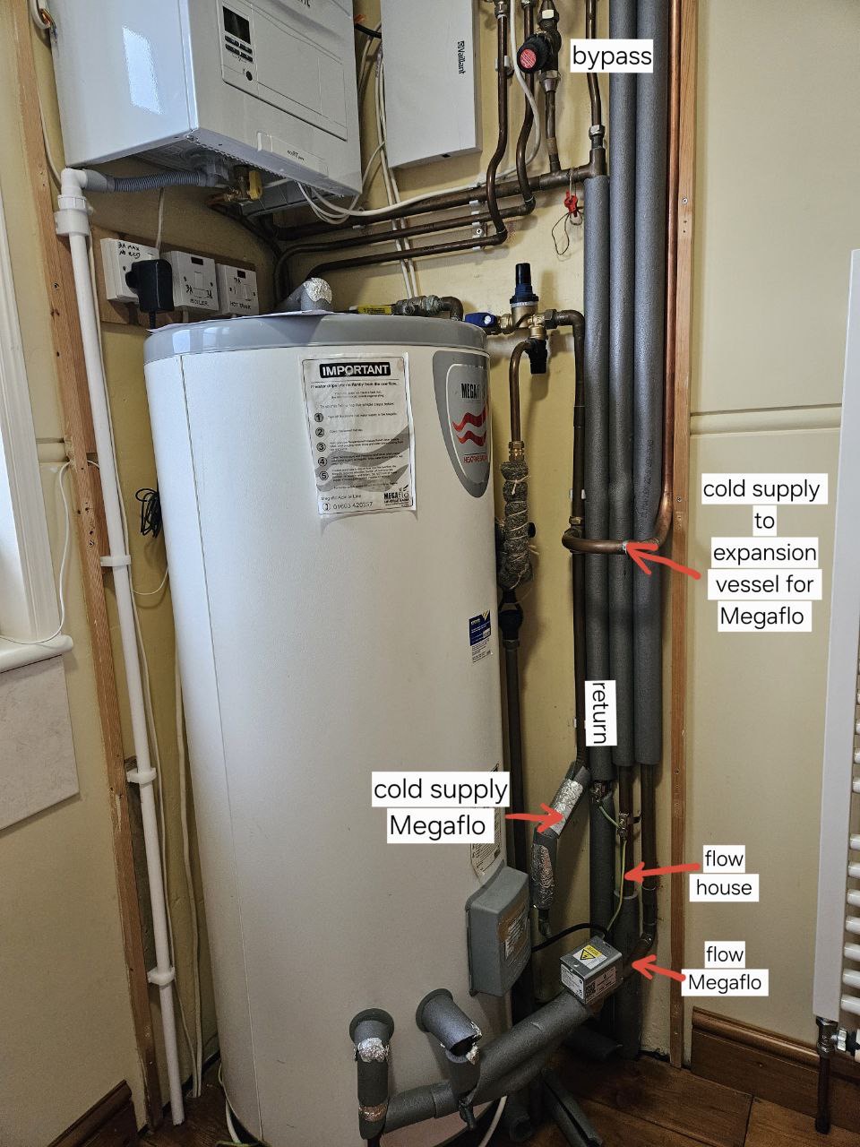

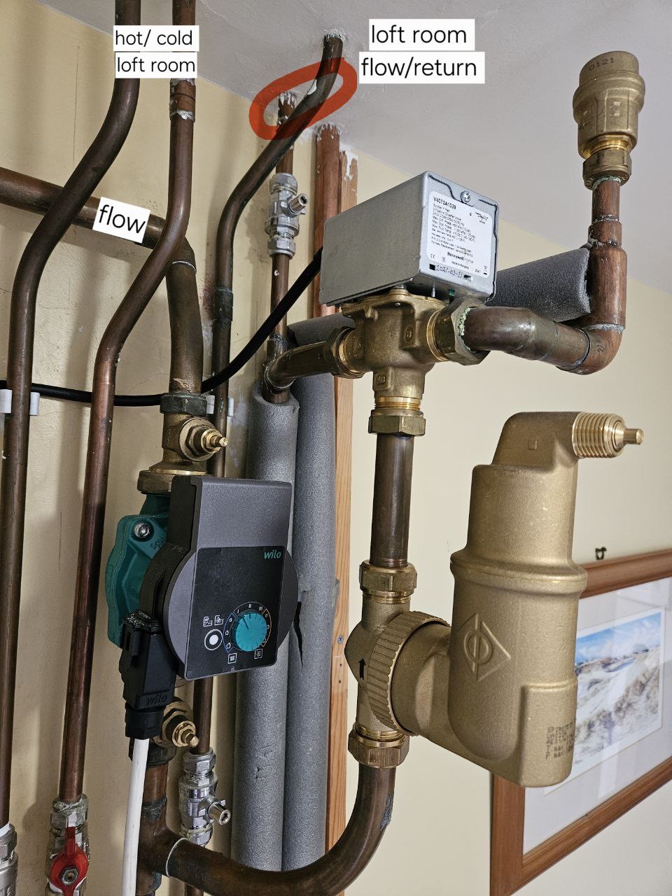

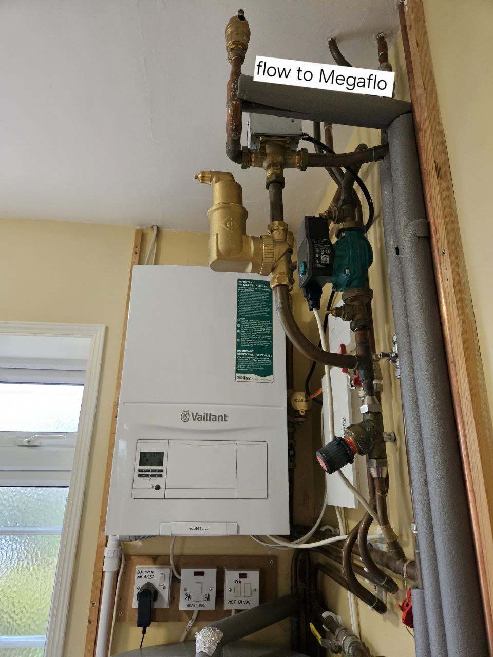

> And perhaps a sketch of the installation
See photos – can produce a schematic over the weekend if useful
>I'd suggest ensuring the pipework is properly secured as a start
Mostly the pipes are well fixed, but the system didn’t suffer this problem before the new boiler went in and the additional pipes aren’t particularly loose

Hmmmn... Perhaps something to do with the megalfo having had an expansion vessel added, as baffle failed? Is that why it was added?
The HW EV was added as a future fail-safe, and there wasn’t a problem in the summer months when we were running DHW-only.
The noise only occurs if the CH runs for at least a couple of hours after DHW fully heated & two-port closes. The loudness of the bang on DHW valve re-opening appears proportional to how long the CH ran meanwhile, even if the CH has stopped when the cylinder stat eventually calls for HW again.

You could try a shock arrestor after the 2 port but anything you do needs a drain down as it seems to be a hydraulic issue.

Though after tracing the pipework, I am more inclined to think the pressure builds between the three & two ports as a result of CH leaking through the three port into the DHW loop
Is the above EV in addition to the Megaflo air bubble?? so has nothing to do with a (red) EV installed if a heat only boiler.
Looks like it, so should have been installed downstream of the expansion valve on the cold feed to the Megaflo.
