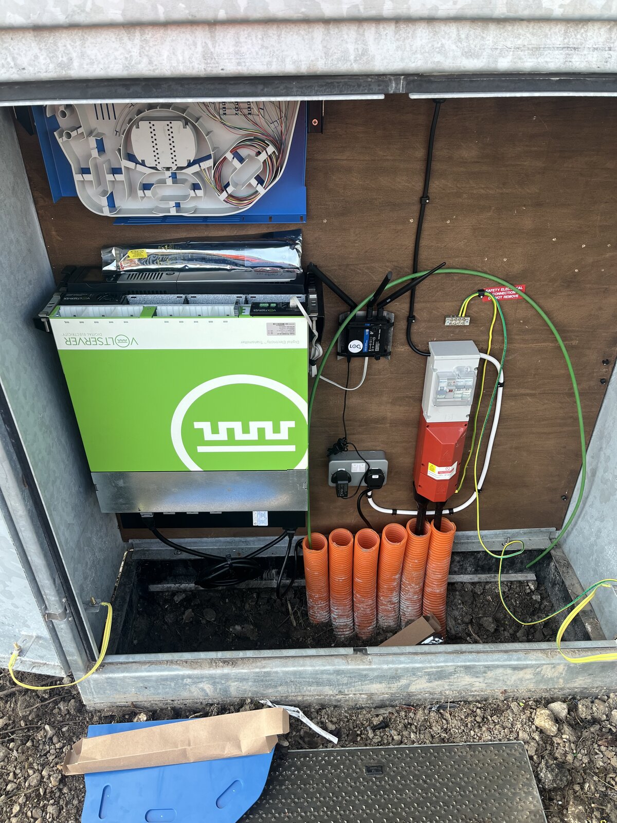

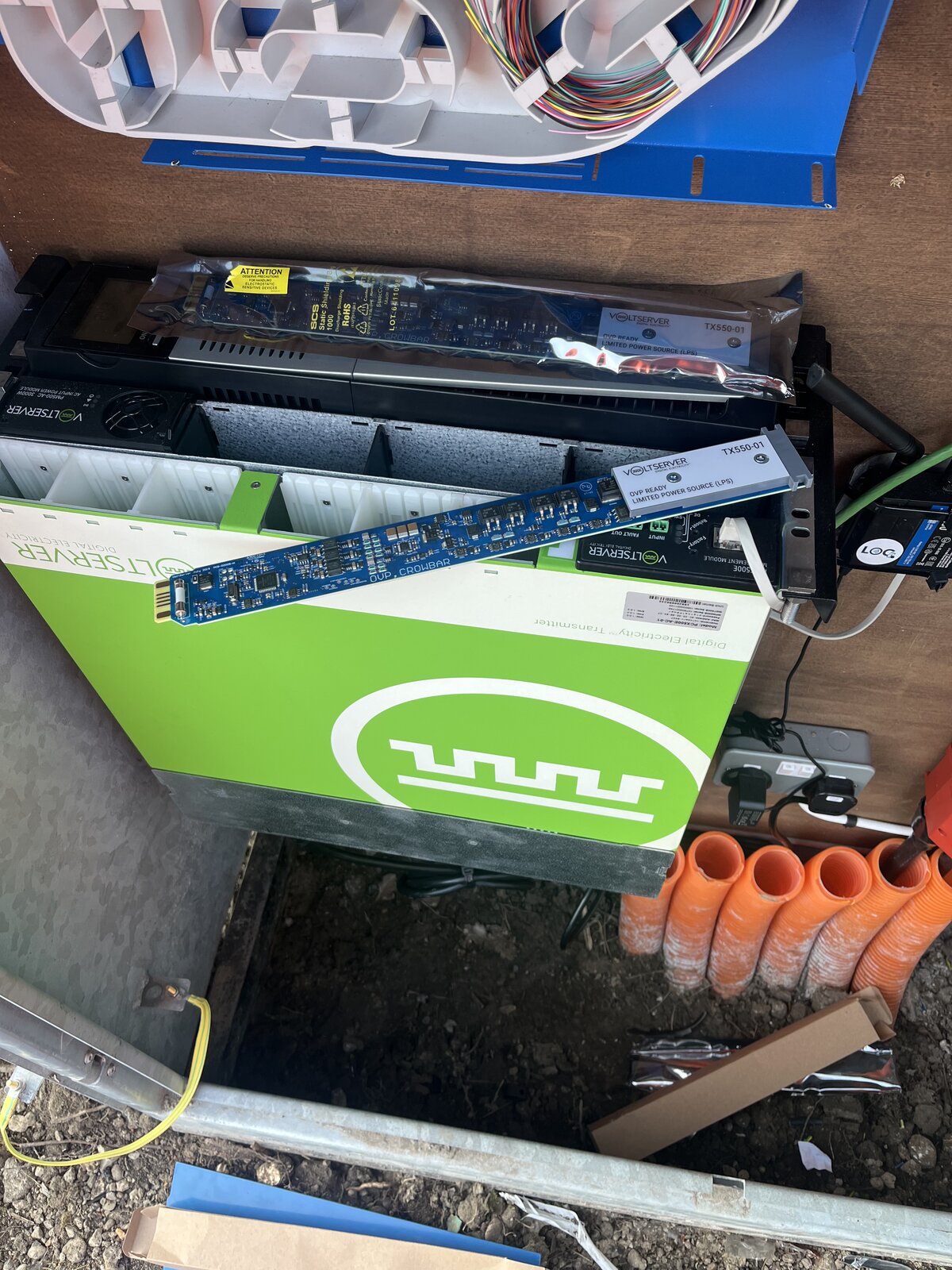

The VOLTSERVER thingy is upside down...just sayin :p
Been doing radio interviews this morning whilst programming all the servers up. Also installed a 5G tower and linking that in to the control cabinet.
Just splicing the fibres and fusion welding them and all done. Hopefully tomorrow which is our big switch over. Be amusing if it all doesn’t work for the MPs and TV Crewe’s attending :unsure:
Just received a personal message from American outfit to say how great it is all looking and we are on a green light to switch on.
