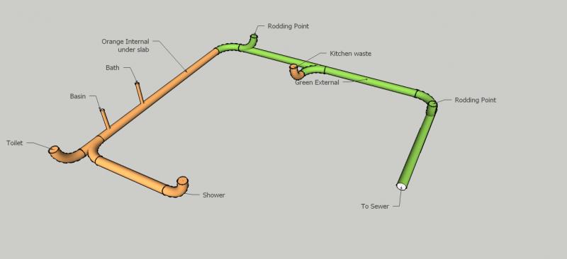

I need to lay a new drain around the back of our extension and then under a new slab in our bathroom (see pic). Couple of questions;
1) does the layout look right. I have put rodding points by the 2 main changes of direction (there is approx 10m between the two). should these be positioned to rod upstream as shown?
2) There are several connections needed in the bathroom. Toilet i guess is easy connected straight onto the 110mm pipe. How do i connect the basin, bath and shower onto the soil pipe? I dont want pipes running above ground so they need to be individual connections.
3) Dito for the kitchen sink but i guess this will be similar to above.
4) How do the pipes penetrate the DPM. What is the detail here to maintain its integrity.

Personally I would look at using small diameter inspection chambers on the changes of direction. This then gives you rodding access in either direction. Connections, probably better to bring the 110mm up through the slab, then fit a 110m adaptor at floor level to accept the waste pipes.
Do the boss pipes have to be mounted vertically. What i ideally need to do is fit them horizontally underground especially with the bath and shower as i will not have the head room to bring the 110mm above ground.
Also, how do i seal the DPM around the pipe where the come through it?

You need to vent the head of your drain mate with a Soil Vent Pipe(SVP).
The waste pipes from the Bath & Basin would then go into the vertical SVP. This is what's called a 'Single Soil Pipe Waste System', most homes in the UK now are built having Single Soil Pipe Waste Systems. The 'Golden Rule' for venting drains/systems is air behind water.
HTH
I have room for a vertial stack to may be installed above ground in what will be the airing cupboard adjacent the shower
Should i therefore branch off just before the shower and put an air admittance valve on this?
Does this have to be right at the end of the run like this, or could i branch off before the bath. this would help due to the limited fall i have available?
Also, can i use those boss connection horizontally so that the basin/bath/shower wastes go verticall straiht down into the soil pipe?
Thanks for that. I think i now know how to make each connection.
Does the vent need to be at the end of the run though or is Teeing off by the bath connection ok. This would leave around 2.5m to the toilet and another 2.5m to the shower.

Just what it says mate, you flush the bog, the soil pipe fills with water, so you need air behind that water.
You pull the wash basin plug, the waste pipe fills with water and if that waste pipe is too long or if there's no air behind that water, it'll start to draw air through the basin trap & the trap will not re-seal correctly.
You need a SVP at the head of the drain, you may also need a small Stub Stack for your Bath & Basin waste pipes.
I will try and modify my drawing later and repost to check i have got it right.
