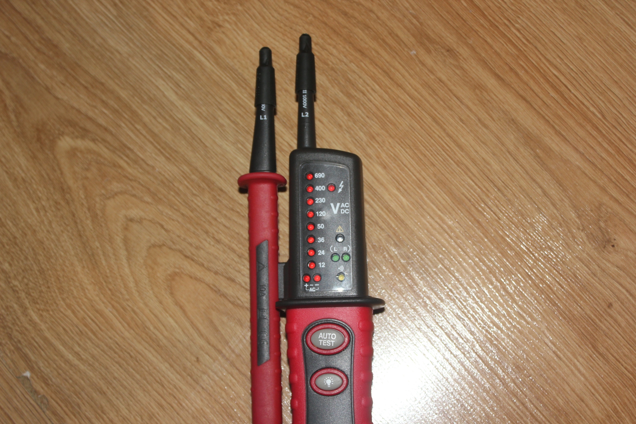

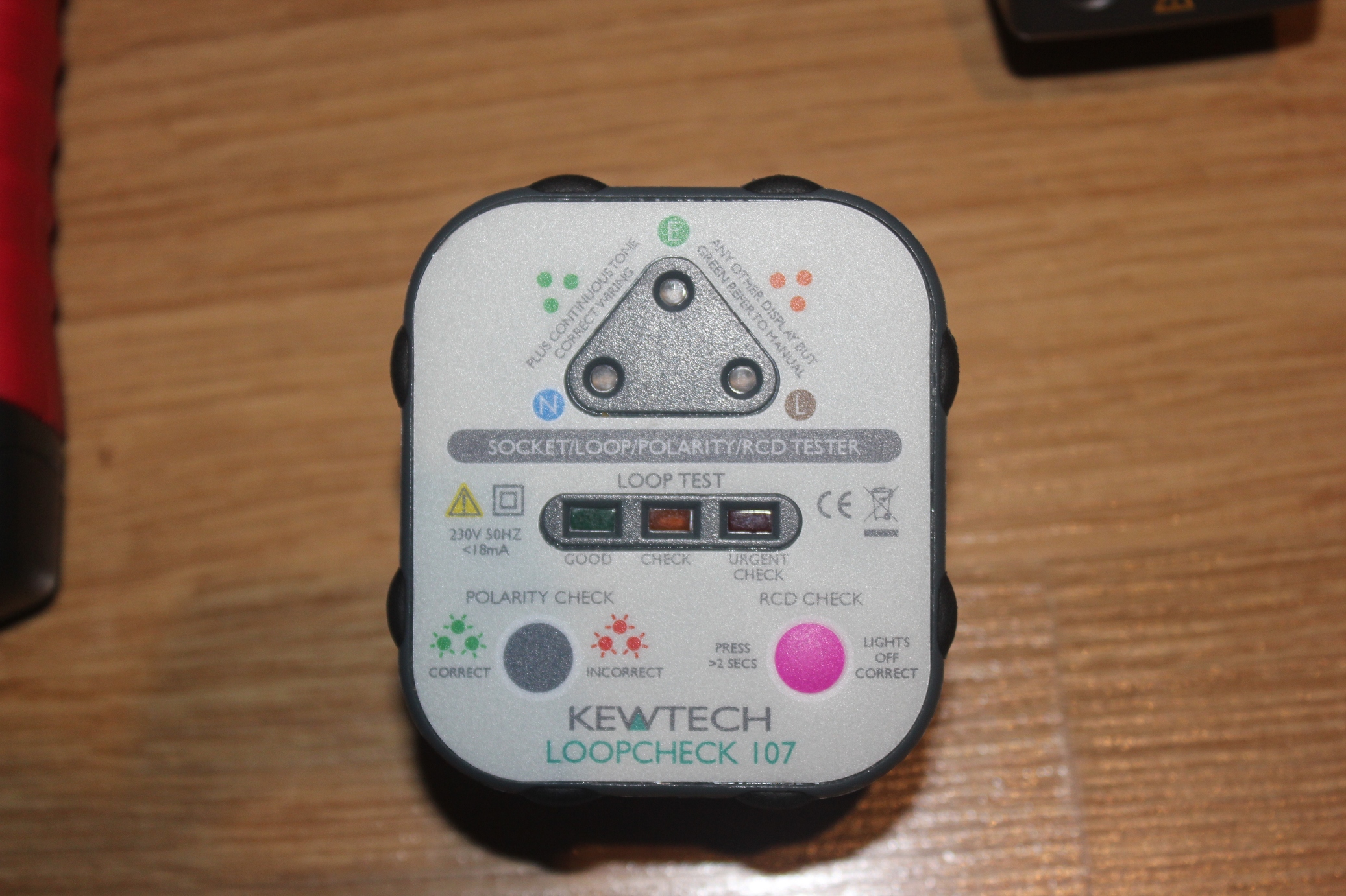

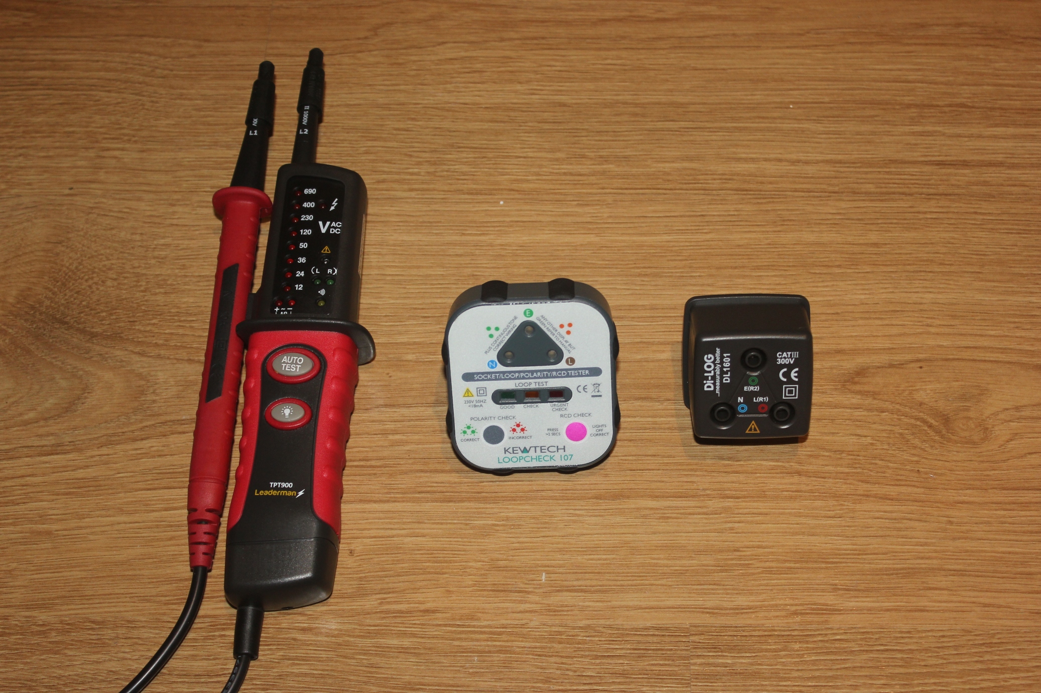

Just a quick one for the regulars; just picked up my first proper voltage tester along with a Kewtech LoopCheck 107 socket tester and a DiLog socket break out.
I do wonder though, how many people buy socket testers with a built in loop test feature and plug it into a 25M/30M extension lead and think something is wrong when it says check loop impedance. The same goes for TT earthing systems.
Regards: Elliott.
Since like I am sure most electricians I have a proper loop tester, I have never bought the EZ150 plug in tester, however I have looked at the spec, and the first light is 1.7Ω there are from memory 4 LED's with two colours so there are 8 levels, so I would have expected the instructions to say what the 6 levels mean? However with a standard ring final the pass mark is below 1.7Ω so even if it says all is OK it may not be.
The one you show has just two 1.8Ω and 92Ω and although 200Ω is considered as a pass I suppose it is unlikely with water and gas bonded that you would ever get a reading below 92Ω with a TT or 1.8Ω with a TN if the system is OK.
There are a good tool to tell allied trades when it is safe to use the power provided, they are not an electricians tool, in some ways two limits of 1.8 and 92Ω is better then 1.7, 5, 10, 100, 200, 500Ω given with the EZ150 as how do you explain what they all means? It says power consumption 2.5W for the EZ150 which is about 10 mA and the Kewtech states 7 mA line to earth, so should not normally trip a RCD, however they both could push the leakage over the 15 mA minimum and cause the RCD to trip, there should be a warning in the instructions.
