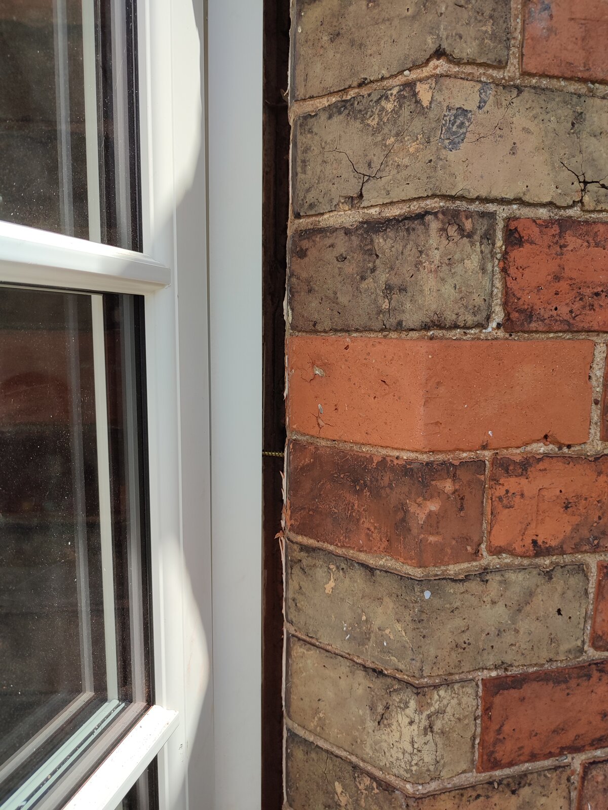

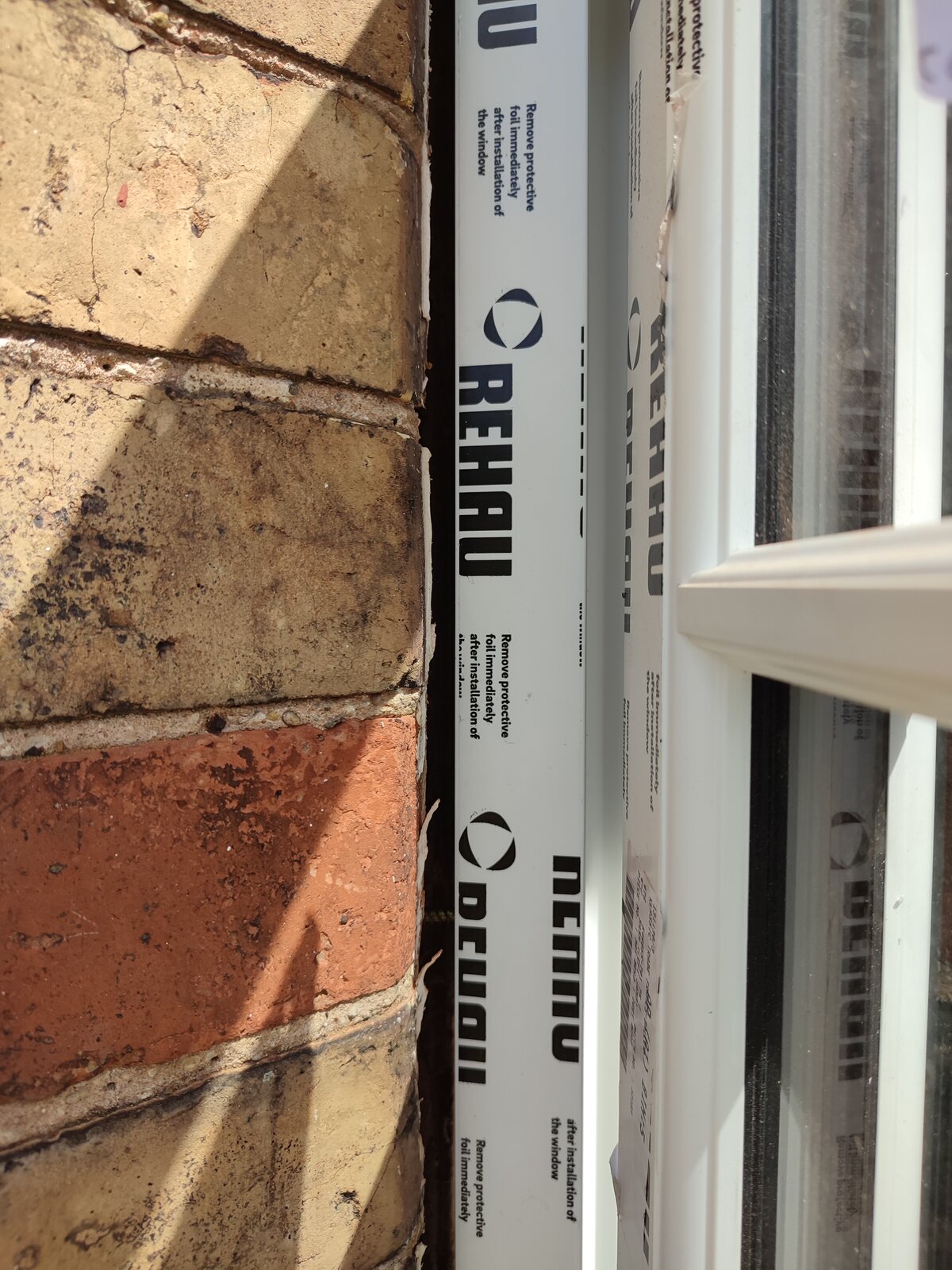

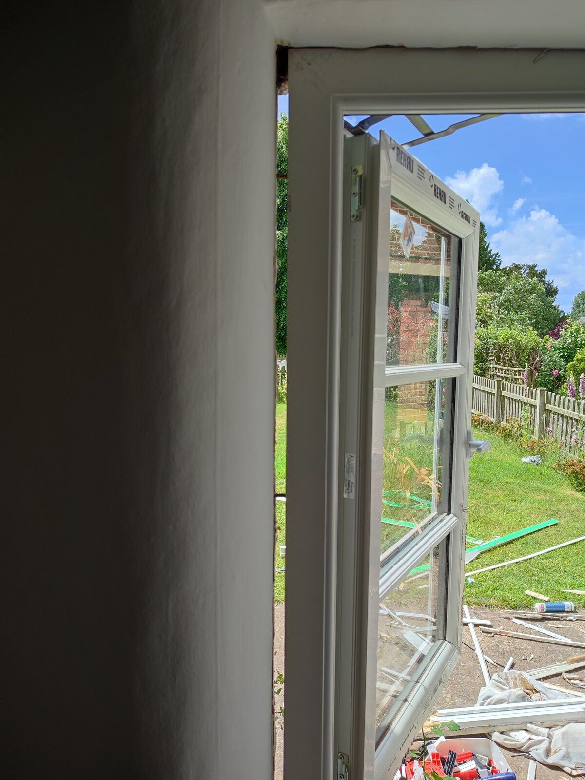

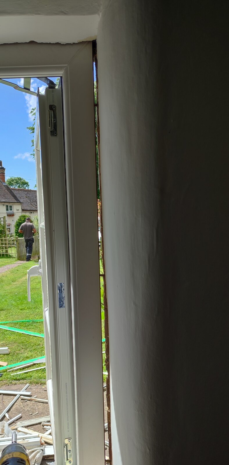

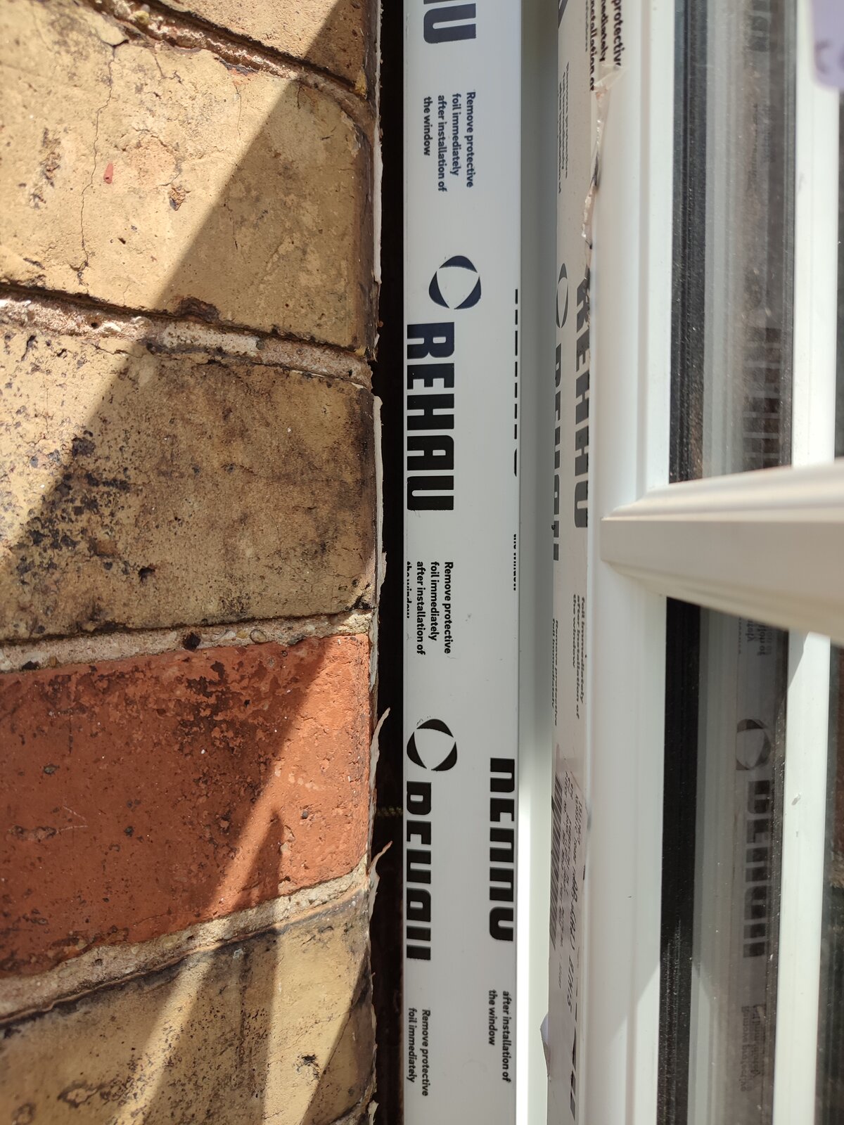

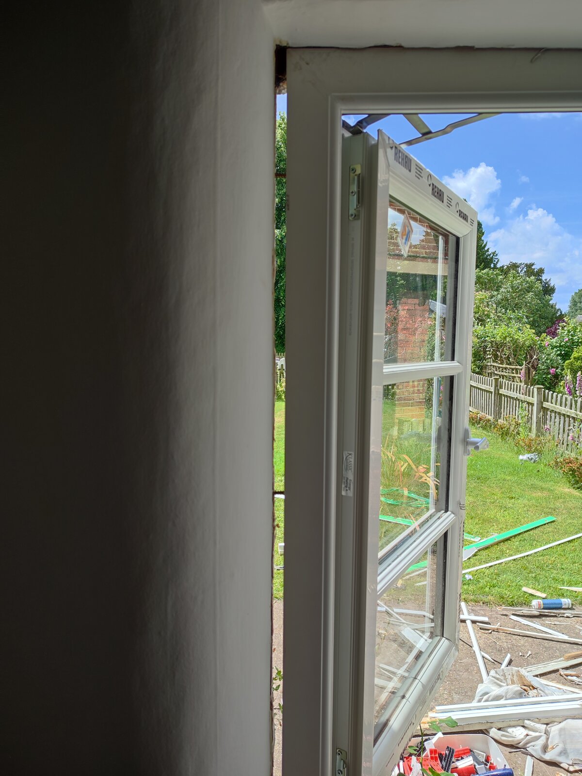

Hi all
Currently having new windows fitted and I noticed the gaps in this one look massive.
I know absolutely nothing about window fitting so I don't know if I'm talking rubbish. I know the gaps get filled and sealed then trimmed off but surely this isn't good?
The guy who measured up did seem to do it a bit quickly I thought.
Also it's a 180yr old house so I understand there has to be tolerances considered.
One of the fitters agreed that it's probably ideally about 30-40mm too narrow but that he'd finish it nicely and it'd be all sealed and secure etc and ultimately it makes no difference (they don't seem like they're BSing I don't think) . He also recommended that if I'm concerned I raise it with the company and see about getting a discount as they'd be unlikely to replace it due to cost to them (it's a triple window in the living room).
What do you think? Am I alright here given it's an old wonky cottage or should I complain? The company in question has near flawless reviews on Google.
Cheers

I'm a diy'er not an expert, however to me the gaps appear on the large side. I'm not sure if this applies to all installations, however the advice is usually measure at 3 points across the horizontal and vertical, take the smallest of each measurement, deduct 10mm and that's your size. The fact the fitter is sort of agreeing with you is also telling i.e. it's not just your imagination.

The window is a mismeasure.
It looks like the windows sit behind the outer skin of brickwork not in between - in which case ideally the window should have been wider than the brickwork and in inner plasterwork removed to fit.
it’s possible the new window was measured small enough to be fitted through the external brick opening, but the original was fitted from inside and plastered after. If that’s the case, you should have the options explained to you at time of survey: I used to do just that, ie: “would you like the new windows to fit behind the brickwork and there will an extra coat to replaster”
personally I think the result won’t look right in a period house, there will be too much frame visible, so won’t match the sight line of the originals
I think with the check reveals they tried to be clever and measure the window so it could be shuffled in one side all the way and then shuffled back the other till its central, I also suspect there's some frame extenders lying around somewhere that they couldn't get in because they'd lose the shuffle hence the daylight gaps, a combination of a surveyor trying to be clever and fitters who aren't clever enough
