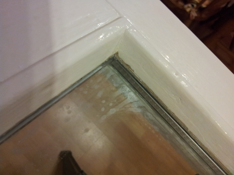

The replacement units were done more than 10 years ago. They are fine. Here's a window I am currently working on, the last one for this year. This window was done 2 years ago using ebay silicone sealant for the exterior seal. It shrank and failed. The redo should be complete in 5 days. Marks on glass are undiluted bleach. 30+ year old putty is fine. If not, makes no difference to my repair process.
Just trust me...and all the other professionals in the glass industry who have spoken on this thread... the units WILL fail at some point, we see it day in day out. 2 years old , 5 years old , 10 years old , 15 years old , 20 years old, 35 years old and any age in between...failure can be at any age , this is why the industr tend to only offer a 10 year warranty o most sealed units...as I've said before some won't even warranty if going into wood , they don't say that for fun , there is a good reason and it's the high failure rate due to things like putty and high modulus silicone . Personally we give a five year warranty into wood if we glaze it.
And really suggest you keep bleach away from sealants

People around here know me as someone who doesn't follow suggestions. I listen to what they say, though. I am trying to imbue the wood and putty with bleach. No idea if it works, but it's emotionally passivating.
If I have any failures, I will let you know. Right now, no failures. I do have a wood warped window, that's a fail but the glass units are good.
