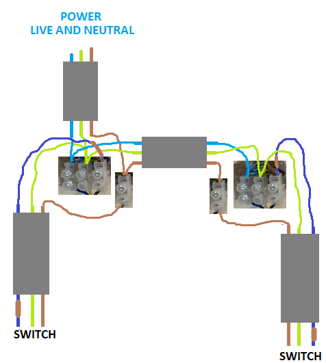

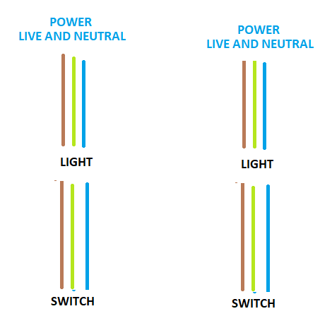

From your descriptions so far I think you have this situation:
A cable arriving at both lights with power and then a cable going to the switch below it.
Is this right?

Yes this is correct although the light on the left has x 2 of the wires you are showing as it also feeds to the light on the right.
You will need an additional terminal at each light, I show as screw terminal, wago is fine but the left will be for 3 wires.
The blue wire at each switch (I show as darker) is not neutral, it is switched live and will require brown sleeve at each end.
