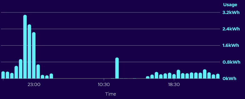

I have not got a gas smart meter, but would think it is similar to electric, so this 1770301434300.png shows me what I am using with electric if there is something similar for gas, then it should be easy to see how much any house needs if using gas, oil not so easy, I used around 1200 litres a year, well none in the summer, so that's around 12,000 kWh divided by 182 days so around 65 kWh per day, so around 12 amps average, (at 400% 3 amps) so it is clear likely for me the heat pump could produce enough. Supported by during the coldest days, the 20 kW boiler has coped.
The big difference, is the granularity of the data for gas. Electric, is able to generate regular, 10 second readings. Gas is limited to a reading every 30 minutes.
The chart I show is every 30 minutes.
