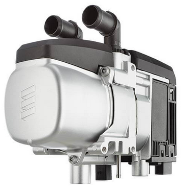

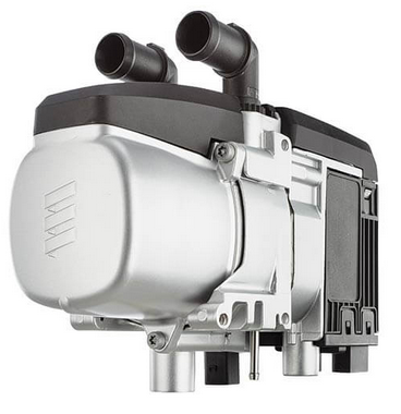

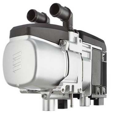

I have looked at small heaters 1767303451147.pngof 4.3 and 5.0 kW Eberspächer Hydronic S3 Economy for example, would prefer 28 sec gas oil so uses same as main boiler, but can't see how such a small cheap unit can be better than running the large expensive unit using mark/space ratio. It does not make sense. 12 volt great so main failure not a problem, OK need a 12 volt water pump, so can't see how such a cheap unit can be so good. I must be missing something.

That, is an expensive unit, designed to heat water. I was suggesting the installation of a cheaper, easily replaced unit, which simply heats the air. So cheap, it's worth getting a complete unit, as a spare. I use an 8kw one in my garage/workshop, burning Jet A1 fuel. It draws room air in via a 4" duct, then blows it back out via a second duct, heated. It has a combustion air input, and an exhaust, both of which need to be outdoors. They use a single shaft brushless motor, driving two fans, one in the combustion chamber, one blowing the heated air. As the burn process is modulated, the motor speed is programmed to match it, as is the air flow on both ends, matched to the metered fuel fed into it. Your oil boiler cannot modulate, these can, down to a low level, but they cannot so easily shut off. They have to be told to shut down, and go through a shut-down sequence, to avoid heat damage to the electronics.
Basically - They have a sealed, alloy combustion chamber, with a heat exchanger cast to the outside. Room air is drawn in, past the heat exchanger, then blown back out into the room.
The control, includes a room temperature sensor, and the unit can be set for either a constant level of heat output, or be room temperature controlled. Lots of people are making use of them, to heat RV's off grid, work spaces, and their homes, more cheaply. They have a big following.
