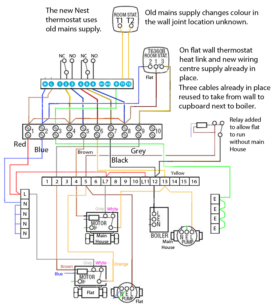

The trouble is that the only way for me to have the boiler come on is by using the Warmflow boiler thermostat (see image below). This connects to HW ON terminal 3. That is the only way to invoke the boiler as far as I can tell.
Terminal 4 (CH ON) connects to both Wilo pumps to push water out to the radiators only.
Is there a way to invoke the boiler for both HW ON and CH ON terminals using that single wire? I'm guessing not but I am no electrical engineer.

If I am reading correctly you have no room thermostat? With new gas boilers the flame height varies (modulates) so no real need for a wall thermostat, although better with one, but with the oil boiler it only switches on/off, and you need some automated method of turning it off, the thermostat you show controls the temperature of the circulating water, it does not control room temperature.
There are two ways to control room temperature, one is with a thermostatic radiator valve (TRV) the other is a wall mounted thermostat, but because the boiler only turns on/off, using a TRV on its own will not work, as the boiler will keep cycling on/off even when not needed.
So we have a whole array of wall thermostats, for the price difference a programmable one makes sense, that means rather than setting the time on the programmer so either it heats home to set temperature or does not heat home, it has maybe 5 times and each time can have a different temperature set, so say 16°C when at work and over night, and 18°C drawing the day and 20°C in the evening. But although a hard wired one costs around £35, once you go wireless the cheaper ones tend not to fail safe.
So likely your best option is the likes of Hive, not a good thermostat, but likely good enough. But google programmable wireless thermostat and there are loads to select from, so to help you further what we need to know is a little about your families life style, including what you would like the control to do.
Eric you need to have a control interlock, to prevent boiler cycling. That may mean a wall thermostat, pipe stat or whatever. I know with some modern controls it may be a bit meaningless. A boiler can modulate down quite low on its boiler controls, but a small level of boiler cycling may occur. Some boilers have anti-cycle parameters to reduce all this effect. But you still need the interlock.
@hard-work yes I know it still needs some method in the warmer weather to turn off a modulating boiler, but with anti-cycle software this could be human, turning it off with a switch.
But the boiler shown I do not think will modulate and unlikely to have any anti-cycle software, so unless he either only uses it until fires are lit, it will need some method to control the output, he has shown no wall thermostat or TRV, seems only control is temperature of circulating water.
